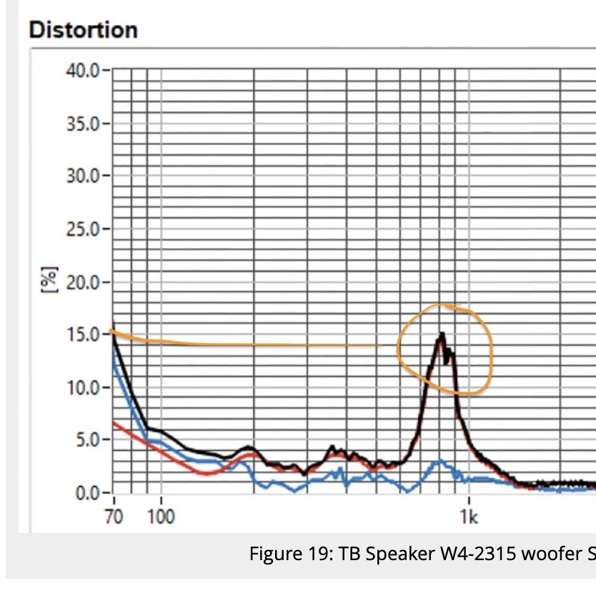

Well, since when are
Impedance blips like:
WF like Island after a volcano erruption
3-4% distortion in tweeters
not to mention 15% in the most critical band for the woofer (changing the scale an attempt to hide the result?? - good advertiser?)
and 4 dB unit difference over q quite wide region

@TNT
It's not totally fair, because that distortion is at a whopping 94dB.
Poor little 4 inch coax (effective Sd less than 4 inch). 🙁
It's a mistake from the tester to measure these small drivers at such high SPL.
They have done it before with like 2 or 3 inch drivers as well.
Nuts.
Although the tweeter should still be fine.
I agree with you.
You missed something else that is important, the BL and Kms graphs that are both highly asymmetrical.
These asymmetries happen with poor production and assembly.
Which shows bad engineering as well.
I completely agree with you that these conclusions shouldn't be in that test.
The data is not in line with the conclusions at all.
So yes. There's a lot wrong with this article.

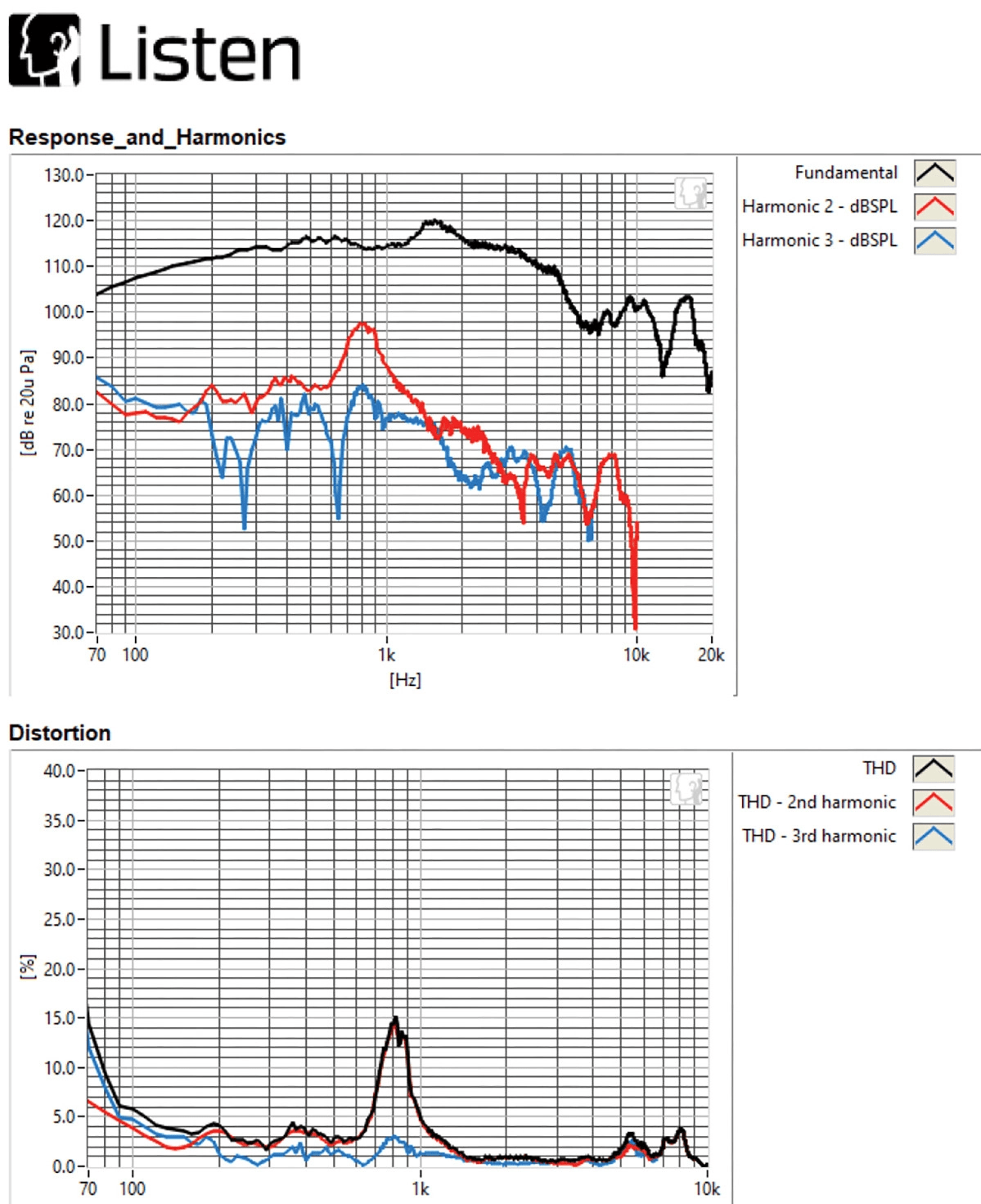

That coax is very NOT good.
I'm with @TNT and @b_force
Many of us have been skipping the verbal text, and just looking at the graphs. But after awhile noticed that there is lot of distortion that isn't consistent with other measurements. Then we go back and read the text...
well the electret condenser mic own slipping point is 126dB
But then the mic is exposed (measures) excess of 120dB..
@jan.didden
Do you have a direct line to Vance?
Vance is using the 1/4" constant current powered GRAS 46BE microphone for frequency response measurements.
Why not use it for distortion measurements? It's 3% distortion point is 160dB (and thus 150dB for 1%).
Conversely, at given given SPL, it's own self distortion is at least 24dB lower (an order of magnitude) than the electret condenser mic...

I start to see a systematic error in the used measurement system - it seem to be at 1kHz. I think that it needs a review - yes.

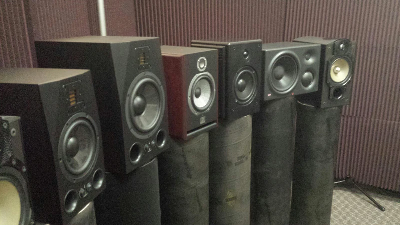

A pic from Benchmark of their listening room speakers:
Pic from https://benchmarkmedia.com/blogs/application_notes ...about half way down the page.
"Benchmark's listening room is equipped with a variety of signal sources, amplifiers and loudspeakers, including the selection of nearfield monitors shown in the photo. It is also equipped with ABX switch boxes that can be used to switch sources while the music is playing."
Does anyone else besides me see what is terribly wrong here?
Maybe that's why DAC-3 sound stage is narrow and forward. IME forward is not good; its suggestive of some type of random-noise jitter issue (a type of jitter which doesn't show up well on typical J-Test measurements). Not surprising if they couldn't hear the effect if all those passive dampers are interacting with the each other and with the actively driven speakers.
Yes. The speakers are packed up against one another and can therefore not provide in-room performance as "designed" (which they probably aren't anyway). Also it's Benchmark - a brand pushing $150 DACs at $3000 via the bogus talkers of audiofool magazines.Does anyone else besides me see what is terribly wrong here?
