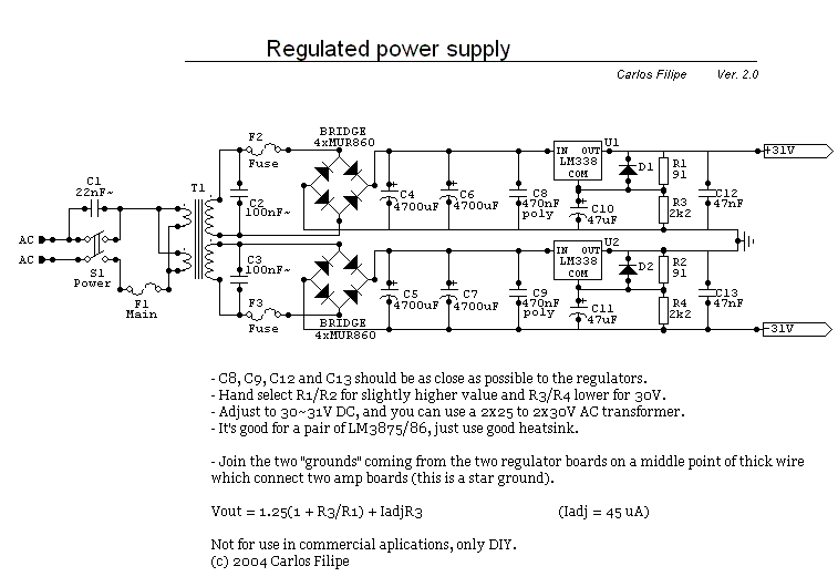

I will building a regulated PSU for my gainclones.
Is it ok to use caps with higher voltage rating than the rail voltage?
Example: If the rail voltage coming out of the rectifier bridges is + - 28V, can i use 10,000Mfd 80V caps for the regulator circuit, instead of 30V rated caps?

Two issues. Some fussy people think that elcos sound best operated around 65-80% of rated voltage and after extended use at 28v your caps may not be very safe for use at 80v.
If they are just industial types the sound quality issue may be irrelevant and if you don't foresee use at higher voltages they'll be very reliable at 28v.
I understood that the voltage rating of a capacitor should be 125% of the voltage that it will 'see' across it's terminals.
So, with 28 volt rails that would require caps rated at 35 volts or higher.
I wasn't aware that using caps rated higher than that would cause a problem, other than that they may be physically too large, or much more expensive.
Are you saying that there is no problem using 80 volt rated caps with 28 volt rails providing that they are not re-used at higher voltages in another circuit.

Thank you NUUK.
I am actually using the regulated circuit in your pages as a guide.
Believe is or not, i can get surplus 10,000Mfd 80V Nichicon caps for $3.95, versus Panasonic P10081-ND 50V 10000µF caps for $18.15, which is why i was wondering.
They are certainly worth a try at that price! 😉

yuri777 said:Believe is or not, i can get surplus 10,000Mfd 80V Nichicon caps for $3.95, versus Panasonic P10081-ND 50V 10000µF caps for $18.15, which is why i was wondering.
Nichicon caps are quite good, and that's a fantastic price.😱
