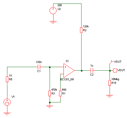

A first, it would be nice if you explained what kind of tube it was on your picture, and in which regime. Looks like something starving if it was a real tube, or some lousy model. In both cases. I saw recently Lineup's sim with zero THD. It's even not funny.
Here the schematic.
The tube is not really pushed hard , and the model
seems to be well correlated to real life behaviour
of the said device..
The right way to go.

Lousy model of lousy tube on less than 1 mA idle current loaded on 120K, not on 10 MOhm as you wrote. Plus, 680 Ohm in cathode is really a feedback by current that makes spectrum of distortions wider. This tube was cheap and popular for guitar amps. Now it is expensive, because of demand of guitar players. I don't like it.
Try trioded 6J5P like I posted above, with LED in cathode, and gyrator in anode as shown. You can use 6AC7 model, but I doubt it is close to a real tube.
What is most significant in triode SE stages, distortions are of very low order, and go down and only down with lower signal levels. And tubes unlike SS devices don't care which frequency how to distort. Yes, Miller capacitances reflect amplification coefficient changes, but they are not so horribly variable like in real FETs.
However, tubes don't have such transconductances like FETs. SiC JFETs are nice devices for output stages, but I still would not use them in common source mode, if to speak about High-End.
Will do a few sims to check the tube you re quoting..
As for degeneration in the test schematic, well, degeneration
extend the THD spectrum but reduce its total value,
so it s a double hedged sword wether you use it or not.
The beauty of SS devices is that what is lost using
reduced degeneration is more than balanced thanks
to the higher available global NFB, while with tubes
there s nothing like this , at least not as efficiently
and as easy to implement, so degeneration is a must do...

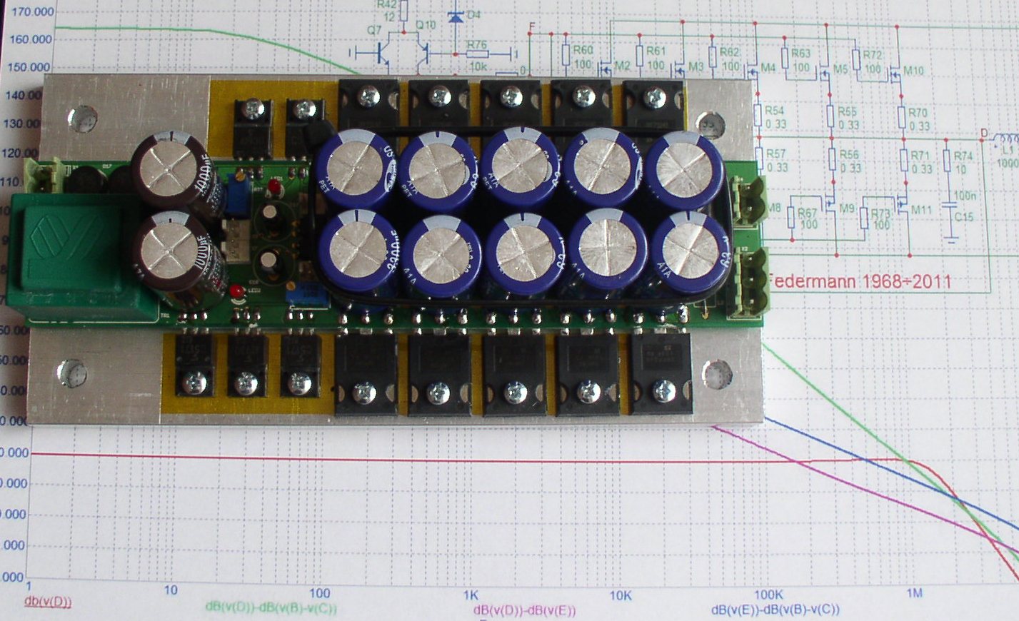

My best amp. Mosfet amp, 5 pairs IRFP240/9240
The power 10x3.3mF/63V
