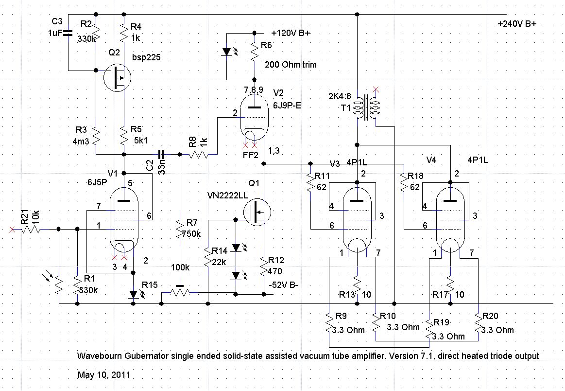

Hi Wahab;
what can you say about this single ended class A topology?
Yes , wavebourn... a tube amp with solid state current sources 😉 .

Hi Wahab;
Hi Wavebourn,
Cant say that tubes amps are my cup of tea, be it SET ones...😉
Though, on the technical side of the matter, whatever the merits
of your approach , it s surely not possible to have better perfs
from cascaded stages if no feedback is applied , wich is of course
quite problematic with tube amps.
Thus, any arrangement will be stuck with very low perfs, moreover
if output transformers are used, wich is mandatory when speakers
are to be the final load..

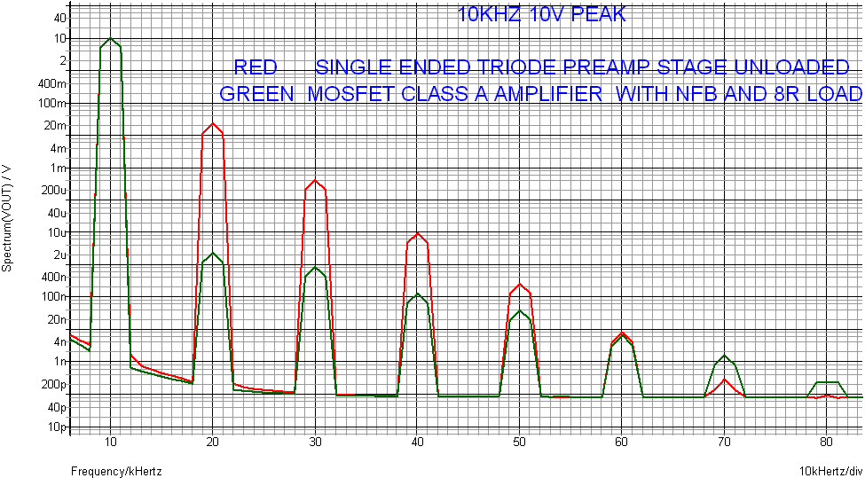

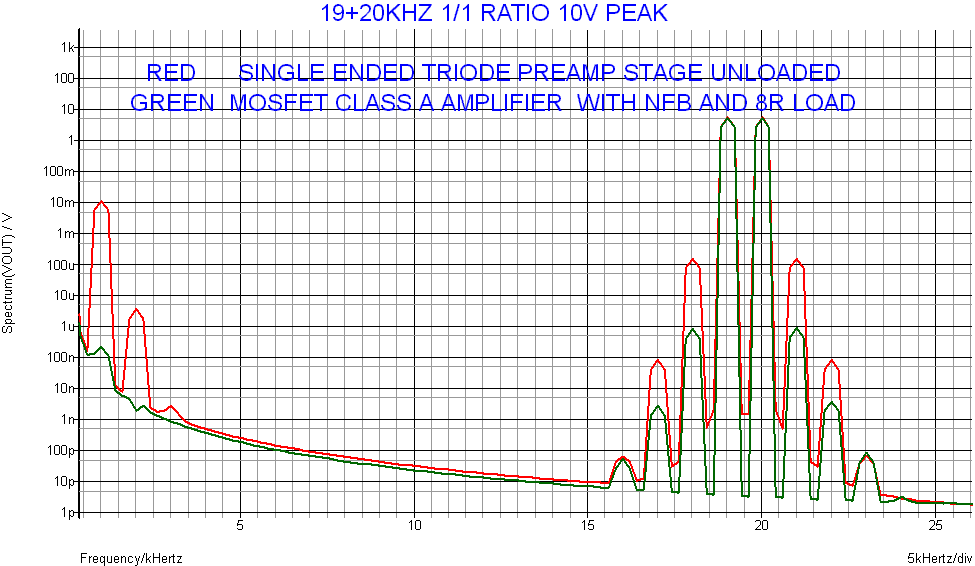

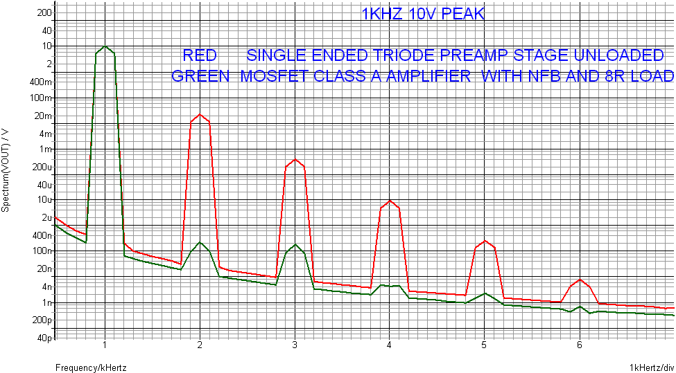

As an axemple, here some graphs comparing a single stage triode
with an output signal of 10V peak , loaded with 10MR, so quite
less demanding that any usual load, not counting the very low amplitude.
As a comparison, a relatively good low power class A mosfet amp
with a 8R load.
You ll surely agree that a single stage SET unloaded will undoubtly
display better perfs that several devices in serial, yet, the single
stage display basic perfs that are awfull for who is in search of even
a minimal but acceptable fidelity...

How would you know if you did not try this cup of tea?
Your pictures are completely irrelevant to mine.
Well, it would be nice if you could post some sims , or better,
some measurements of your two versions of your amp ,
just to allow us to have a precise idea of their capabilities..
At the risk of being contradictory, i prefer (good and percolated) coffees..😉
