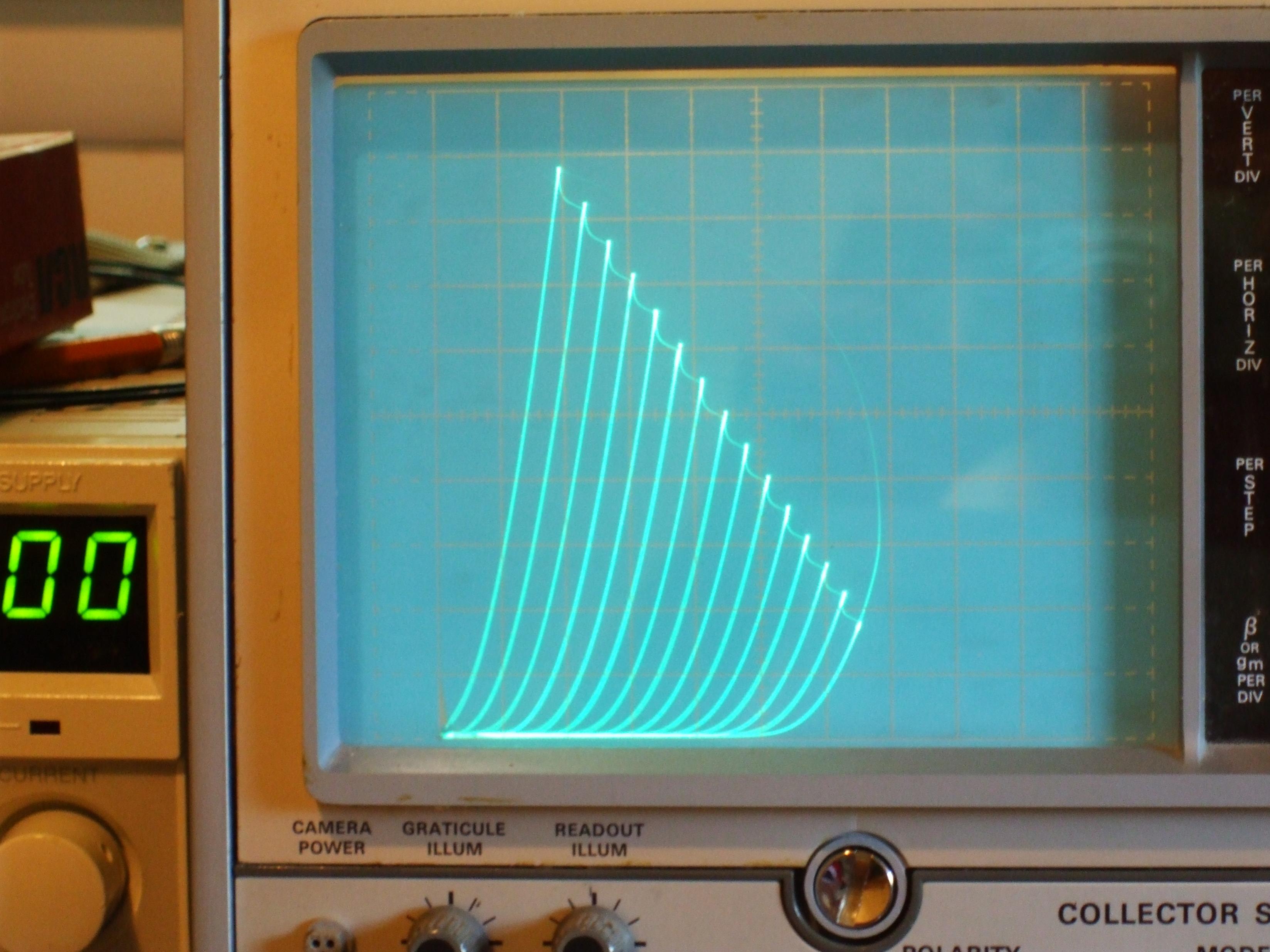

Correction to my earlier post (#22).

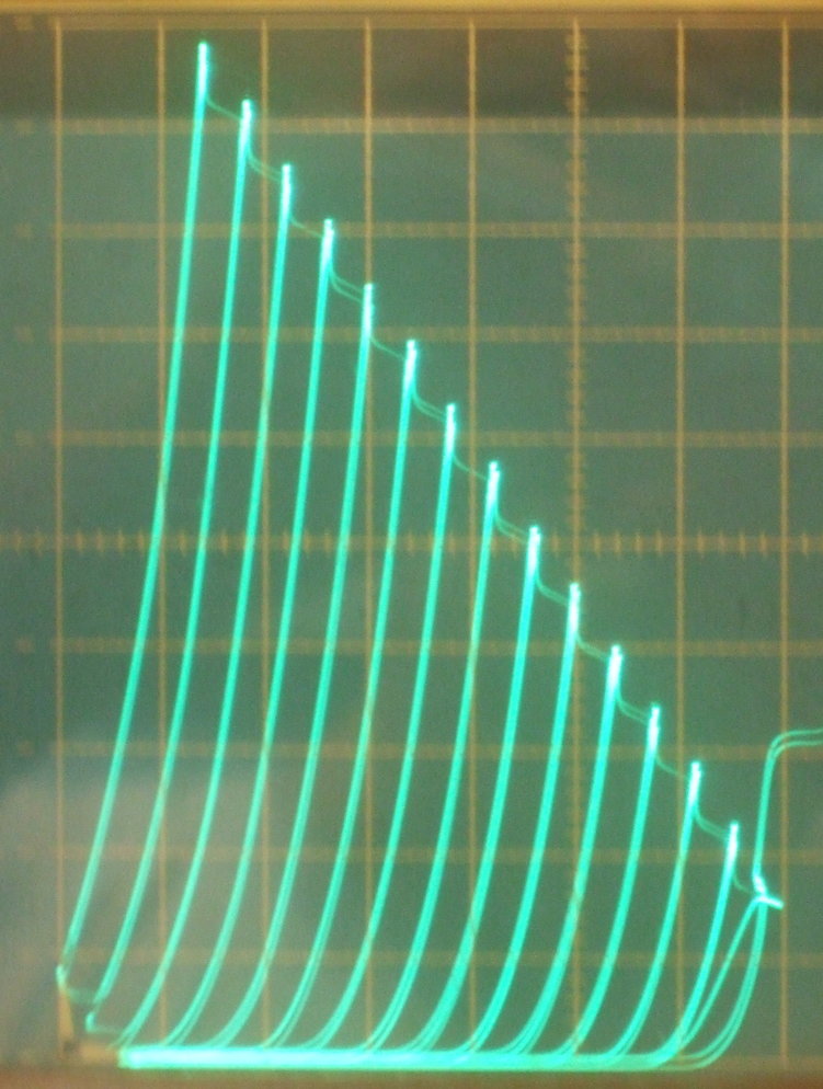

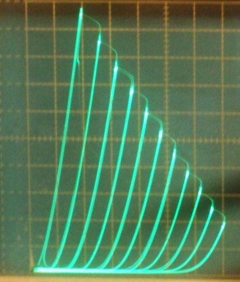

Checking the datasheet for the JJ 2A3-40, the Watts rating is increased, but the current rating is NOT! So the 2A3-40 version will NOT allow one to use a lower primary Z OT. Bummer.
I was thinking I could use my Hammond 1640 SE OT (1250 Ohms) long sitting on the shelf here, but it would still need a parallel set of tubes.
So I will do a 36LW6 "new" series Schade (UnSet, CED - Tubelab) "triode" setup to use it, with a 2nd Harmonic adjust to "fit" the 2A3 curves instead.
So it will be continuously adjustable thru the 3 example curve sets below.
