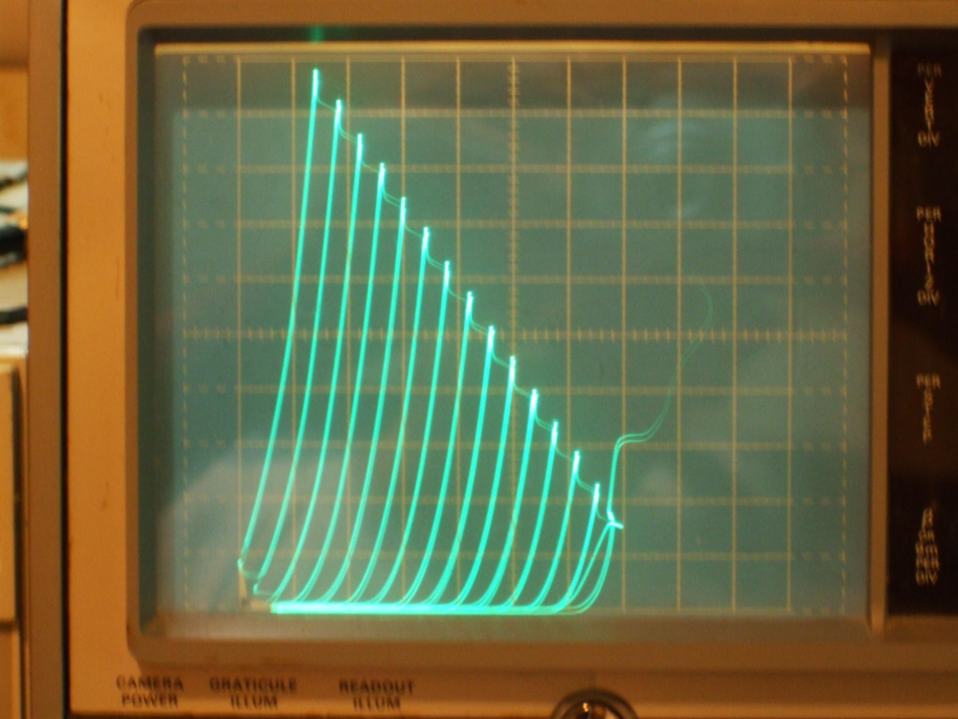

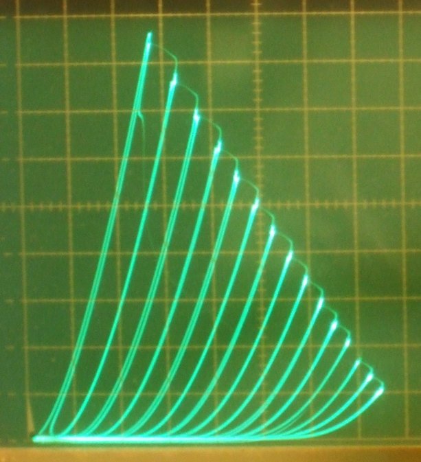

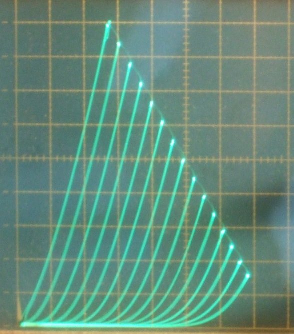

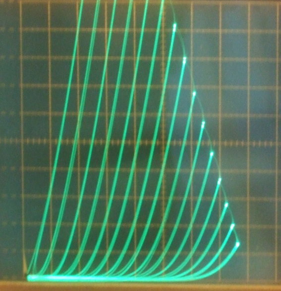

Need Bass? Get a bigger triode:
And use a P-P OT with a current source on one side for DC balance if you still want SET mode. (no air gap to get in the way, and way reduced OT magnetizing current.) Use an UnSet drive scheme to get quality triode curves. (the regulator type tubes generally have poor triode curves without the fix, high 2nd harmonic.)
