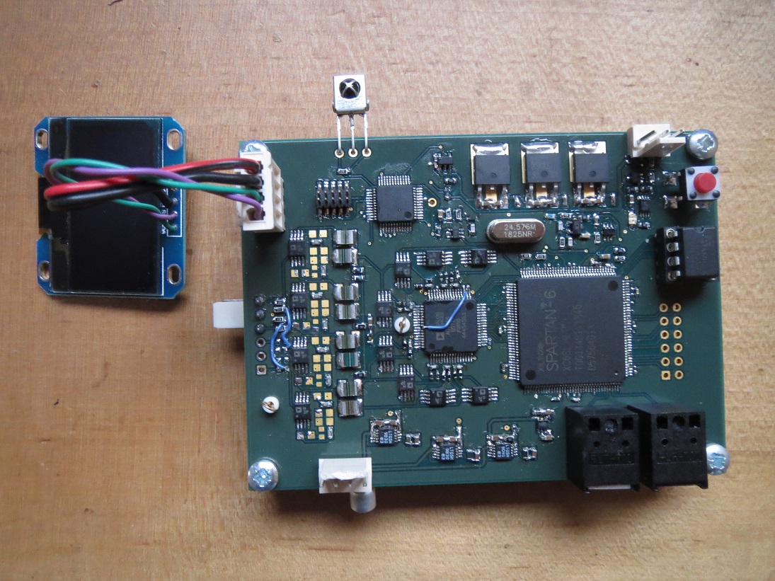

It's better to have more than 126dBSNR ADC to measure recent DAC(AK4499), which already has achieved 120dBSNR. AD7768, which has 126.93dB(the 1st pic.), is one solution. But power quality(battery) and excellent isolation(optical interface) are mandatory even if your ADC chip is perfect. I have no experience with 24bit/192kHz, though AD7768 is free from noise increase at HF. Without an optical one, it would be difficult to have more than 126dBSNR.
As to THD, I'm not sure I can have more than 120dBTHD because my oscillator isn't guaranteed such a number. ADC for THD isn't the same setup as one for SNR. Eight ADCs version doesn't result in excellent THD. Two is better than eight in my PCB. The attached is the best performance. I don't think this is a true performance of AD7768 because there is a chance that DAC distortion cancels AD7768 one. Anyway, you need two PCBs: one for SNR, the other for THD.

I am getting the shivers looking at the SMD PCB alone [see post 3]. How can any hobbyist solder something like that, is beyond me, and I have been soldering since my late adolescence.
They are easy enough to solder 🙂
The QFN package isn't the most DIY friendly. Still, at about $7 it hurts less to kill one soldering than if it were a $30 chip.
They aren't standard QFNs, at least the 5578 isn't. They've got little notches/chunks at the pins rather than the standard flat face of most QFNs. This makes them a lot easier/quicker to solder than regular ones.
