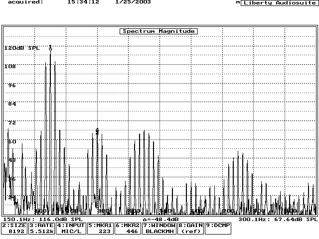

I have attached a IMD measurement I made of my CSX 8" driver, adjusted for 96dB output, at one meter. I hope all of you find it interesting....
Scott
