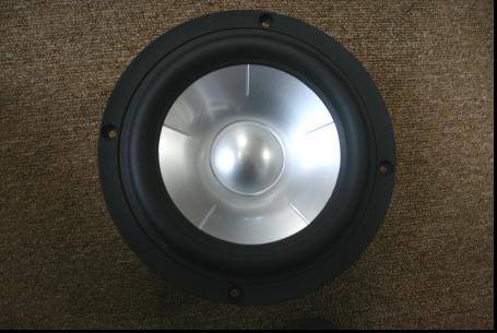

Well Peerless/vifa drivers do seem to offer excellent value, sound quality and are strong / robust.
The HDS 6.5" Alu driver has only a slightly heavier moving mass than the Nomex version

The Nomex material seems to offer the benefits of paper cones (less severe break up and high sensitivity) without the 'paper' sound, would that be right?

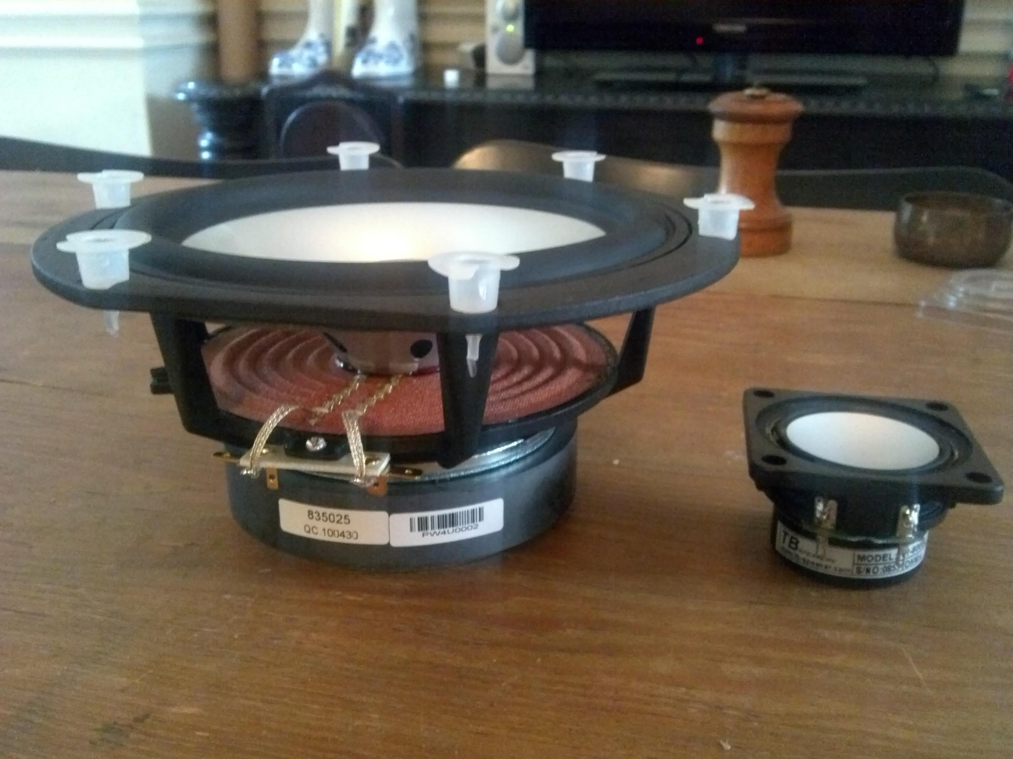

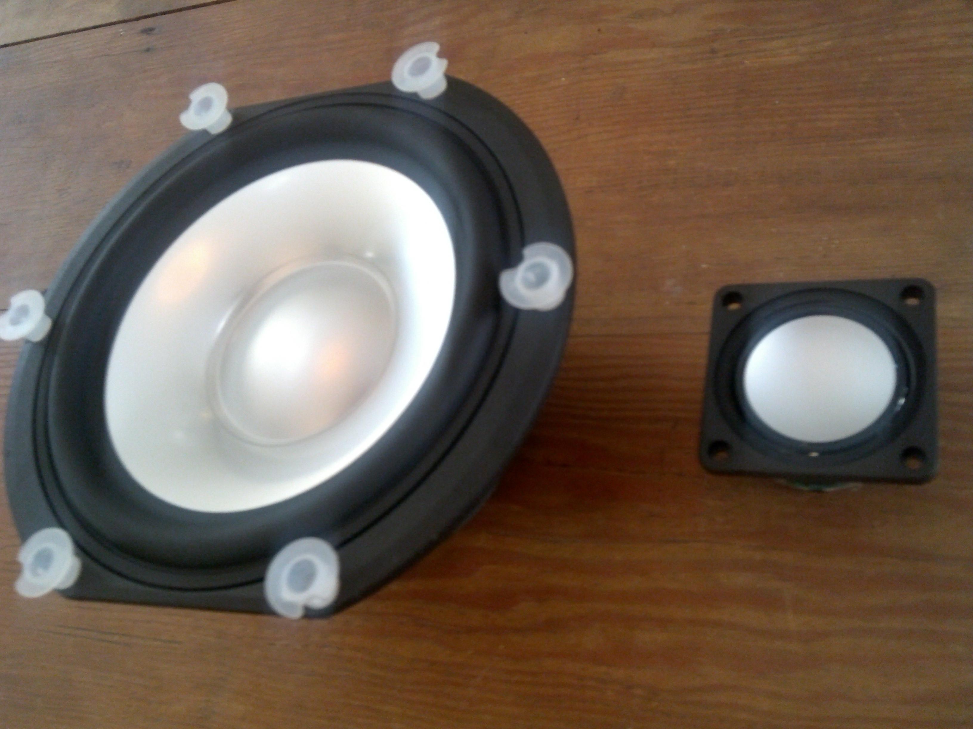

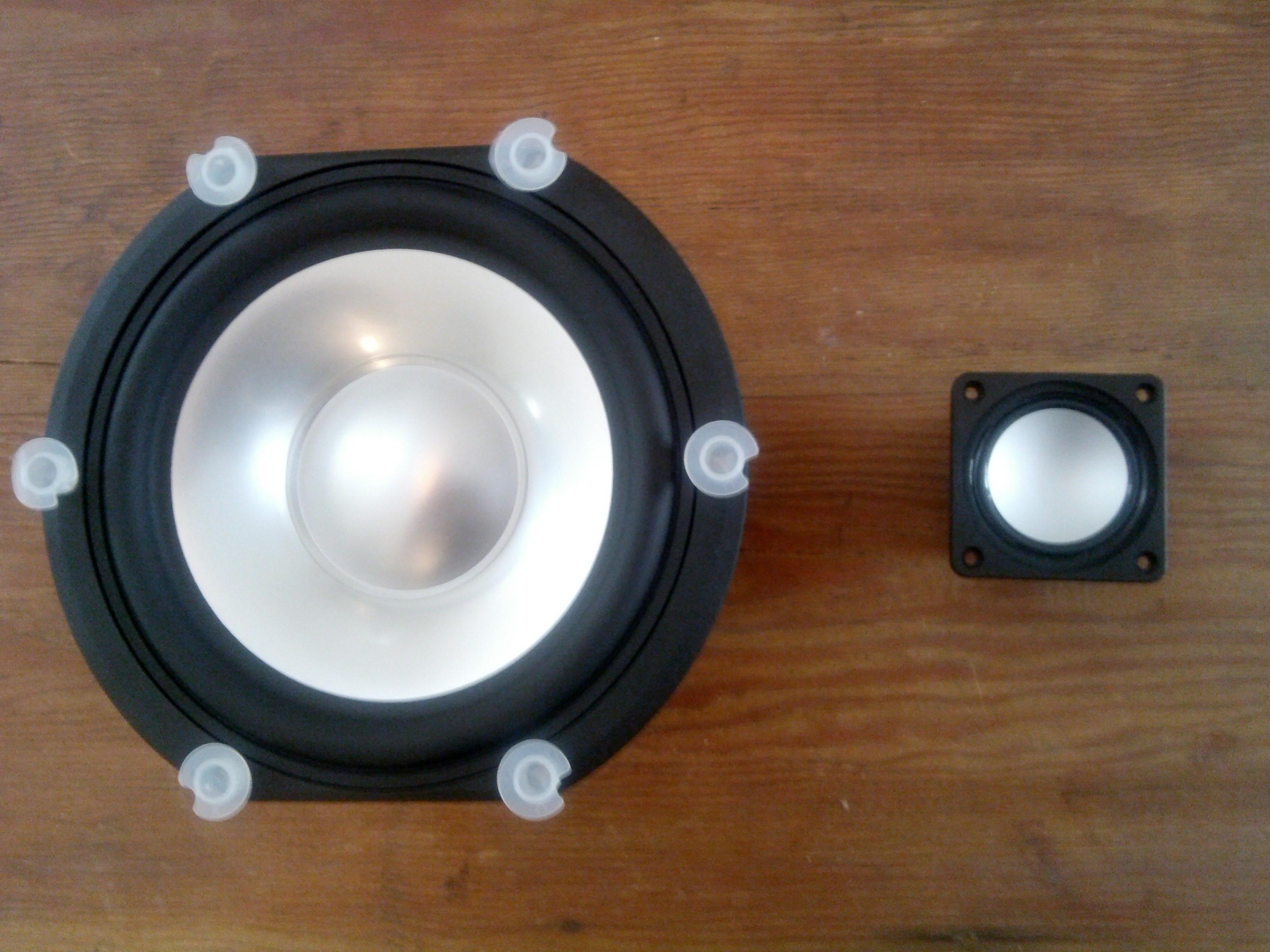

just to say that I shd have my delivery of Peerless 835025 HDS-164 AL MidWoofer's in the next couple of days, I'll upload some pics when they arrive
Bill, I have that Peerless too, very well built speaker; leads woven into the spider etc. Had no opportunity yet to use it though, so interested in your findings if you'd like to share them..
Its a nice driver for sure, a real bargain imo. Starting the build this week (22 litre BR) still not sure on the x/o
Interesting.
I wonder what besides the cone color is different compared to the one SB sells to Harman for the Revel Performa3 line.
They are launching a metal 5 and 6" v soon. I had no idea they look to be already in a design, well spotted!
