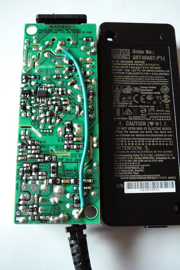

I think he means ground the SMPS's DC output to shunt AC leakage current to GND.

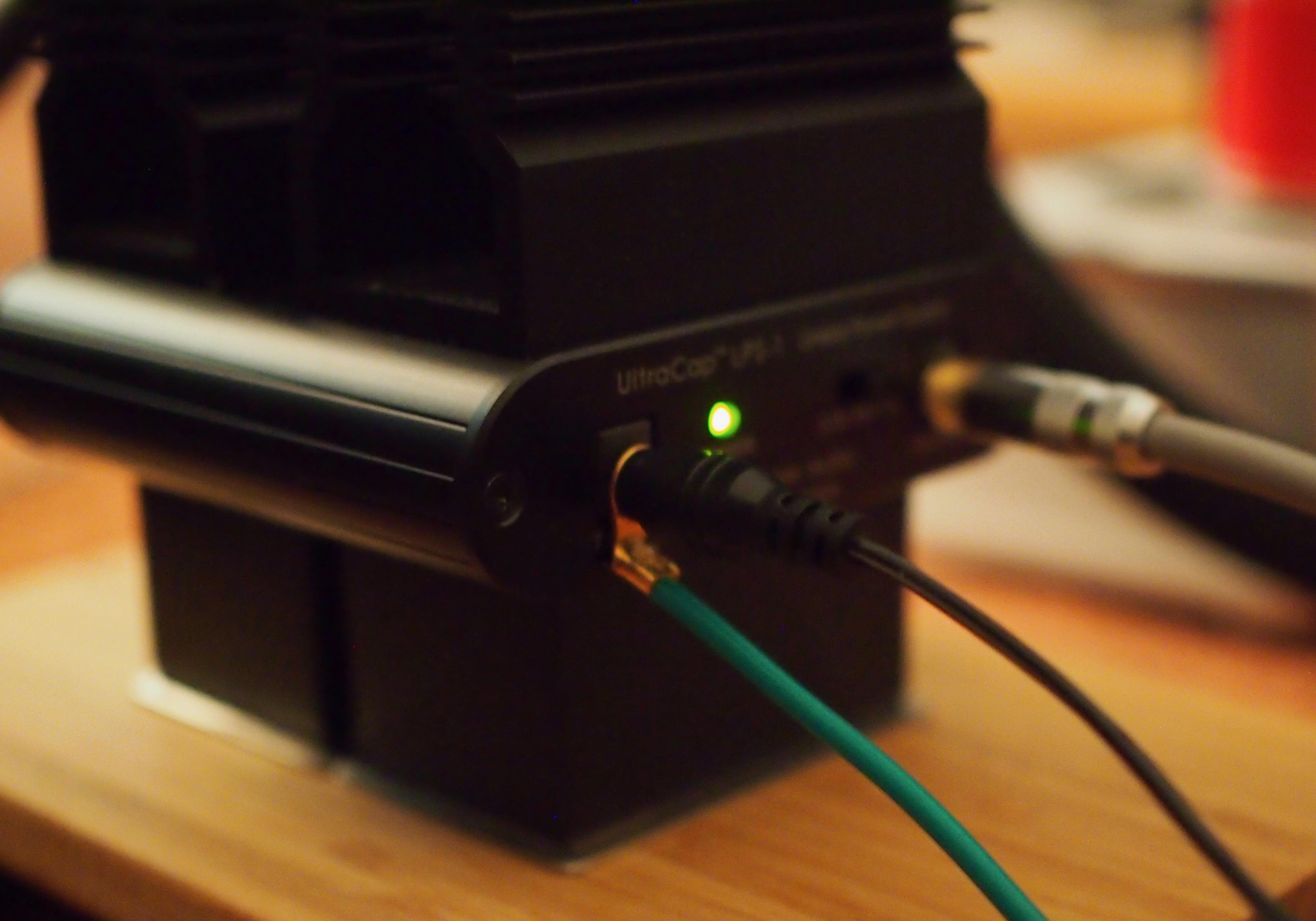

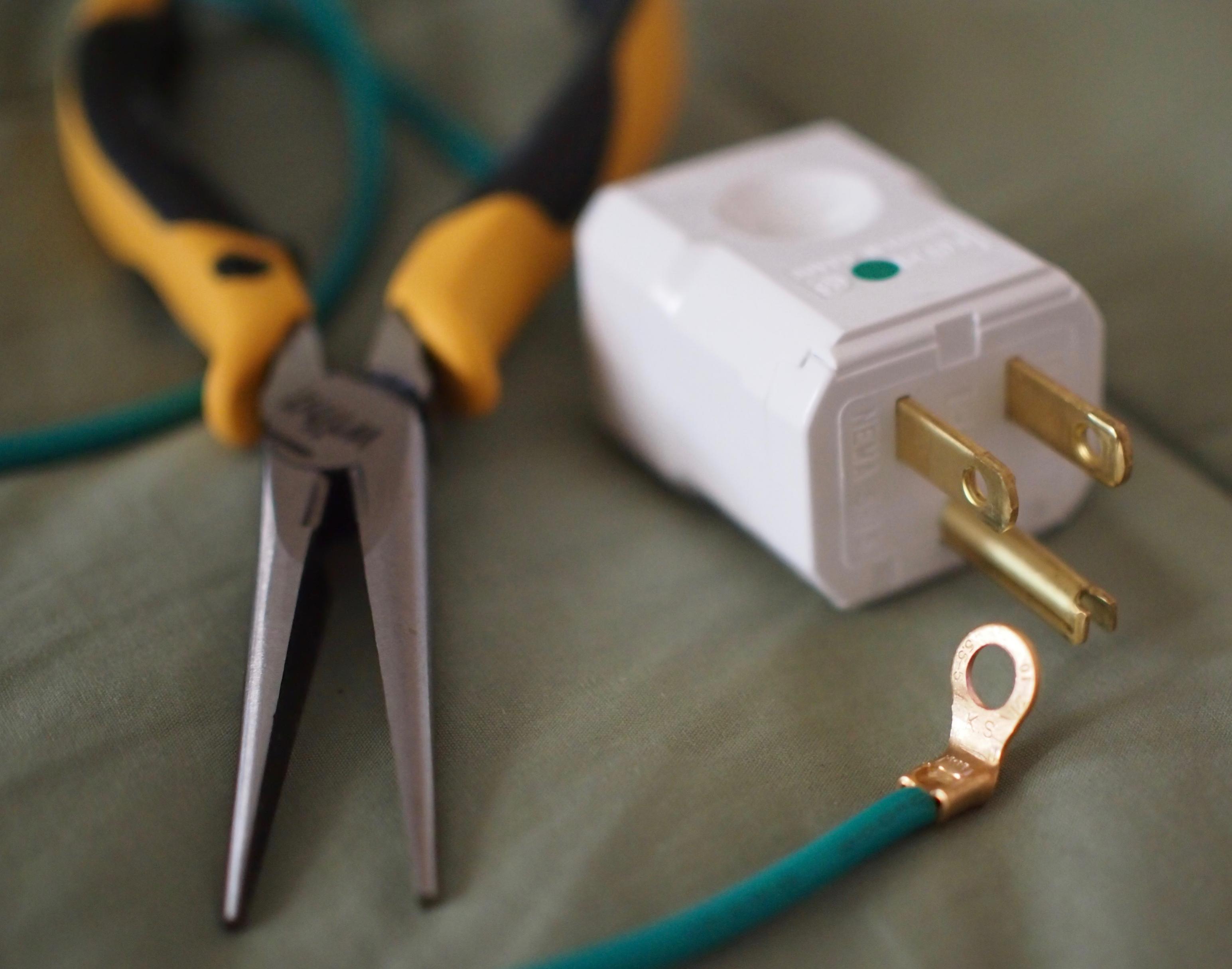

You can easily DIY that kind of cable with various parts, or for $49 there is the iFi Groundhog. The picture below is not an RPi, but the same idea, that's the DC output of a Mean Well SMPS grounded back to the AC safety GND.

Give it a try it anyway, I've found it to make a not so small improvement, even when the SMPS is just energizing the UpTone LPS-1 UltraCap supply. There's no ground loop issue there, only AC leakage current.
I'm sure everyone should be reviewing their overall grounding scheme, and yes I agree that there are probably too many instances where ground loops are occurring.
However that doesn't invalidate this approach, you should try it, it's not in any way limited to the iPower, it's cheap and easy to do, and as cdsgames said "I don't think there is one answer that fits all", he's right and trying this may just provide you with a pleasant surprise.
Some people do the Mean Well like this:

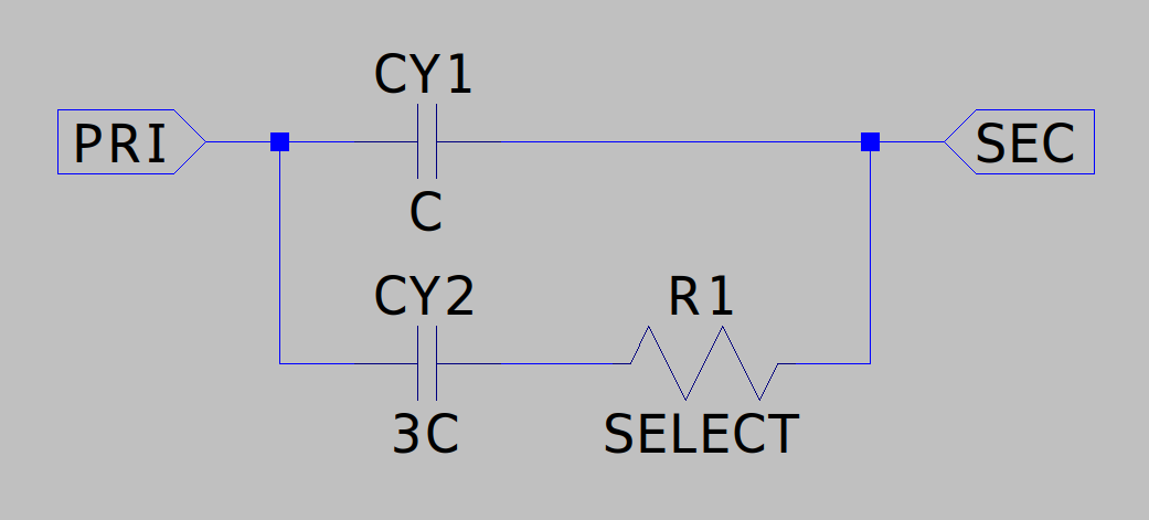

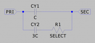

If it is of any help I seem to recall that the primary to secondary capacitors are not strictly or solely there for EMC purposes.
In the case where you are performing secondary side regulation by feeding back over the isolation boundary in order to control the primary side PWM you can experience common mode noise problems with the feedback loop.
Such behaviour is tamed by including those Class Y capacitors across the boundary. You may also notice that some circuits include additional parallel RC networks which look like pic.
These are in place to damp or otherwise tame parasitic resonances. Your wolf/lion might still become a cat and there is the possibility for DIY folks to do a 'select on test' to discover the optimal value for the resistor.
mmmm that looks like a very interesting idea. I will test it.
