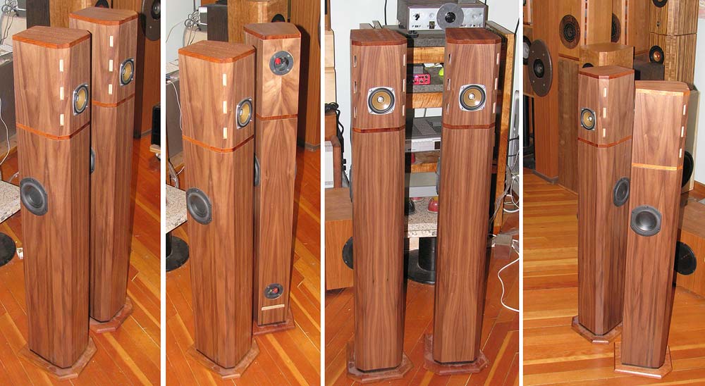

Specifically I would suggest 4" fiberglass honeycomb cone (such as Mivoc driver, or Jamo C-series passive, Eve Audio active) with automotive "plast" stretchy tape de-resonance waveguide. Unless you can find outside China 4/4.5/5.5" drum-paper FR variously labelled Hifi-bird/Michael's Audio/isred/MKHIFI which are my favorite whizzerless. Both types have extremely small Vas and deliver clean powerful bass in a compact TLonken (short tapered transmission-line into single-slot port).
https://www.diyaudio.com/community/...smallest-diy-3-ways-ive-built-or-seen.392609/

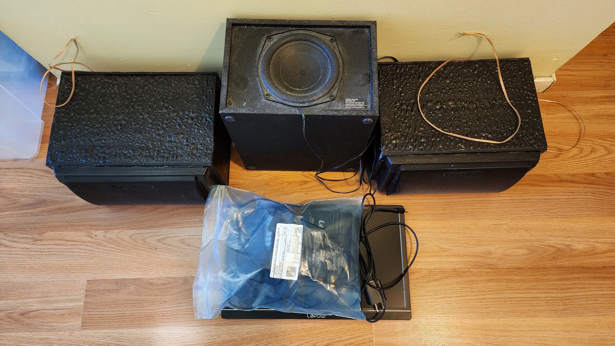

I have recently took appart my tiny audio system, consisting of two radioshack 3way speakers, good sounding small sub, no idea of make. Small classD amp, which i used with small hd monitor and my, you would not guess, yes, cell phone. This system was designed for cell phone, to provide sound and picture. Surprisingly good. If you are interested, i can investigate what that little subwoofer is. There are no marking on the outside of the box. But it provides decent bass and is quite compact. I can unscrew the woofer and see if there is anything on the magnet.looking to build super small speakers. wanted to see if any one could recommend
