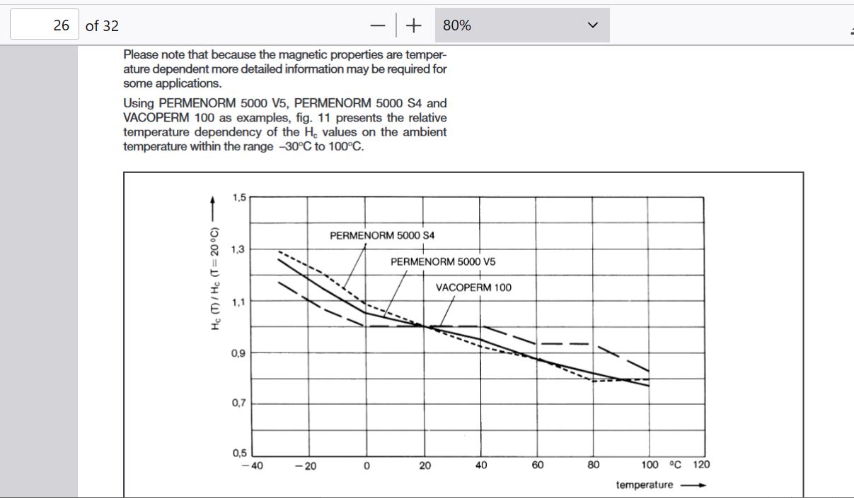

..... so I stumbled across this. Only quick scanned it, but seems to suggest (if I am reading it right?), that temperature a bit above ambient is optimum for the core. So I need to cook the core but not the winding.
See fig 11 on paper 24 or 26
https://vacuumschmelze.com/03_Documents/Brochures/PHT 001 en.pdf

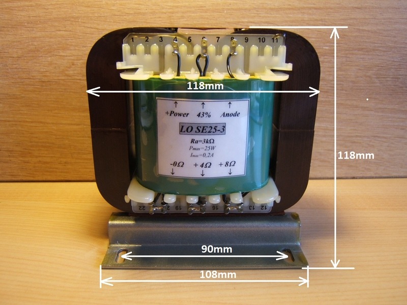

I've now put my Ogonowski SE OPTs into my 2 stage amp and the results are very good. The best acoustic piano sound I've heard yet in my system. Smooth, plenty of detail, airy high end, and beautifully built. I recommend these OPTs without hesitation. Mine was 5K and optimised for 60mA. Just the 8 ohm tap on the output, but I'm sure you could specify whatever you need. Very happy with the quality and price and I'd go straight to Ogonowski if I needed another OPT.i looked at the Ogonowski website and the cheapest SE OPT is quite reasonable, $109. Says 2.5K so I'll ask about 3.5K and 5K.
https://www.ogonowski.eu/transformers/single-ended/lo-se25-5/
Did you order the special core Grid01 was talking about?I've now put my Ogonowski SE OPTs into my 2 stage amp and the results are very good. The best acoustic piano sound I've heard yet in my system. Smooth, plenty of detail, airy high end, and beautifully built. I recommend these OPTs without hesitation. Mine was 5K and optimised for 60mA. Just the 8 ohm tap on the output, but I'm sure you could specify whatever you need. Very happy with the quality and price and I'd go straight to Ogonowski if I needed another OPT.

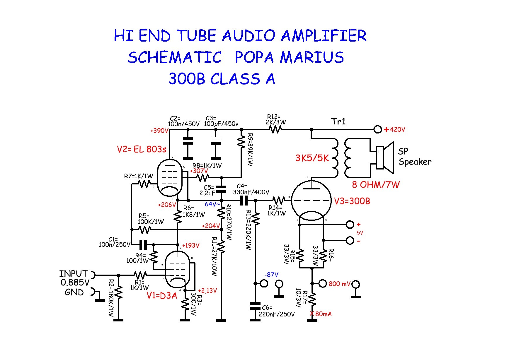

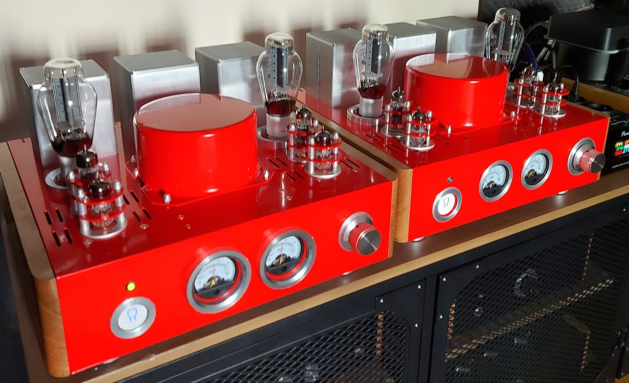

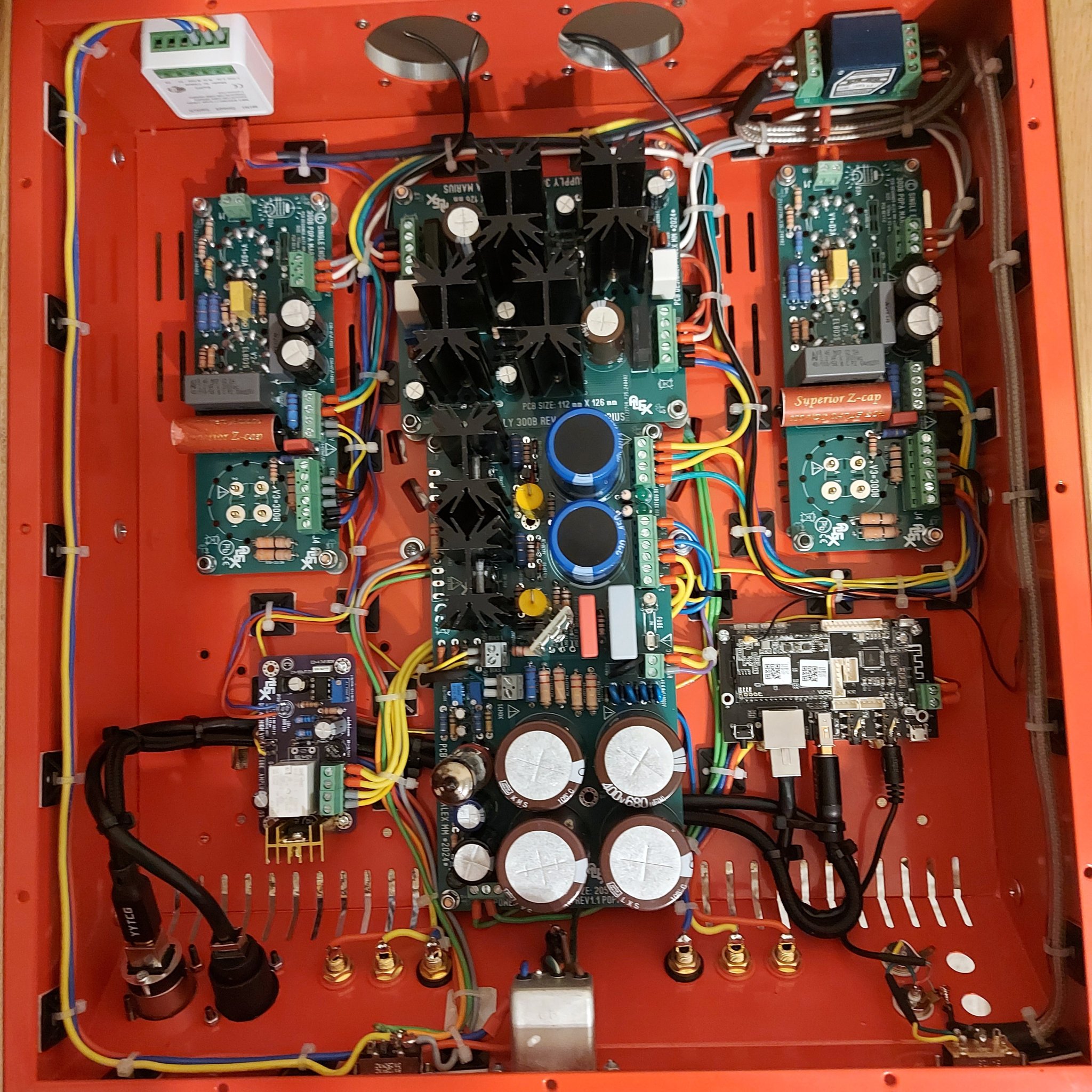

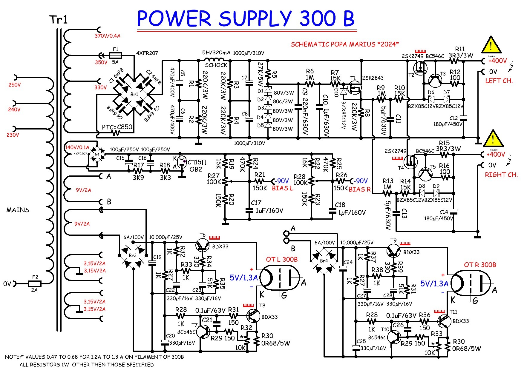

Hi, this is my SE 300B amps built this year , sounding great, not yet measured but I'm pleased how it sound. I attach scematic and picture of finished amps. Output transformers are C4 core amorphus 3,5 K /4 and 8 ohm from Aliexpres.
Really nice. The core material should be comparable to the hashimoto 0.27mm Orient Core Hi-B(1.10 W/Kg loss) and the AN high B 0.23mm. Probably the best price/tonality OPTs available.Mine are SE25-5 5k/8R on the annealed cores CC HiB, thickness of laminations is
0,23mm price 160€ x 2=320€. They look like the picture.
