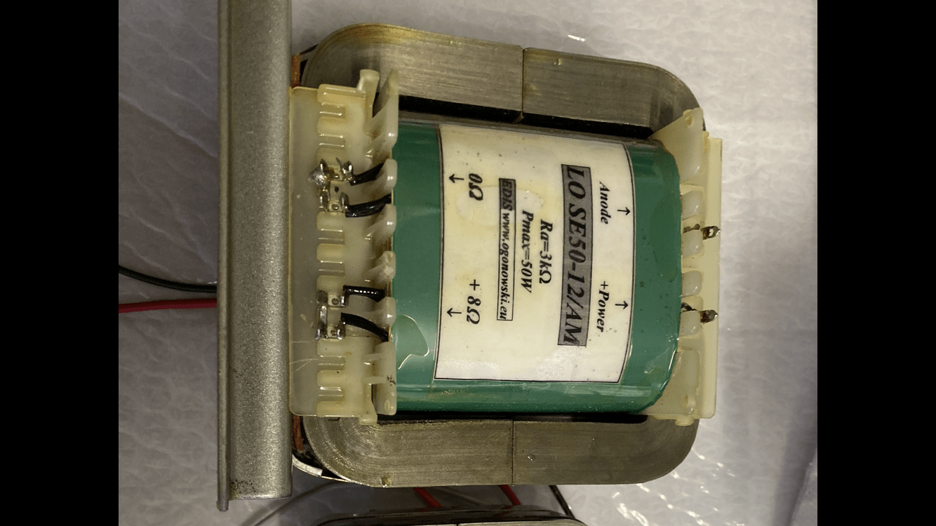

I have inclosed a picture of the large Amorphous from Edis Ongowoski , this is a very large unit as this much Amorphous is needed to get down to 20Hz at 8 -10 watts , his metal is sourced from Germany from memory not china , and comes with transformer covers , FEDEX only .
