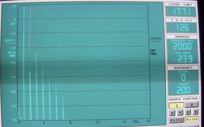

The 300B is one of the most efficient triodes for Class A1 operation. Class A2 is possible but not great. I have done it several times and the result has always been that distotion is high, whatever driver you wanna use: mosfet source follower, cathode follower or high quality interstage transformer with small power triode. The higher distortion comes from the 300B itself. Some tubes just do not like to be driven in positive grid. The results with 300B have been always the same, especially odd harmonics up to the 11th increase a lot with distortion figures that reach 10% at 10-12W output. I can get 2-3% at about 10W output in A1 with 30W dissipation.Why to use A2 where the grid current is not linear? = because it is the best approach to get the best out of the tube in terms of music and power.
Many amplifier designers make the driver stage able to do A2 to reach over 10 watts instead of heavy blocking and saturating. In the graph above the thd is below 40 db which is good considering he is at 10 watts.
The only difference is that your A2 driver stage is more complex and you have to have some sort of auto-bias monitor to maintain the bias within safe limits (not to destroy the tube).
You really need to make peace with yourself. If more than 1% is too much, how 10% can be good?

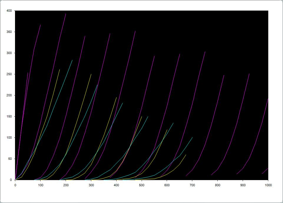

Others who? I don't believe it. In the picture below 10W (9..7W to be precise) class A1. 300B working at 420V/70mA into 4.2K. With very low distortion driver the THD of the amplifier is 3%; With modest amount of H2 cancellation distortion is 1.3%.I don't see what is different in what you are doing... with a 30W bias, I am just referring to the fact that if you drive it harder the bias point will shift from 70ma to 100ma+ and start A2 operation, a simple cathode follower can do that, the grid current is not that big. Others who implemented a grid current sink with a bias monitor obtained 12 Watts at 1%,
And no. B+ was regulated and fine. Bias steady. It's a feature of the 300B. Others tubes like 811A, 807 etc are fine when driven into positive grid.Your figures of 10% at 12 watts point to maybe the unregulated power supply which drops significantly the B+ or a lower anode voltage with higher bias, to get to my figures you need to have 450V across. There are many commercial designs like this.

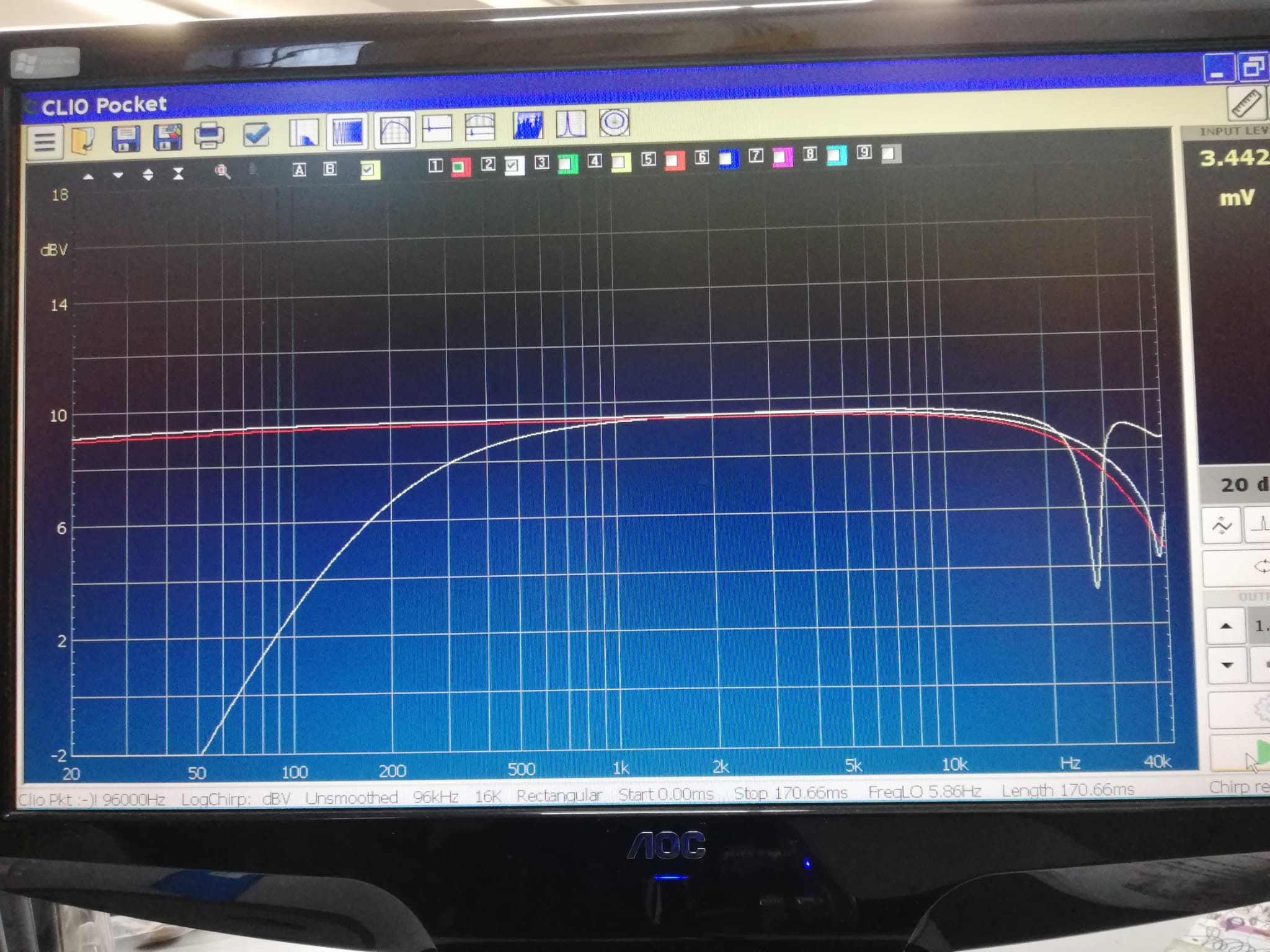

The OT was connected as normal in an amp.
This is only to show the impact of the iron on an OT.
You can do this with other thousands of OT and will find, less or more, the same thing.
And it is compliant with the graphs I sent before with the test on secondary open.

I have always been curious about LF losses without iron, nice to see your results.In attache a test done with a s.e. trafo
THe freq. response with and without iron
It is possible to see that after 1 kHz the iron desn't count nothing
If we coinsider -3dB the F is around 200 Hz
Walter
You mentioned you have this OPT in an amplifier. Have you tested distortion at eg 1kHz with and without the core? I imagine that without the core distortion will be higher, even though frequency response is flat?!
