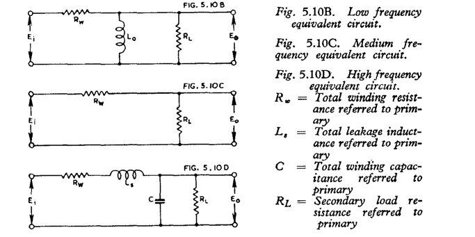

Can I ask you to please elaborate more this point? Leakage inductance rolls off highs where speaker impedance increases, so where an amp with medium-high Zout increases the output, and this flattens the frequency response (up to a point)?It's a reason I like designing my transformer with leakage inductance dominant roll-off, taking advantage of the fact most speaker impedances increase with frequency.
Yes, we get to a point where the driving stage source impedance plays its part. When you get an increasingly higher impedance with frequency, this translates to a higher primary reflected load with frequency. For a SE triode tube stage that would translate to a less steep loadline, limited power output and more second harmonic due to the loadline changing in asymmetry, more voltage being swung to the right section. As for current source stages, higher primary impedance usually gives a higher voltage gain, so that will flatten the frequency response at some point, before asymmetrical clipping occurs.

I haven't understand well the last post around the Ls (leakege inductance )
The equivalent circuit of a OT are these
the figure 5.10D is at high freq.

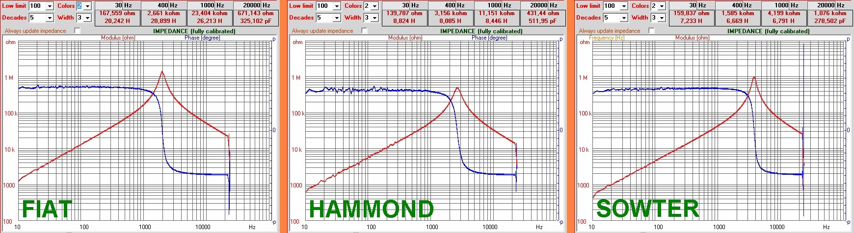

In attach a diagram, already posted some times, where there are the plot of a impedance on some OT with secondary open. All OT for s.e.
There is a peak then, with frequency increase, the Z has an andament typically capacitive ( the C on equivalent circuit), also the phase change at resonance peak.
On the three OT the main aspect we see is that the major issues are on the low frequency where the quality of iron ( and the coils) is more important.
The resonance region is almost the same even the types are much different, between 2 and 3kHz.
But the Z at 10 kHz is high for all types and where the Sowter has the highest value ( but the lowest H, strange? no!)
These test are limited in frequency due the audio card but the range is enough to understand.

@waltube, the plots you're attaching are depicting a typical unloaded transformer driven by a high impedance response, where the inherent primary inductance resonates in parallel with the shunt capacitance. This resonance Q gets flattened, hence the resonance becomes non-visible when the OPT is loaded and the driving impedance is low.
This resonance will shift dynamically in frequency and amplitude, because the primary inductance changes with core excitation level.

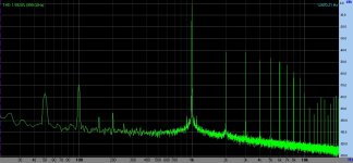

300B is not linear 6 watts at more than 1% thd is very bad and limits the amplifier to tailor-made loudspeakers. 300B is a low gain low Rp, for before feedback existed, and good transformers theory and higher voltage capacitors existed, so that it can operate with low voltages. The 845 with proper transformers is a totally different animal. A PX25 is also higher gain, and way smoother sounding. With better transformers and better technology higher gain and more linear tubes were possible to use.Normally the goal is to get the max power possible without other considerations.

You cannot reach in the linear region of the 300B without exceeding the dissipation. The proper way to use 300B is to get it to work in class A2. Same with 2A3 tubes.
Waltube is right, it is all to your advantage to use some 10db of FB with 300B, especially with a high quality OT.

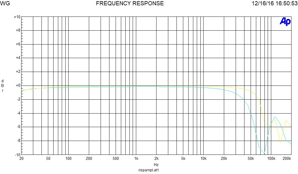

Just for info, in attach a graph with two curves.
The light blue is a normal coil, the yellow is LITZ coil, same iron, same ratio. 4 Vout on 8 ohms, ratio is around 22
Of course different Rdc , Ls and Cs
As you see in the differences are in the high frequency not in the low end ( iron involved) this due the minor parasitic capacitance mainly

Why to use A2 where the grid current is not linear?
With a tube that is linear?
Have you never seen the WE curves 300B in A2?
And the FFT that is poor as harmonics?
