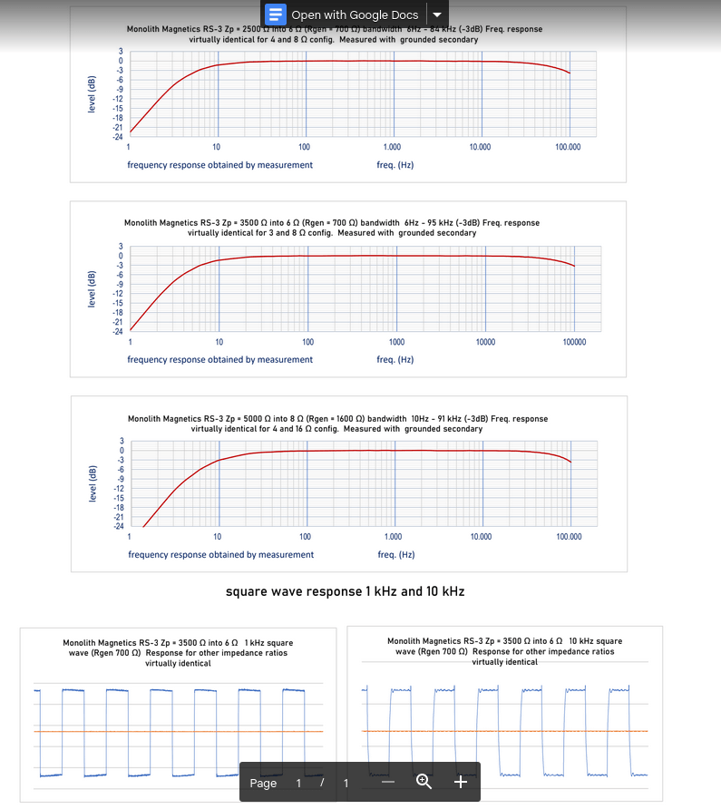

These are "abstract" graphs measured as said, with generator in addition of 700ohm resistor to emulate real tube source.
These are not real circuit measurements. As the transfer is affected by other components values like pS C @ anode, Ck bypass etc.
But they didnt said what level of signal?
And of course shoul de be measured with huge signal, because signal i amplifiwed by the tube, and at grid is alreday about 40V p-p for max power. So it should be measured with more than 200V to emulate more real opperation.
They are probably measured vith fwe volts - that is mean not much 🙁
I haven't doubt that Monolith are good stuff
But they declare the H without any specification
And the frequency response without any specification on level is not complete as data.
About the square wave that are fine but at what level?
Good for the other details

I am agree but, for me, the measurement with a linear load is the best way to understand how good is the trafo. I mean a resistor load connected to primary and secondary.
Also, in my opinion, the backward test is much better because you can get a great swing on primary that is not possible to get with a good generator
If you use the real circuit the non linear devices are involved in addition to the OT ( that it is also not linear, of course)

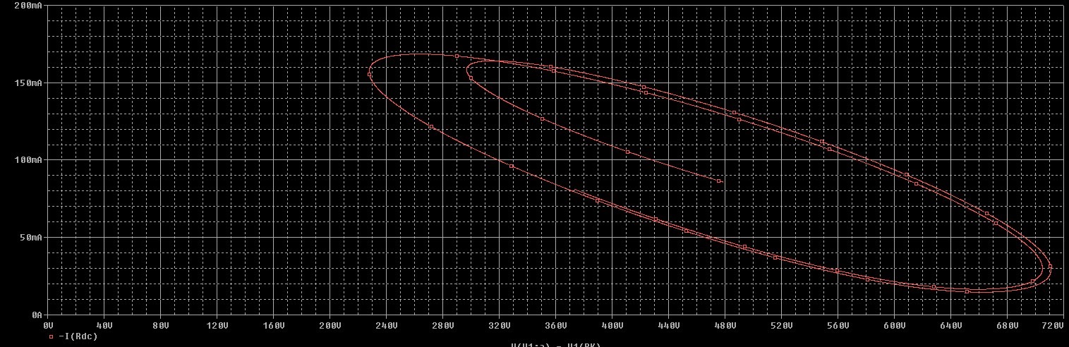

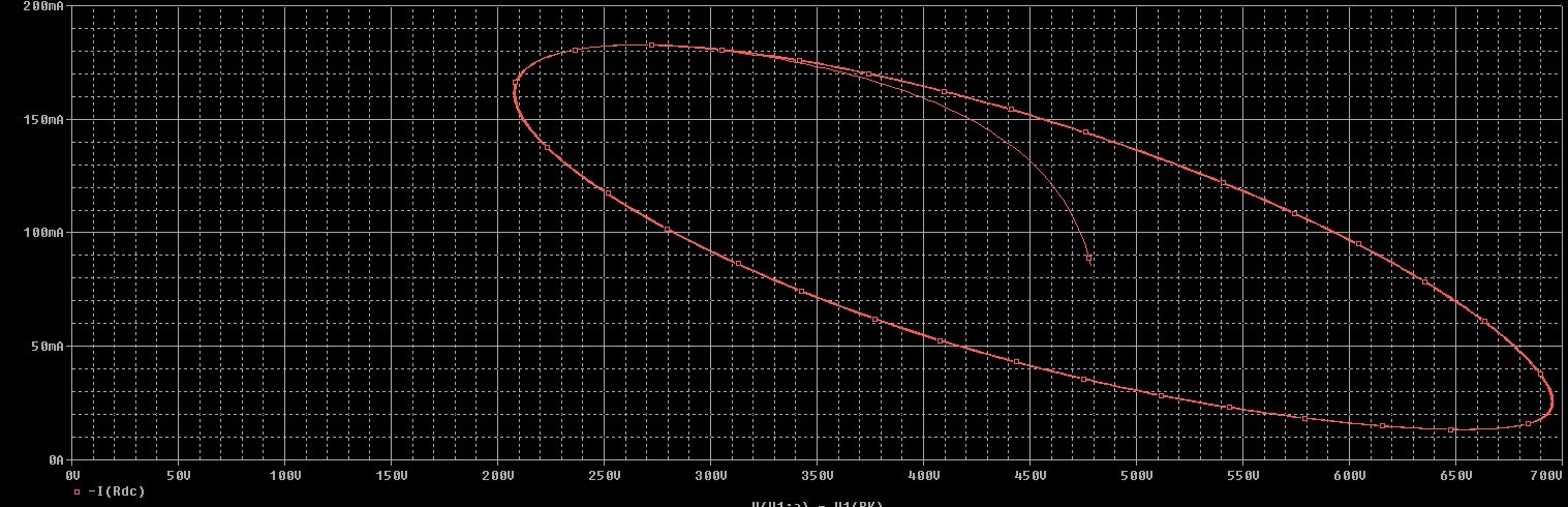

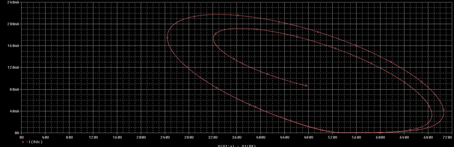

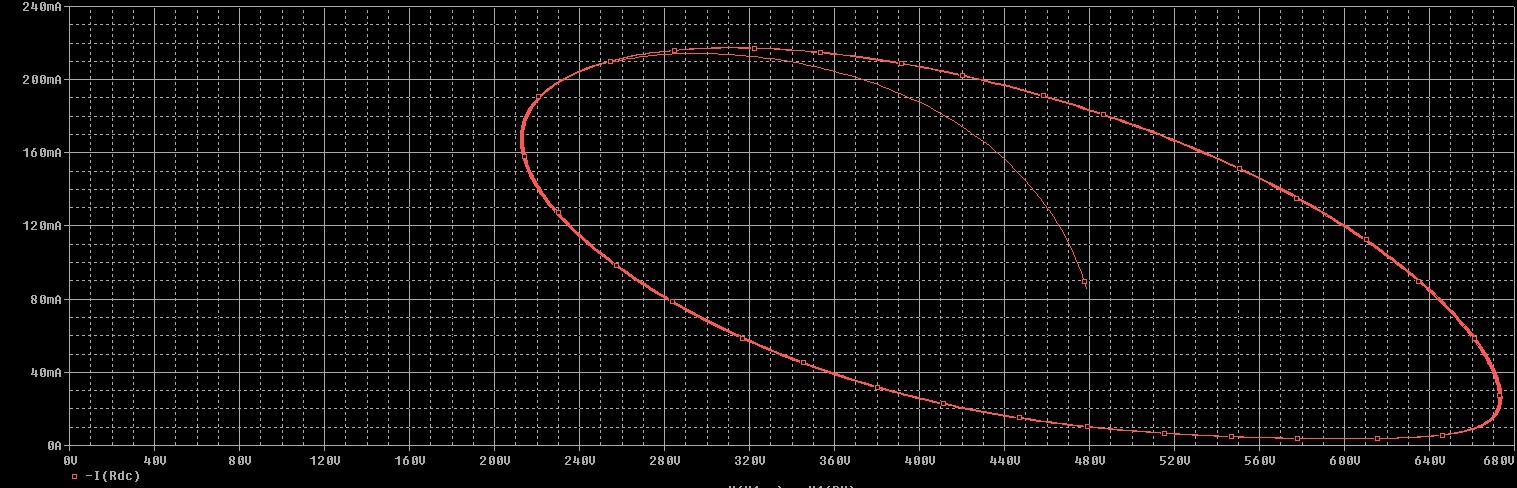

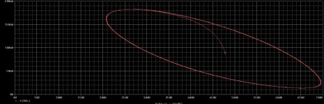

This is what is happening at low end with 16Hy and 40Hy
With 16Hy OT working elipse is so distorted. Almost loose the elipse shape. And more important, laying at X axes with "belly". To avoid this behaviour, we must decrease input voltage signal. And as the consequence we will lose the max undistorted power significantly.
With 40Hy OR primary there are no distorted working elipse, @20hz, there is no contact from working elipse and X axes. So there are no need to decrese input signal at the tube, and max power can reached at the low F.
Even with the 40Hy@20Hz static load line (in this case i put 3,5K) still is in the close range of 10-20 tolerance.

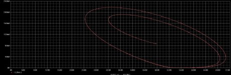

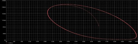

From the other side of BW @20KHz capacitive reactances taking place and there are the diference 3.5nF to 2nF
Almost the same thing occur. With 3.5nF wotking elipse is deformed, causing large distortion, leading to decrease input signal swing to avoid this...
But with 2nF working elipse looking good and without huge changes in the shape.
