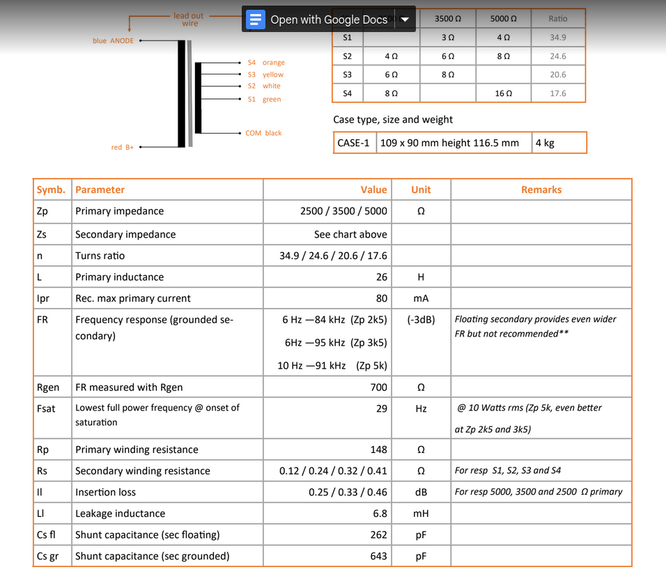

I listened only good things about Monolith, but never tried.Hello all, i have been tested Trancsendars 10 watt, Edcors GSXE, Softone RW20, James 6123. Now thinking to buy Hashimoto H-20-3.5U or Monolith Magnetics Summit S - 9. Please help me to choose. Thanks.
I heard good thinks too.I listened only good things about Monolith, but never tried.
Yes very expensive. Hashimoto H-20-3.5U and Monolith Summit S - 9 both cost about same.Only drawback if any: expensive.

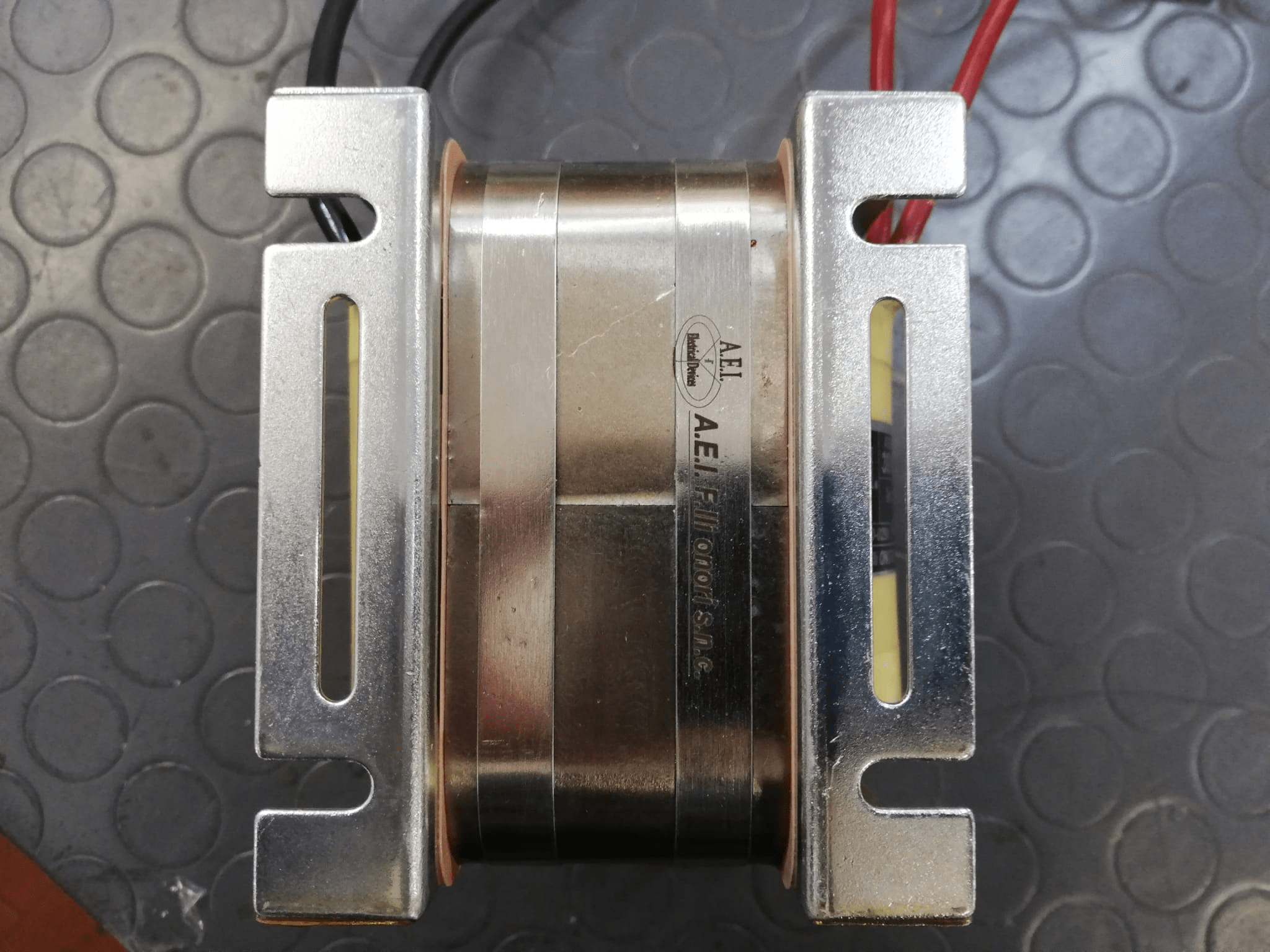

The there is FIAT in Roma tha wound S.e. with double C 0,1 mm nucleus

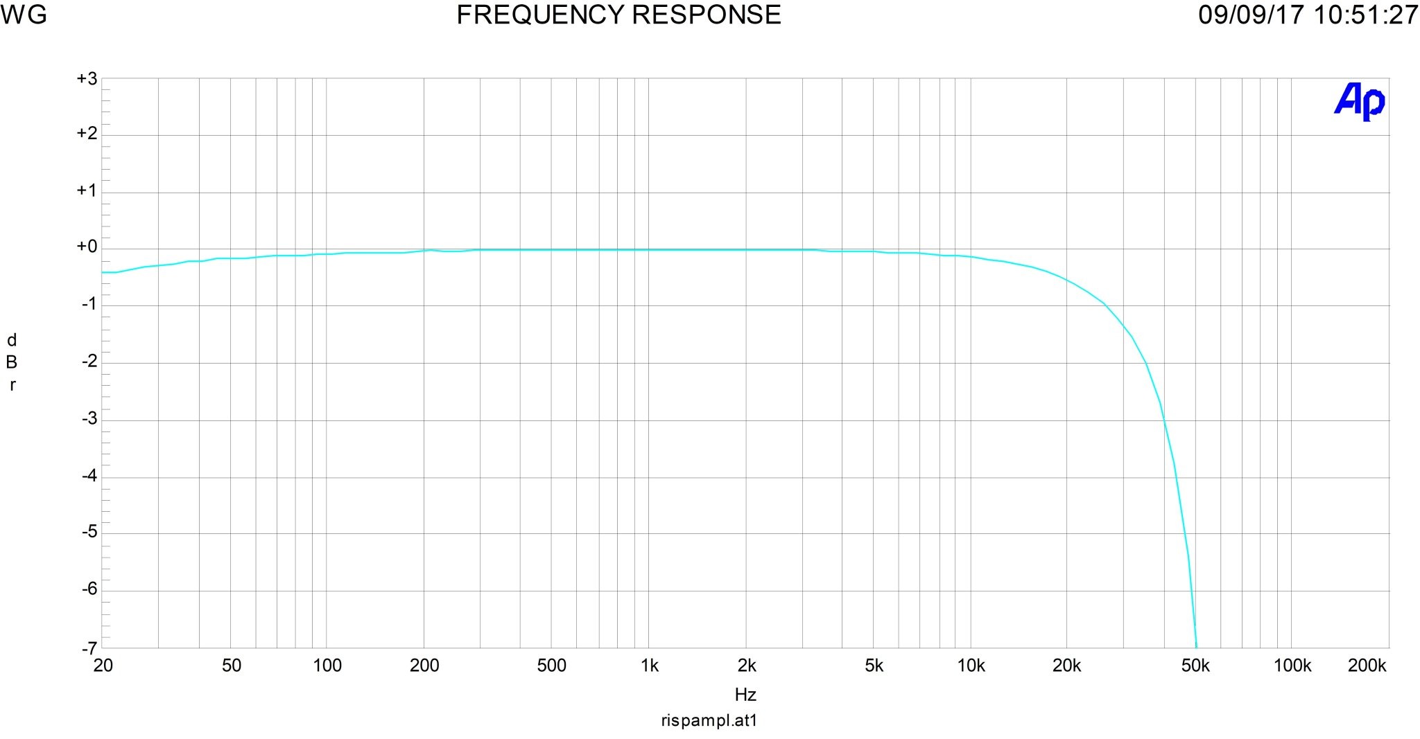

In attach the response at 8 watt - 8 ohm

Onori S30W3.5K8 DC resistance only 67R that is good value. |
Yes, it very good trafo.
I tested it a lot.
Also Fiat has a quite low Rdc.
Sometimes here in Italy hobbists search for esotic trafo where the specs are sometimes scarce and the test lab are inesistent.
Personally every trafo I test the quantity of measurement are a lot ( and I bought everyone)
Some Partridge trafo were done in the Marche region in Italy, many years ago!!!!
Walter
No specification of induction at 20 Hz (where it matters), and bandwidth 20Hz-30kHz minus ???? dB.

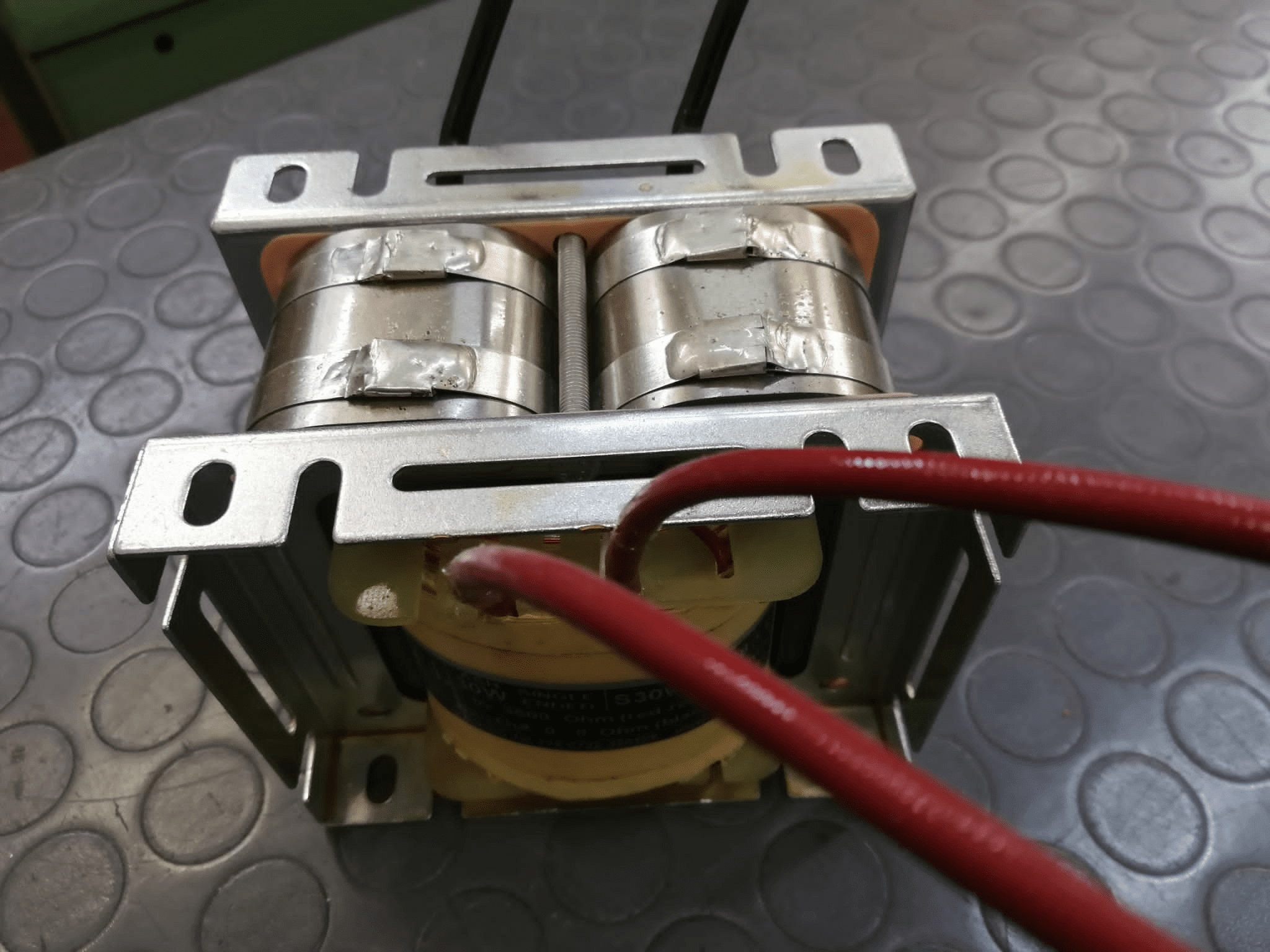

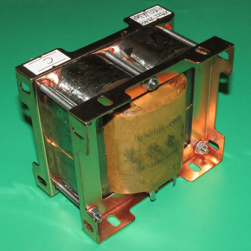

I would bother for something else. The cores depicted do not look amorphous to me, but more like regular HiB C-cores. Amorphous cores are silver shiny in color, flaky and geometrically very uneven. The common signs to look for nanocrystalline for amorphous core is their "uglyness" compared to the stable looking, even covered HiB alternatives.
This is how an amorphous core should look like:
There is a 50Hz where all others are not specified or (at least) , as usual, at 120 or 100Hz!No specification of induction at 20 Hz (where it matters)

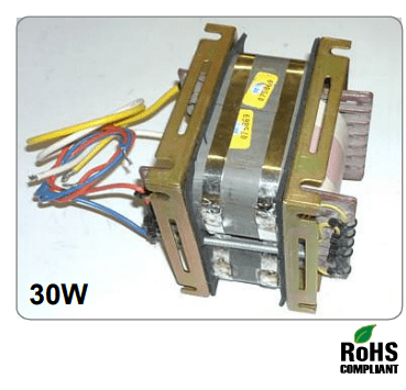

As a noob, what does the 325volts (ref. 36va) mean for the S30W3.5K8 indicated in the ASH OT specifications? Maximum voltage B+ ?
Thank you
I am interested in two OTs for a 300B Skunkie design project
Thank you
Actually it is the only "good" value.

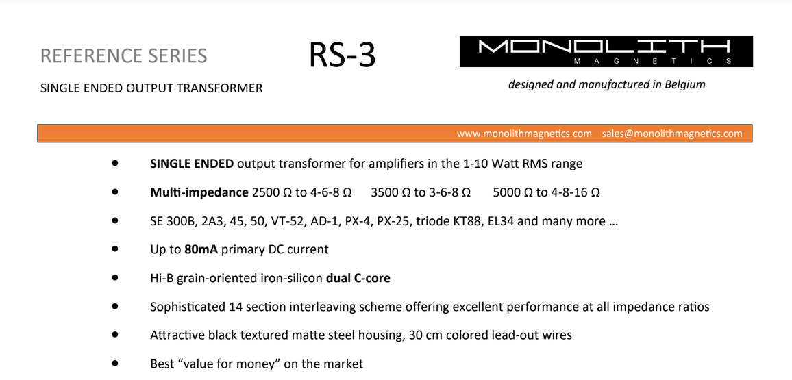

What does the 30W mean??
Certainly this transformer does not do 30W secondary power.
Does it mean the power tube can be operated with 30W of anode dissipation (more likely)?
By the way, with let's say 400 Vpk-pk at the anode, the secondary power at 8 ohm is less than 6W.

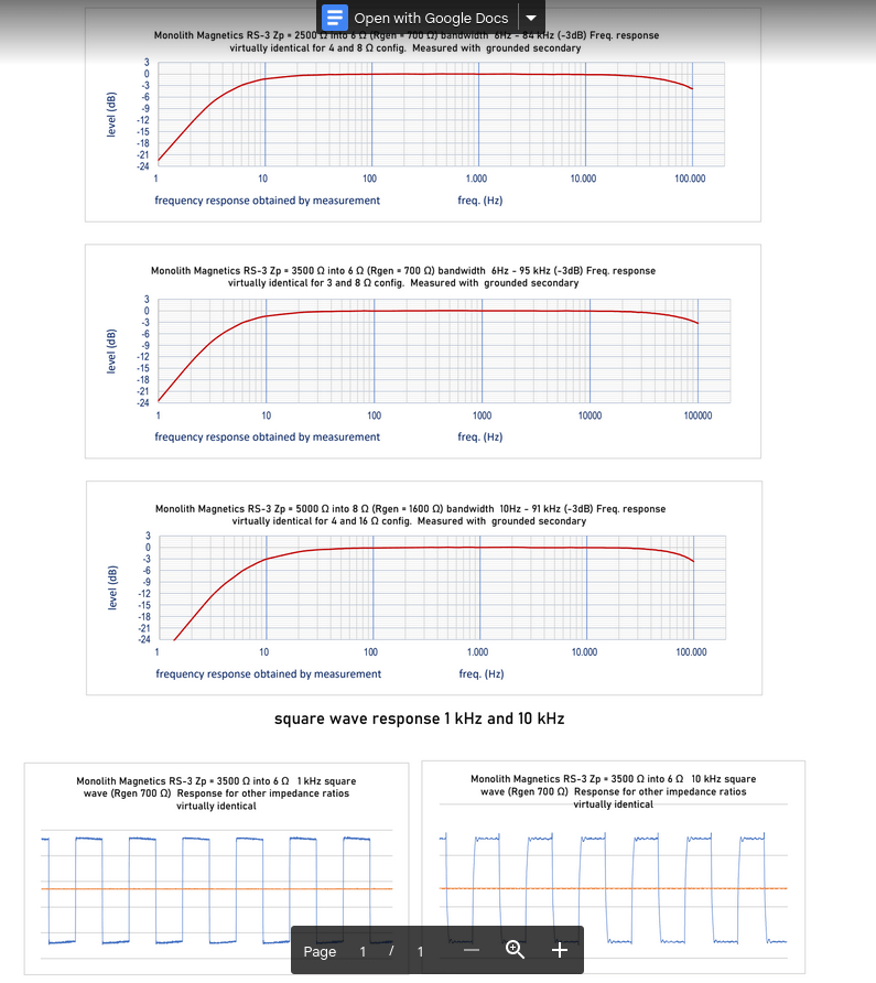

Monolith specifies core saturation treshold with respect to frequency, primary DC current and power, which is the correct way; the Onori 18H @50hz is useless info.
