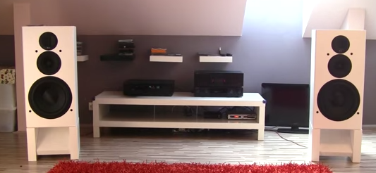

I set similar goals when looking to buy my speakers. I wanted proven quality affordable top of the line drivers within a full range speaker that I could build and not spend more than $3k.
I choose the J.Bagby SB Acoustic Satori 3-way. It costs about $1100 in drivers and crossover from Meniscus Audio. It is a modular system so you can use different monitors and mate them to the woofer. You can also buy .5 cuft speakers boxes for the monitors and use them till you have the woofer cabinets. I could get the all the cabinets made or bought for about $400 in raw mdf. Still need to finish the upgrade from the Adelphos to the Kairos crossover version and speaker box, but I built the Adelphos version to make my life easy.

IMO something like Bagby's Kairos, sealed and XO'd to a pair of dual subs using top woofers for bass reinforcement. Acoustic Elegance comes to mind. You could probably get something like dual TD12S woofers with plate amplifier.
Of course, if we are going to huge SPLs, a high-end SEOS-based speaker could also be an option. Linkwitz's LX521 are also a strong choice.
This would be my suggestion. If you're open to more than 4-way, then the NaO Note II RS.

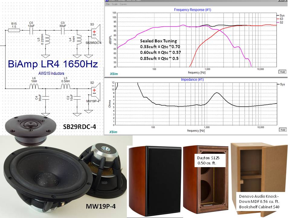

After reading the comments:
1) Post the crossover and cabinet design for your current speakers. Maybe an expert will notice a weakness in the design.
2) (classic-rock and vocals) Maybe you would favor the dynamics and frequency range of an exceptional 7" midbass like the Satori MW19P-4 over your current 5" midrange. Attached example of 2-way design which uses LR4 passive crossovers, which will closely match the LR4 electronic crossover in most sealed box woofers. The Satori MW19P-4 covers the full vocal range.
3) Because you already have a pair of quality sealed box woofers, I still believe building a high efficient horn/waveguide TM (post #10) would best fit your room and musical taste(classic-rock and vocals). diysoundgroup.com Fusion12 comes to mind. Easy to find many proven EconoWave designs at any size and price point.
