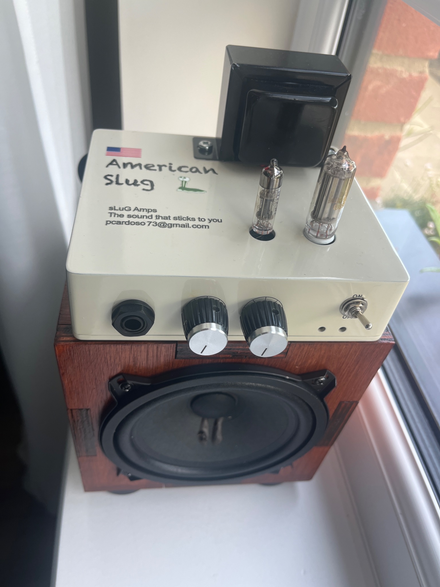

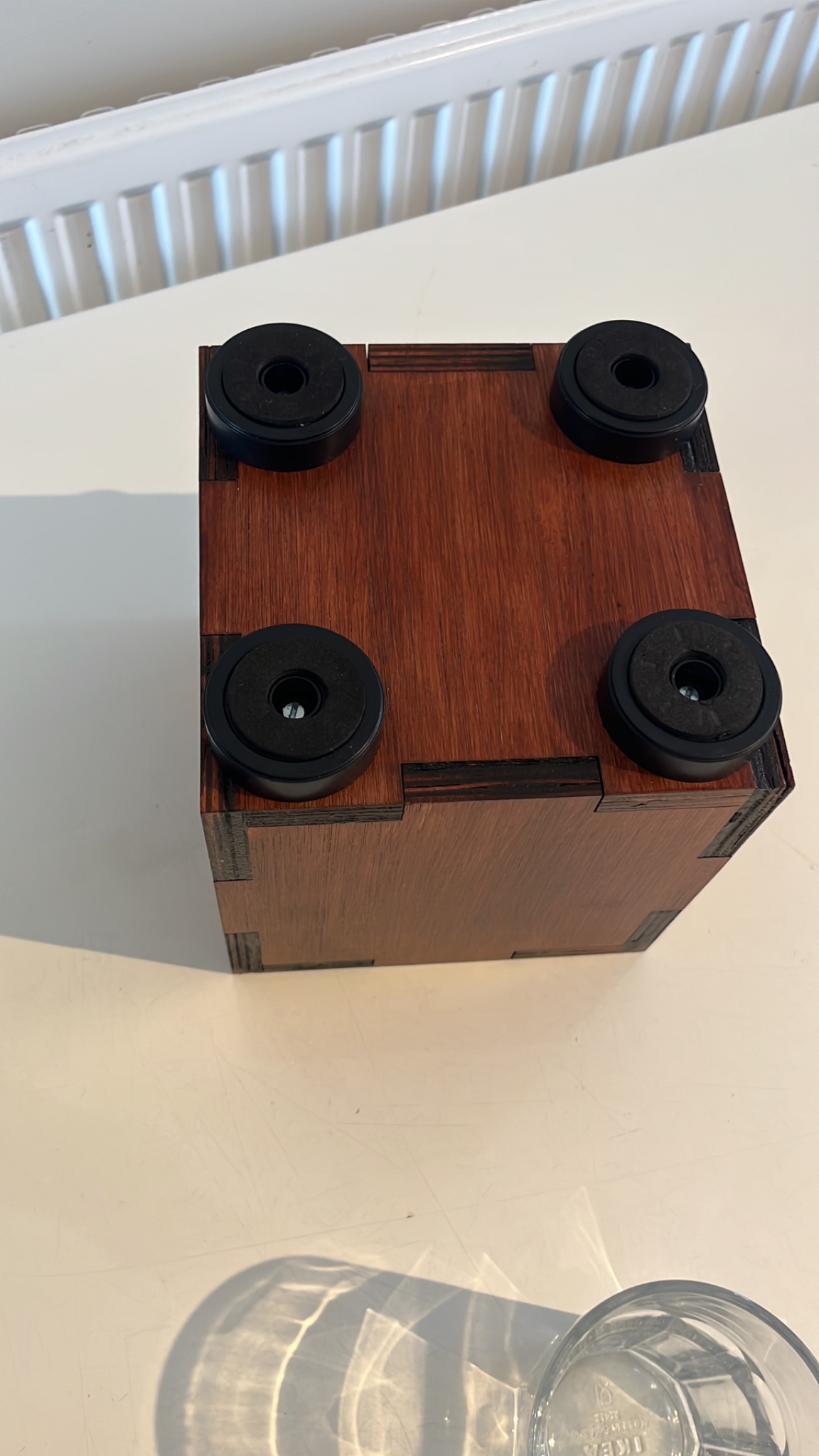

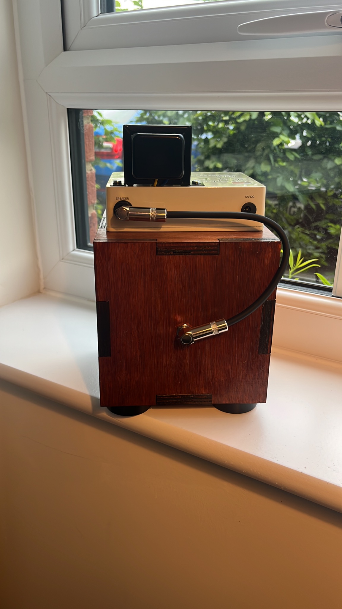

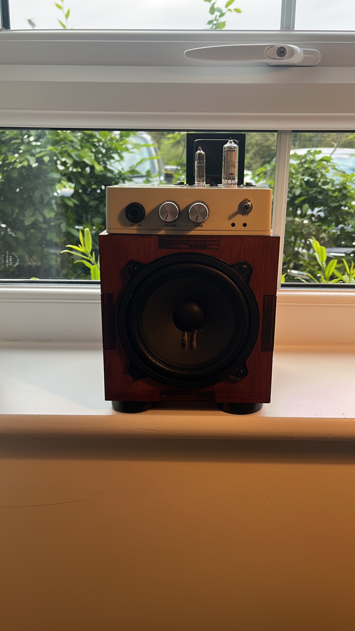

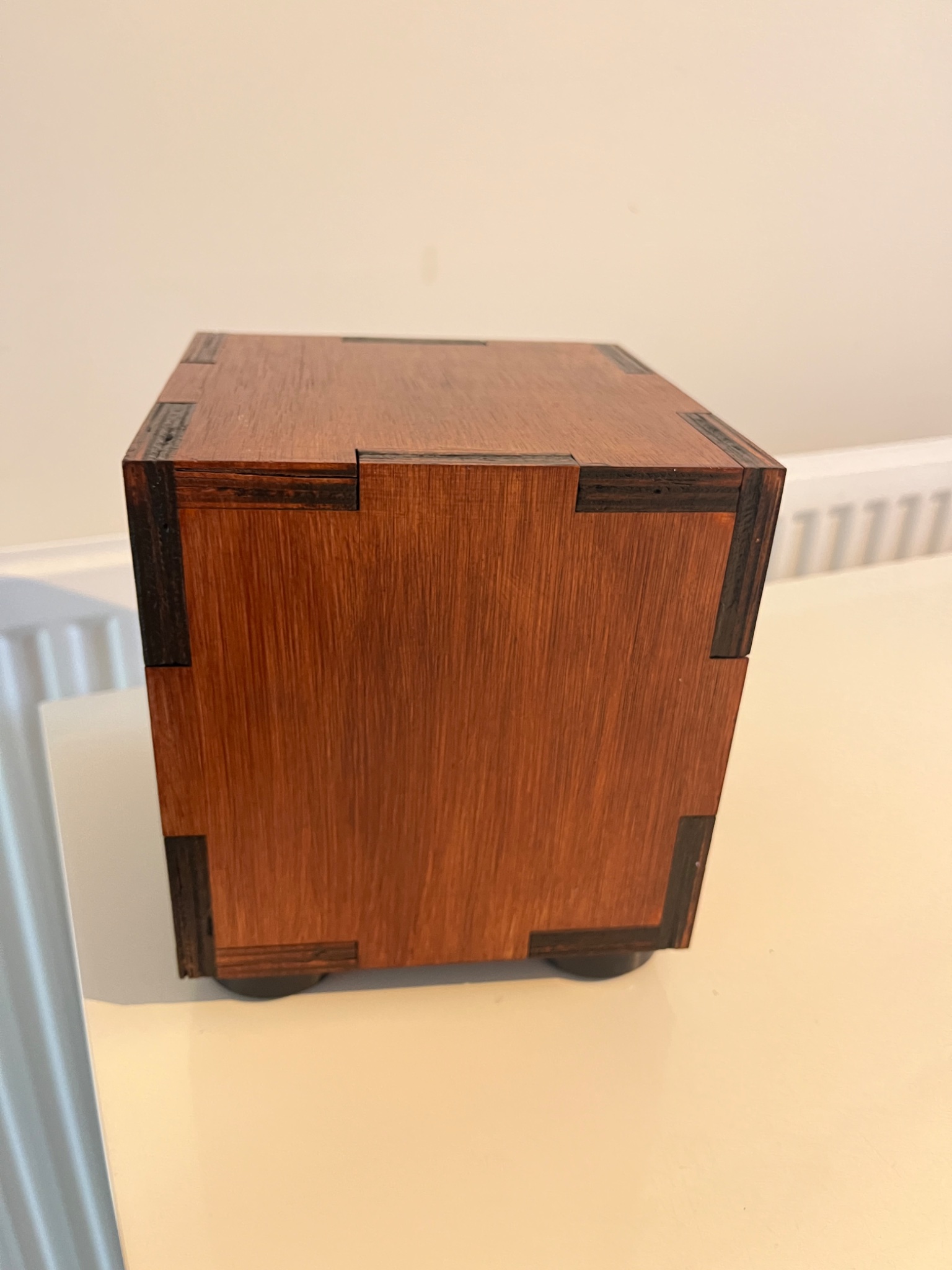

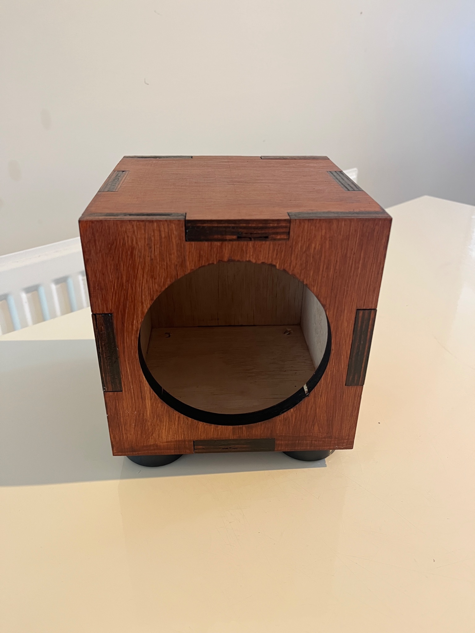

It has arrived. I asked some to make the box for me and apply varnish. This is the result.
