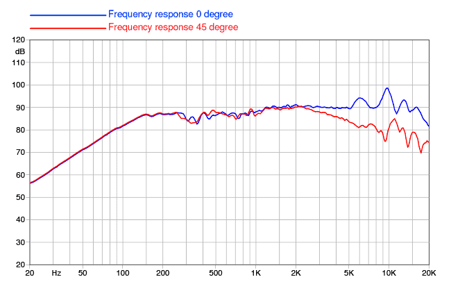

No magic, but well known differences between general purpose speakers and real guitar speakers.
Here is the frequency response of Jensen C6V:
And here is the frequency response of FaitalPro 3FE26:
Very different!
DSP may change this frequency response to be similar to Jensen, but can't change the temporal behavior (waterfall diagram) of the cone brake up of the Jensen. So, general purpose loudspeaker never sound similar to the real guitar speaker, in spite of DSP use.
For my knowledge Jensen are measured with IEC baffle which is not comparable with infinite baffle measurements.
Many manufacturers are using IEC baffle and those measurements are comparable to infinite baffle measurements. All IEC baffle measured frequency responses have minor artefact - slight dip at around 400 Hz, which is absent in a true infinite baffle.
