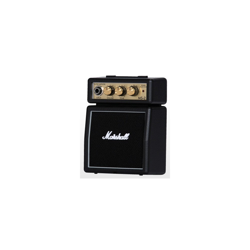

Marshall disagrees with you: https://www.musicstores.in/electric-guitar-amps/marshall-micro-amp-I will strongly advice against the use of such small loudspeakers.
Obviously is not the best tone, but pretty much does the job hanging out with some 9V batteries on this little box hanging on the belt.
I remember Dimebag doing some drunk fun with this on a Pantera video, and the tone was pretty acceptable.

Again - loudspeaker inside that Marshal is proprietary and much different than any other 2" or 3" general-purpose loudspeaker you can by.Marshall disagrees with you: https://www.musicstores.in/electric-guitar-amps/marshall-micro-amp-

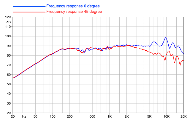

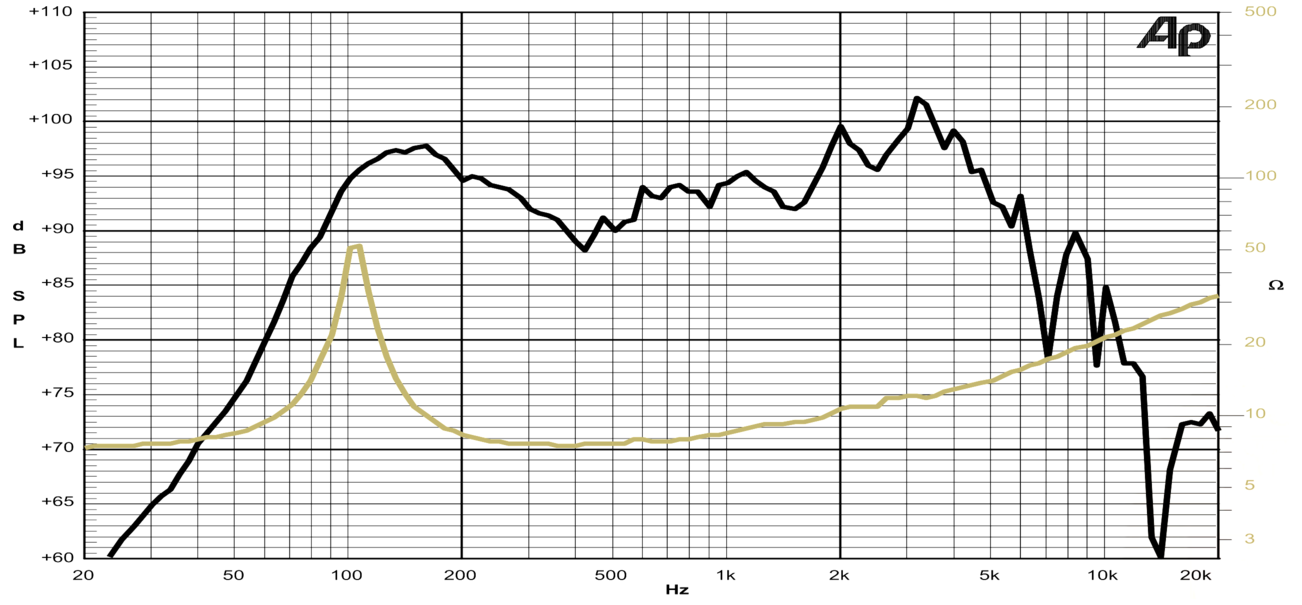

No magic, but well known differences between general purpose speakers and real guitar speakers.
Here is the frequency response of Jensen C6V:
And here is the frequency response of FaitalPro 3FE26:
Very different!
DSP may change this frequency response to be similar to Jensen, but can't change the temporal behavior (waterfall diagram) of the cone brake up of the Jensen. So, general purpose loudspeaker never sound similar to the real guitar speaker, in spite of DSP use.
Let me apologize with a different opinion about this.
Why is everybody moving to FRFR speakers in the guitar world?
So, to me, the Jensen looks like a very cheap speaker, with lots of wiggles in the impedance, and huge cone breakup.
We already add distortion pedals and such, why would we need the speaker to add more unwanted distortion?
A PA system doesn't have that kind of FR like in the Jensen, yet, may guitar player will output directly from their pedal board.
So, sorry, but I don't understand why we should get an inferior driver when we can get a better one.
In this day and age of boards like the Cortex, Ampero, PG, etc... we need speakers that can reproduce what we dial in, not being colored at the end by a ragged FR.

A mountainous frequency response is normal and preferred for guitar speakers (I don't make the rules). Scratching my head as to why, but there may be some technical advantages to having high sensitivity peaks in the 'scream-ish' 2-4kHz range, like reduced loss-related distortion.
Soft polymers dampening paper cones and rubber surrounds may be great for getting a flatter tonal balance, but it's not free. The price is subtle distortion of the "dull, grey, veiled" variety. The opposite of musical and the sound "popping out" at the listener. For a more technical analysis, people would have to take an interest in minuscule <80dB side bands, which is rare.
Of the FR hi-fi speaker variety, the Fostex 'NV2' range could be nice, mainly because of the featherweight cones, cloth surrounds and declared low X-max. But the dedicated Jensen, Celestion, etc. types will probably have more of a classic guitar 'twang'.

Yes, it is cheap, but there are much more expensive guitar speakers on the market. Likewise, FaitalPro 3FE25 is cheap, but there are much more expensive hi-fi/PA speakers on the market.So, to me, the Jensen looks like a very cheap speaker, with lots of wiggles in the impedance, and huge cone breakup.
Huge cone breakup - yes, that is the characteristic of the real guitar speaker. If you don't have that breakup - you don't have the sound of the real guitar.
The guitar speaker doesn't add more distortion (add to what?!), it creates the (distorted) guitar sound.We already add distortion pedals and such, why would we need the speaker to add more unwanted distortion?
Zen wisdom: What is the (electric) guitar sound without the guitar speaker? Silence!
And many guitar players prefer the sound form the real guitar speaker/combo.A PA system doesn't have that kind of FR like in the Jensen, yet, may guitar player will output directly from their pedal board.
Real guitar speakers are not "inferior" to PA or hi-fi speakers, they are just different because of the different purpose. You have to understand - hi-fi speaker reproduce sound, guitar speaker produce sound! Totally different!So, sorry, but I don't understand why we should get an inferior driver when we can get a better one.
