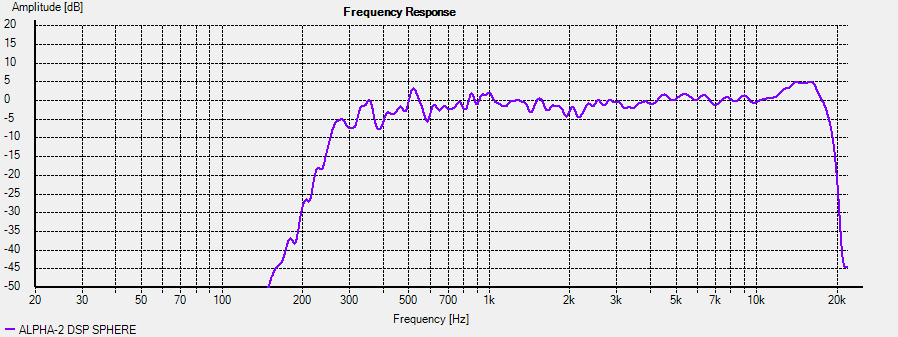

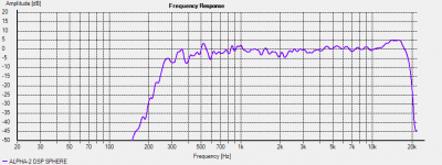

I've been playing with the Eminence Alpha-2. Love this little 2"er. It's in a 8" sphere over a RS-225-8 BR cab. Detail is really nice.
