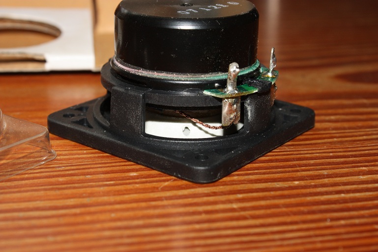

I put them in a glass cube tealight which fitted the bezel nicely, gross volume of around 65cc, sealed the TB requires ~50cc, the net volume is maybe half of that. Once the gallery works again ill post the pix. It was a fun project which i didnt take too seriously, and wasnt optimal, or even finished. Plus the inductor didnt fit in the cube, so it got shelved for the time being.

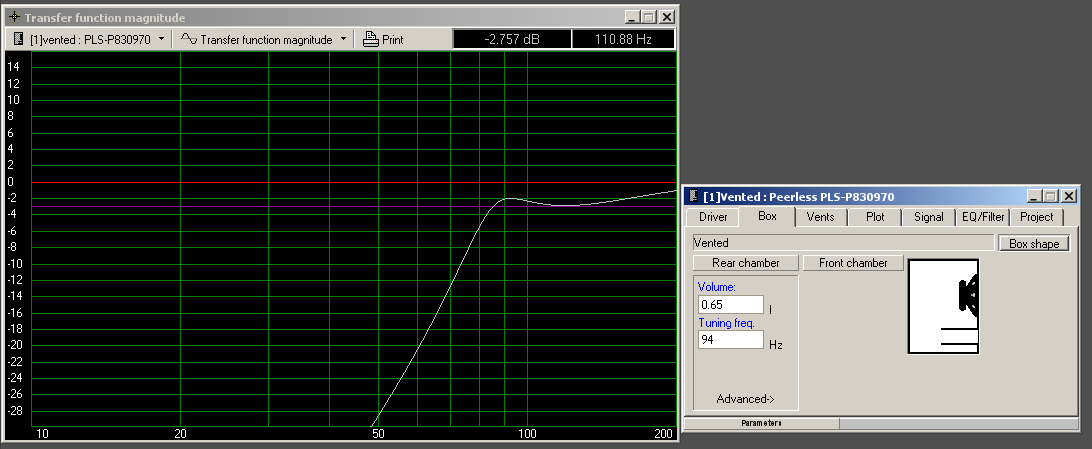

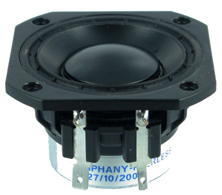

I have a pair of Peerless' PLS-P830970 2" full-range speakers and I would like to make a tiny laptop audio system for my girlfriend with these. What kind of enclosure would be good with this kind of driver?
Datasheet:
http://www.tymphany.com/files/PLS-P830970 Rev1_0.pdf
So far I have came up with this kind of design with WinISD but I'm not sure if its tuning frequency would be too low.
Datasheet:
Code:
[SIZE=2]Qts: 0.57
Qes: 0.67
Qms: 3.9
Fs: 166 Hz
Vas: 0.18 L
Sd: 13.9 cm²
Cms: 0.661 mm/N
Mms: 1.39 g
BL: 2.79 T*M
Revc: 3.6 Ω[/SIZE]
Bringing back this old thread. I have built a small portable speaker with the Peerless P830970. 0.55 l tuned to 120hz. It runs on a battery operated chip amp. For what it is it sounds good, not much bass of course but way better than many commercial small portable systems. I have compered it to my tivoli audio 1 radio, and it is better than the tivoli in every way apart from the amount of bass (not quality, the bass from the tivoli is not that good, but being a 3" it has quite a lot more than the 2" does)

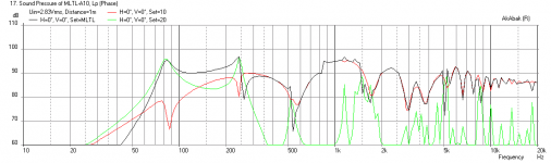

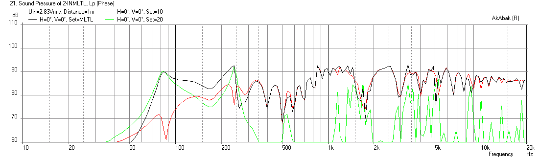

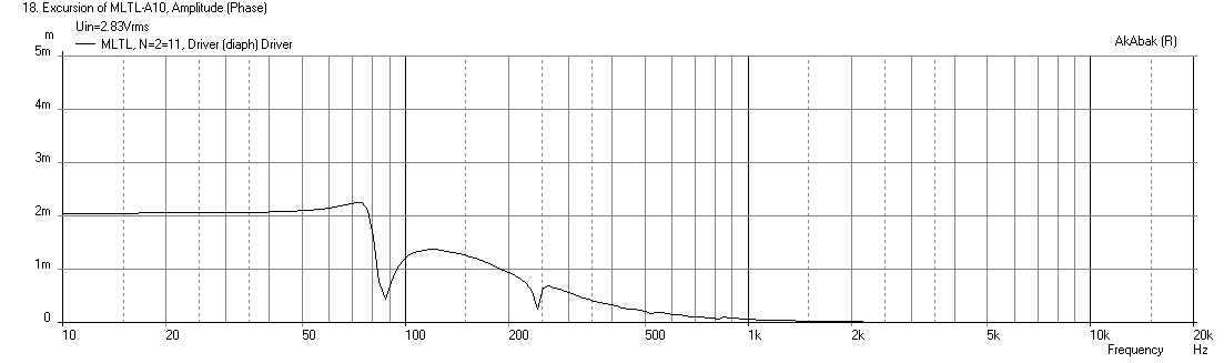

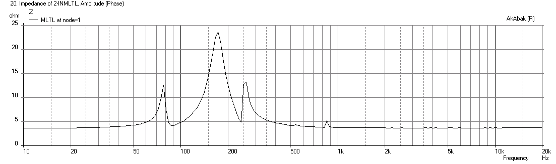

2 inch Peerless miniature MLTL
If you make a very small folded mass loaded TL, you can get bass output down to about 80 Hz. Make a 2.5 in wide x 1.0 in deep x 24 in long TL (1 liter volume). Mount the driver at 1/3 (8 in from closed end). On the opposite end, put a 4.5 in long x 1.0 in dia tube as vent/port. Use an elbow if you want it front firing. You can fold the TL in 3 so that it is a 7.5 in x 8 in x 1 in deep box. Below are the simulations in AkAbak for this TL assuming it is placed against a wall, etc. Last plot shows response far away from back wall - as you can see it still has enough extra bass that it will not need any baffle step correction (BSC). Put polyfill stuffing from an old pillow in first 16 inches of line - that will smooth out all the peaks and valleys (AkAbak cannot model damping from stuffing). Good luck! It should be a fun little speaker.

thanks for simulating the TL. Looks quiet interesting as a small portable set up.
This part i don`t understand:
BSC for the bass?...Last plot shows response far away from back wall - as you can see it still has enough extra bass that it will not need any baffle step correction (BSC)...
