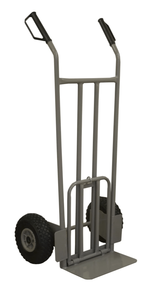

If you don't have one already...
I hardly move my speakers around at all, but I still got one of those.
I use some loading straps to make sure the speakers are secure while moving, and a carpet dedicated solely for this purpose to protect against scrapes'n'bumps.
Involving other people is more of a chore than just dragging them about myself.
