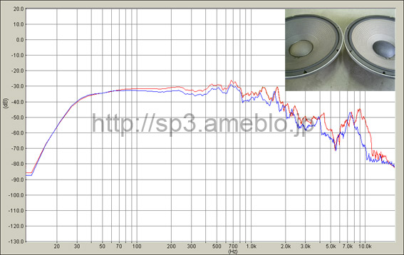

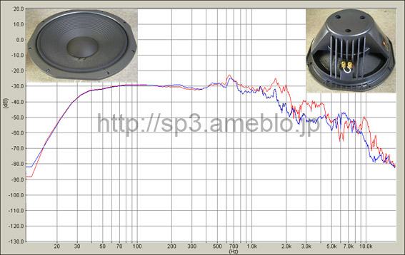

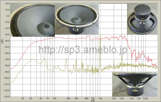

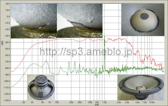

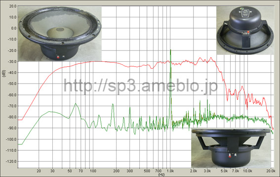

( Some ) Altec HF response ( as measured independently, in Japan by a reconer//reburbisher who evidentially cares enough about his craft to actually measure + post the results of his repairs ).
Compare to a couple well known JBL HiFi woofs ( 2235H > should be crossed over well before 1K );
These days ( from what I've seen ) FaitalPro seems to follow Altec's goals and design philosophy ( regarding the importance of HF extension in a woofer ).
