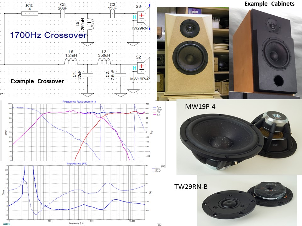

From your comments, a 2-way using the 7.5" Satori MW19P-4 $184 midrange with the Satori TW29RN-B $146 tweeter is worth your review. Troels Gravensen designed/built the "SBA MW19 Studio Monitor" with these drivers. He used a cabinet with a stepped baffle for tweeter-midrange time alignment. Rounded edges are typically added. A ported 0.7 - 0.8cuft cabinet produces -F3 ~45Hz. No baffle step was included in the example since this speaker is ~2ft from the rear wall. Slanted baffle designs do not provide great tweeter-midrange time alignment for close-in listeners(desktop).
The crossover slopes are steep enough for you to also look at the flat baffle plus truncated pyramid type cabinet Troels used on his "Illuminator Monitor" design to reduce edge distortion.

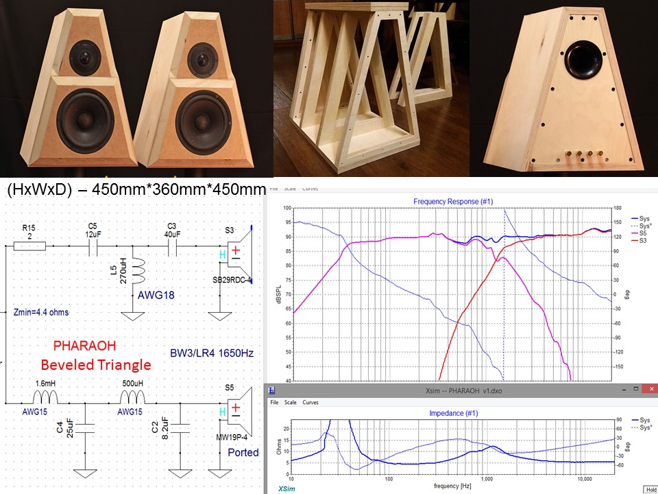

On the web there is a "Pharaoh" speaker design which uses the Satori MW19P-4 midbass in a trangle shaped cabinet with a stepped front baffle for time alignment.
Member Pida uses the MW19P-4 with a tweeter waveguide cut into the front baffle which also provides T-M time alignment.

The Bliesma T34A-4 tweeter costs > $500.... For this total < $500/speaker goal I was pitching the Pharaoh cabinet construction with the Satori TW29RN-B $146 dimpled dome tweet plus the MW19P-4 $184 midbass. It is easier and cheaper to cut bevels on the cabinet edges to reduce distortion than to pay $100-$150 for a 1" - 1.5" radius quarter round router bit. Naturally...."smoke-them if you got-them"
From Russia.. ... around 22 construction pictures
Pharaoh ldsound.ru (8) | ldsound.ru
