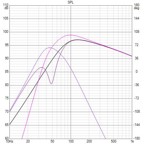

i like them, i hated them at first and i swapped the apt50 for celestion cdx1446, but they did not fit so good so i went back to using apt50, with a new crossover they started to sound nicely. but the big box has been problematic, i could hear a boxiness that i did not like, so i used a lot of mineral wool for internal acoustic damping and many sheets of bitumen on the exterior. i think big boxes like these needs a better construction then mine to really be inert.
this is how they simulate in vituixcad for sealed and vented, see pic
I have my 10cx in a 37l box and it works quite good in that. But yes a few more liters wouldn’t hurt. I have the 12cx in a 48l and it’s definitely to small. I think 60-70l would be great for it. All with bass reflex, I tried closed first but I don’t think stiff PA drivers are meant for that.
