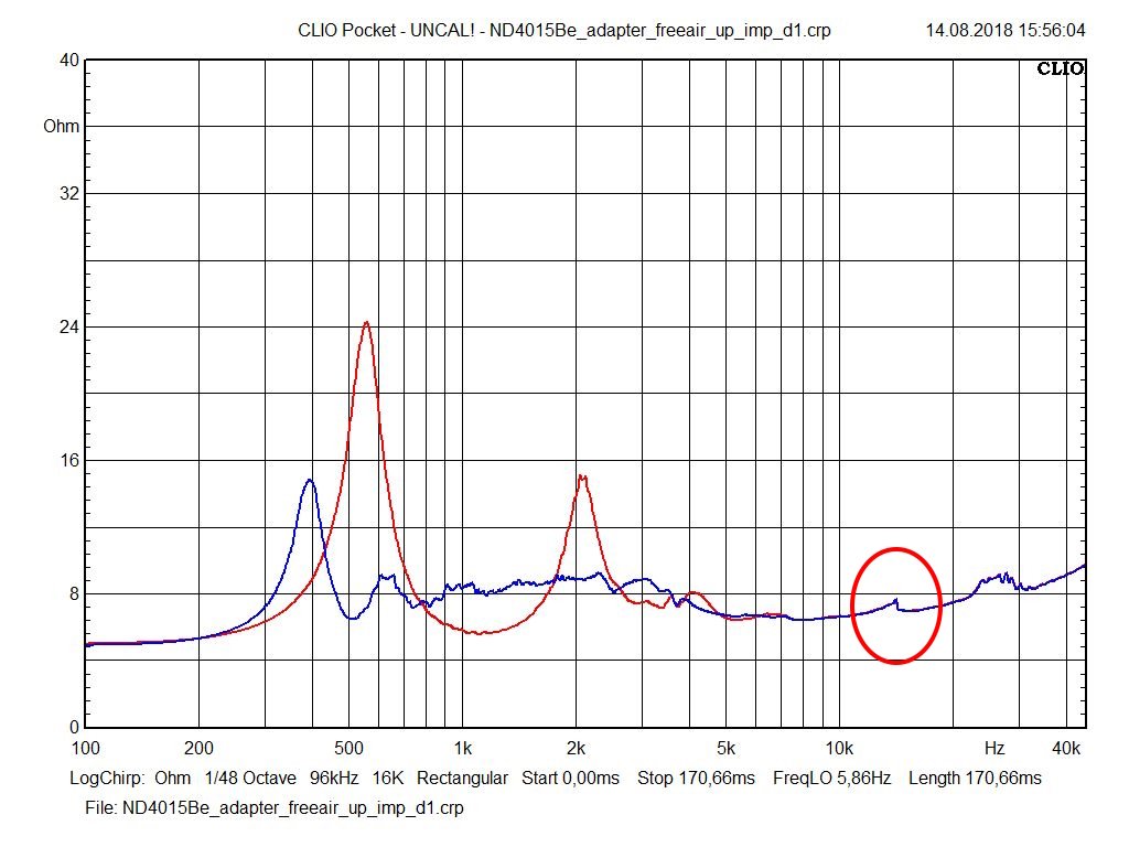

Docali's measurement review of the ND4015BE: https://sphericalhorns.net/2023/07/15/drba-test-bench-eighteen-sound-nd4015be/
A very high frequency resonance (circled red) is still present in the free air as well as in horn impedance plot. Though at least it seems decently well damped in the frequency response and decay measurements.
Yes that is unavoidable due to the diaphragm size.
WIll find it in any 4" diaphragm.
And it is one of the better ones.
Might also notice where the phase plug ends, it's a "throatless design ala JBL 1,5".
It is actually very well behaved if you look at the spectogram for having a 4" diaphragm.
And Truextent Be foil is generally well damped, due to it's ductility vs a TAD CVD dia.

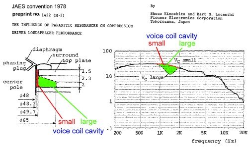

The TD-2001 has a cavity resonance ca 1,7 khz, due to the voice coil gap. As ilustrated by the picture below, from the 1978 AES paper by Kinoshita and Locanthi.
The TD-4001 had a similar quirk just less pronounced.
While the TD-4002 has a plastic/rubber ring in the VC gap to counter the effect.
Just look close on the cutout, besides the red colored magnet.

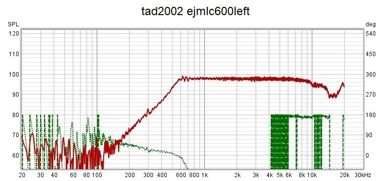

TD-2002 :

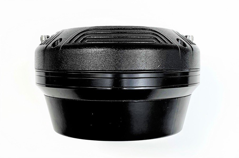

"This compression driver is available in two versions, a 1.5" throat and a 2" throat. For this review, I tested the ND4015BE, which has a 2" throat. "
And it is not.
And from his picture you see it is a 1,5", with a 'zero degree' exit, the phaseplug ends at the driver exit.
The adapters i guess are 29 degrees so it fits most of the 18S drivers.
The "2" version is one of they're 1,5-2" throat adapters, the throat adapters have a exit angle, and the flare rate does not match the compression driver in question. That is why you see the large anomaly in the review from 10-ca 13k, a gross mismatch in the throat.
You can read the same here too, from @docali .
https://sphericalhorns.net/category/drba-test-bench/
This is the ND4020 which is the 2" exit ND4015 version.
Do you see the difference ? a externally mounted throat adapter.
Look up the dimensions in the specsheet etc. and it is very obvious.

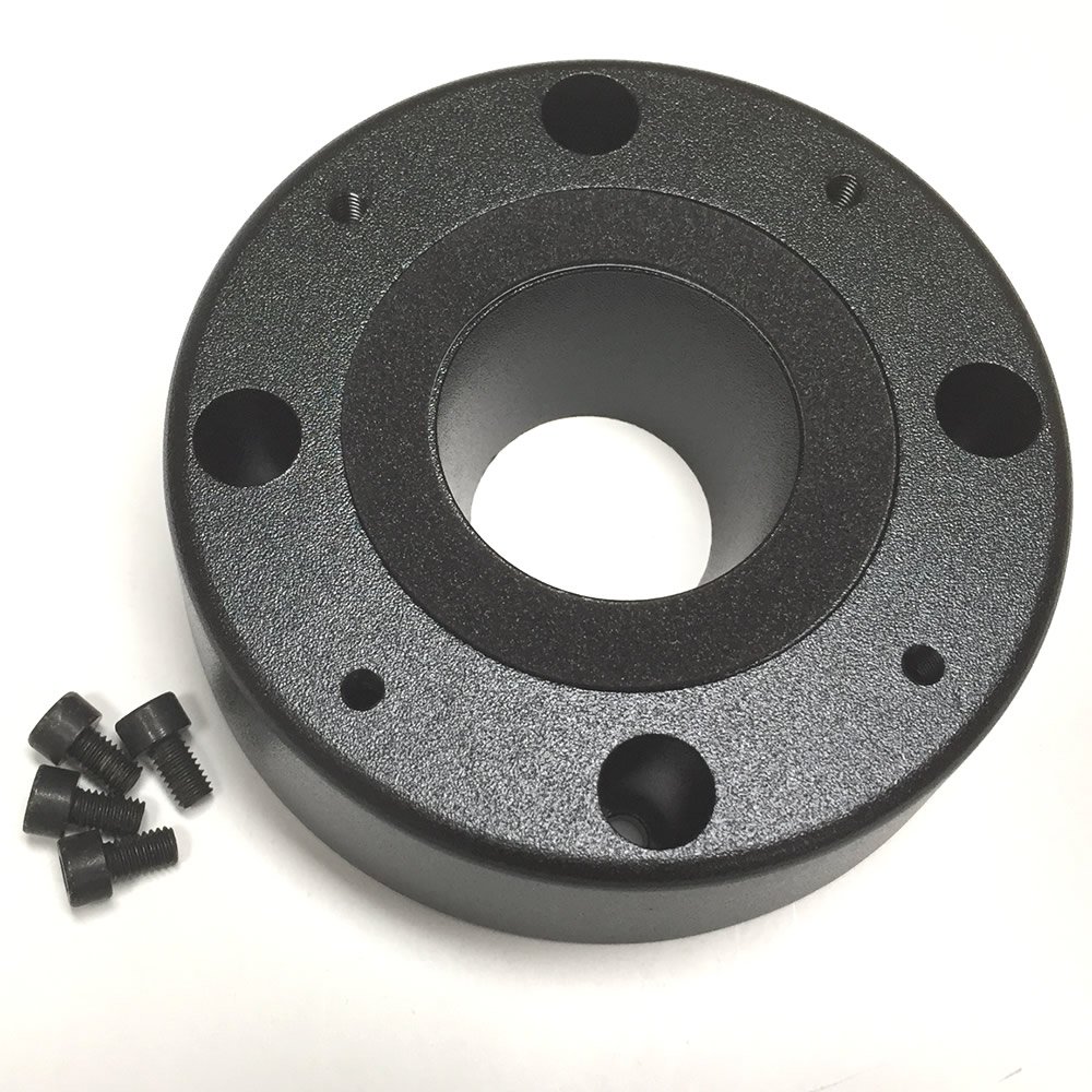

and here is the picture of the said adapters you mount on the ND4015 to make it a 2" exit..
If you look at this one you can see it is not zero degrees, and there is no way for the phaseplug to end at the drivers face/exit.

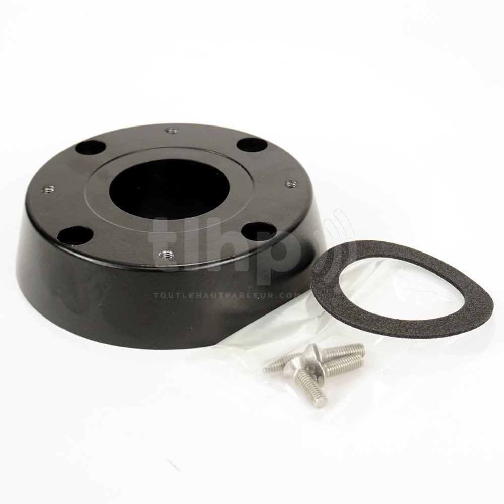

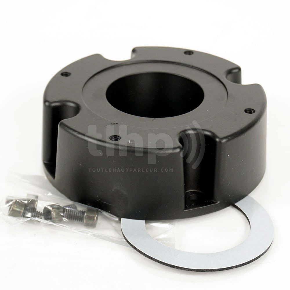

Another example from they're webpage:
The difference between ND32ST and ND3ST is the externally mounted throat adapter in this case 1,4" - 2".
Again it is obvious when you look at the mechanical drawing in the specsheet, and the dimensions.
And on the product picture you can even see the bolts that mounts onto the ND3.
https://www.eighteensound.it/en/products/hf-driver/2-0/8/nd32st
https://www.eighteensound.it/en/products/hf-driver/1-4/8/ND3ST
https://en.toutlehautparleur.com/lo...on-driver-1-4-inch-to-2-0-inch-for-nd3st.html
Compare this to the product picture of the ND32ST, and it will be obvious?
