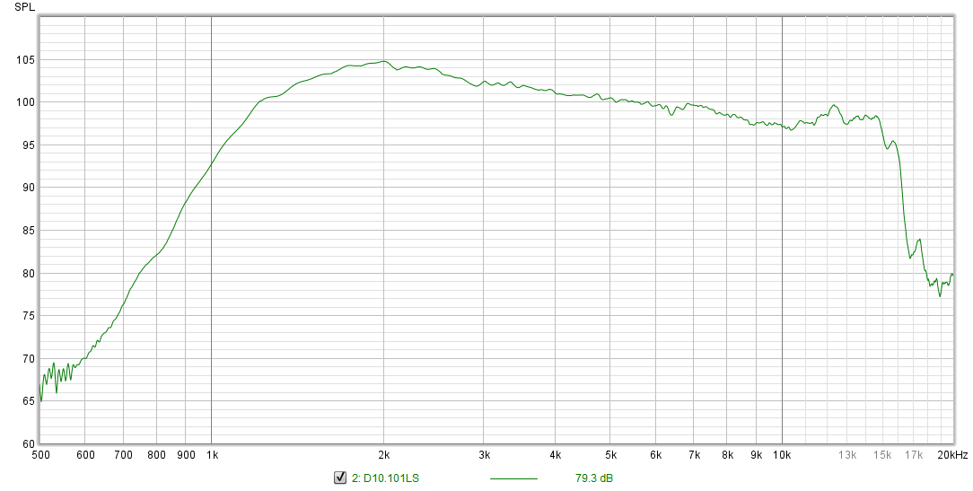

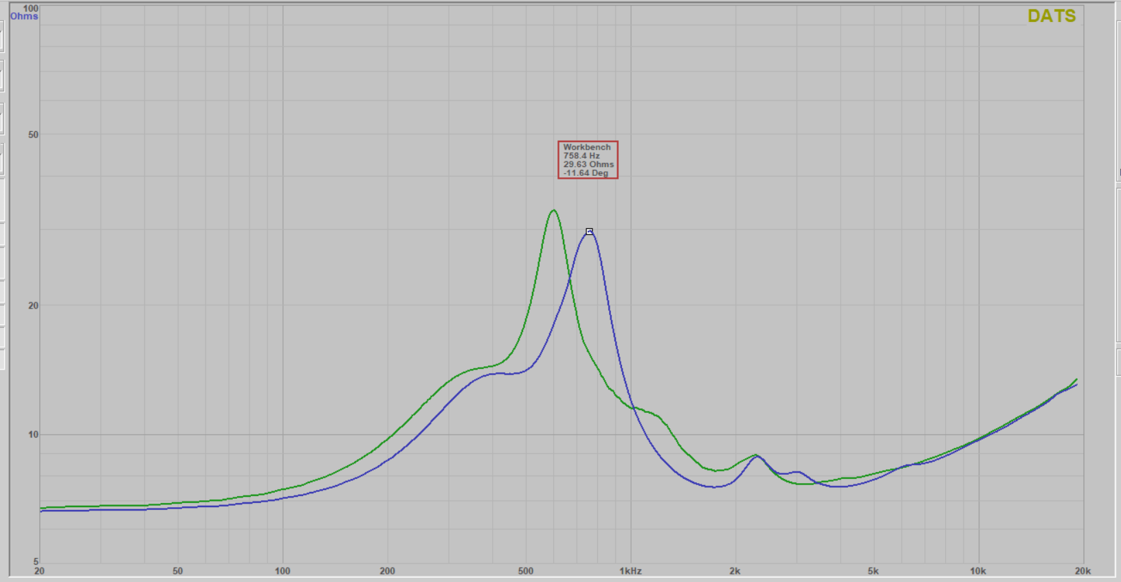

Blue- DFM2335-R00-08 in free air.
Green- In SB Audience H225 horn.
Note the logarithmic scale- that shows everything, warts and all.

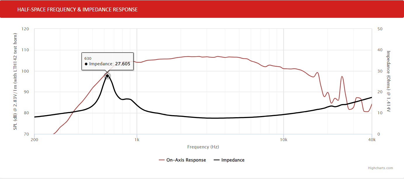

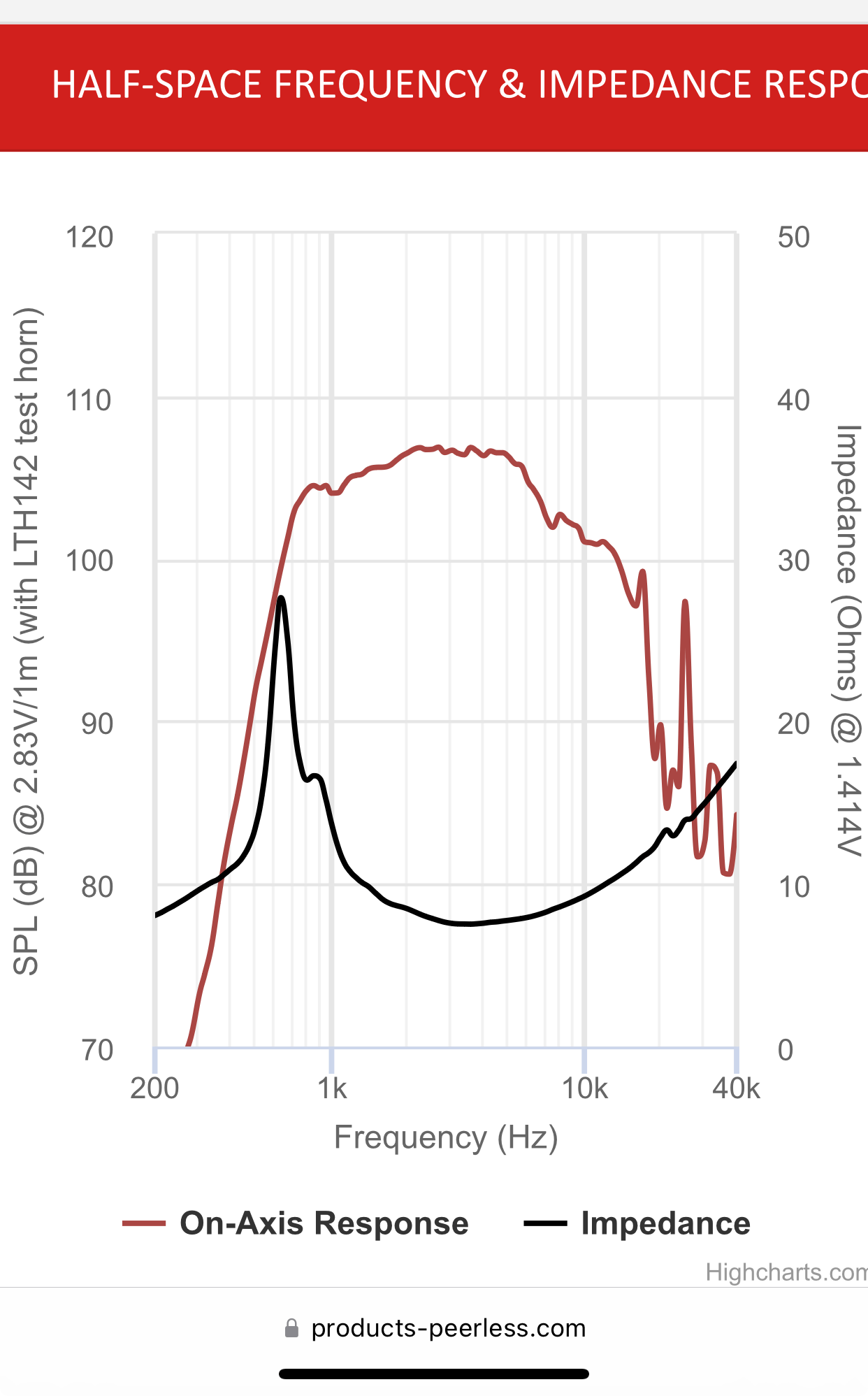

Here it is again, on what appears to be a FaitalPRO LTH142 horn ?
( left vertical axis- impedance is
"with LTH142 test horn”)
A different view:

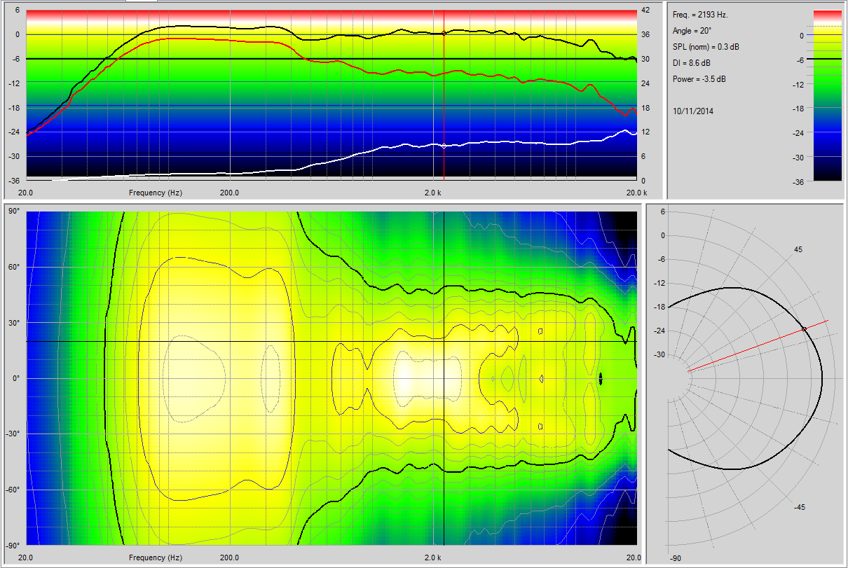

Here the early Nathan model-
Reference:
https://3d3a.princeton.edu/gedlee-nathan
New Summa-
Smoothness and directivity only got better!
Reference:
http://www.gedlee.com/Loudspeakers/NS15.aspx

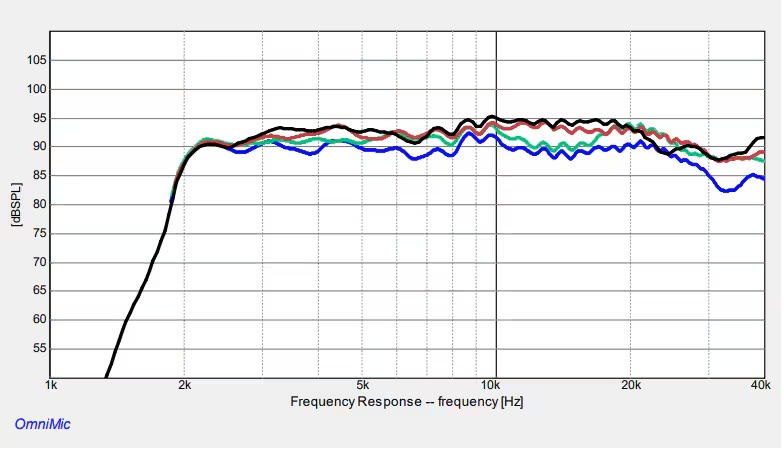

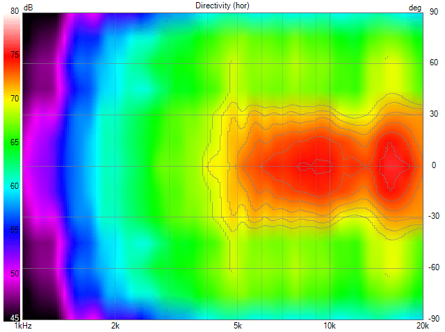

Ribbon tweeter- yes good too-
Fountek NeoCD3.0 on 8.75” wide baffle, with LR2 4KHz crossover:
Reference:
https://www.htguide.com/forum/forum...wg-horns-baffled-or-naked?p=950787#post950787
As used in Statements:
Reference:
https://www.htguide.com/forum/forum...wg-horns-baffled-or-naked?p=951101#post951101

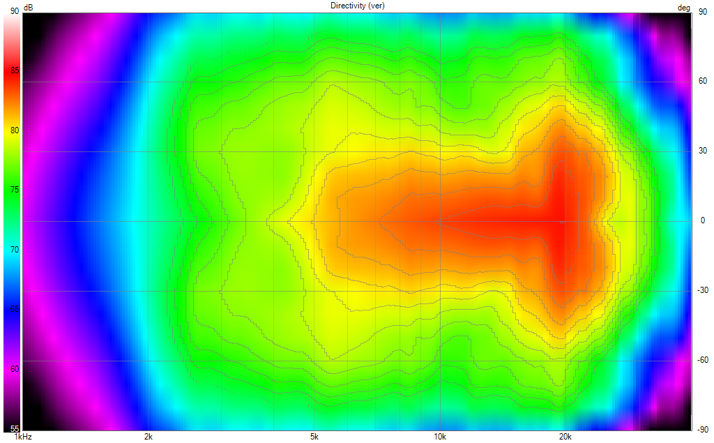

Controlled directivity.
Surprising?
Perhaps why the ribbon sounds good from 4KHz up?
The shape of the transition from mouth to flat baffle doesn't really lend itself to do much other than what mtg did in his design. The directivity is relatively narrow so baffle edge and shape effects don't dominate as much.

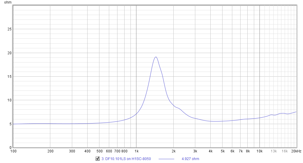

I'd always prefer the Faital HF108 on the Visaton WG10. The HF108 can inherently he crossed low, even under 1k with a steep slope and lower SPL I successfully ran one.
Celestion cdx1-1430 is another great one, but can't be crossed under 1.8k unless you don't listen too loud. The Alu diaphragm makes the top end sound smooth, lively and plenty of detail. It only has a 35mm VC, so it won't go as low as the others.
U have a soundclip of the hf108 coupled with the wg10 ?
Reactions: Wright
@mtg90 That impedance sweep on the Lavoce/ Celestion combo looks great. Thats the bottom line litmus test for any CD + WG. You don't want any bumps in the area above the primary Fs. The upper end behavior is equally important and shouldn't have a sharp elevated peak above rolloff. The only drawback to that Lavoce CD is the VC dia. It should translate into a higher upper end limit than most other CDs with 1.5 - 1.75" VCs.
