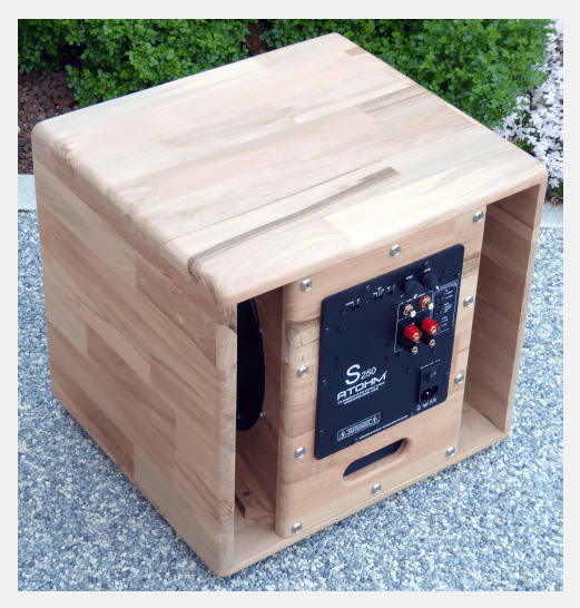

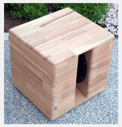

QTC under 0.707 already give very big enclosures... If you have the room to house such large size unit, well that's fine ! Unfortunately, I dont...
Then I solved the combined problem of place, tightness and infra-bass response by the Ripole solution subwoofer, in a 2x12" configuration, with a 400x400x440mm format and integrated Sub module :
But as usual, if you want to reproduce earthquake sounds at huge volume, you will need to go bigger...

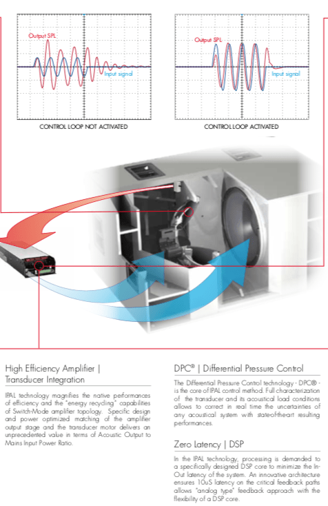

That said, Powersoft and B&C speakers already invested the R&D to develop the IPAL (Integrated Powered Adaptive Loudspeaker) system prior to 2011, and presented an AES paper explaining it.
https://www.audioclub.ro/cs-content/cs-docs/9844-1598281048.pdf
To keep it short, the IPAL creates a virtual transducer capable of self correcting the "fundamentally flawed" mechanical timing problems inherent with real transducers capable of large displacement volumes.
Although the IPAL system can largely eliminate the time domain problems associated both of transducers and cabinet/loading, it has not achieved widespread use, as users are not willing to pay the cost for those improvements, even though they demonstrably are far better .

It's a servo system with memory - motional feedback wrapped up in glossy language, and technology that has also been explored before. I have posted on this forum previously about David Birt's self-balancing bridge that is capable of extending the HF performance of conventional acoustic or optic motional feedback systems considerably: Sadly it has never achieved commercial success either.the IPAL creates a virtual transducer capable of self correcting the "fundamentally flawed" mechanical timing problems inherent with real transducers capable of large displacement volumes. [...] Although the IPAL system can largely eliminate the time domain problems associated both of transducers and cabinet/loading, it has not achieved widespread use, as users are not willing to pay the cost for those improvements, even though they demonstrably are far better

It looks like the Powersoft module is the very expensive part, the drivers are mid to expensive but not too far above mainstream driver pricing. A lot of driver manufacturers have now developed compatible drivers.I don't recall you defining a "required performance standard", but if your standard is 100% of people believing a HiFi is a real piano, big band or orchestra, it is simply unachievable other than in an artificially controlled environment.
Art
This is interesting " Features of the Powersoft IpalMod include a Class D amplifier (Max 8500W @ 1ohm / 180 Vpeak) which is designed to work with a load with very low impedance and high inductance, and a Differential Pressure Sensor (DPC) located on the speaker baffle which sends a Zero Latency (10 µs) closed loop reading to the special on-board DSP to change the power output and behavior of speaker/s. At the same time, the IpalMod recycles the Back Electro-Motive Force (BEMF) from the speaker/s into the capacitor bank of the power supply to significantly increase the output efficiency.
https://audioxpress.com/news/lavoce-launches-powersoft-ipalmod-compatible-18-and-21-subwoofers

And that is different from adaptive amplifier output impedance how exactly? As I remarked previously, this appears to be motional feedback with DSP added, and dressed up in flowery language. Analogue motional feedback has offered zero latency since its inception.This is interesting " Features of the Powersoft IpalMod include a Class D amplifier (Max 8500W @ 1ohm / 180 Vpeak) which is designed to work with a load with very low impedance and high inductance, and a Differential Pressure Sensor (DPC) located on the speaker baffle which sends a Zero Latency (10 µs) closed loop reading to the special on-board DSP to change the power output and behavior of speaker/s. At the same time, the IpalMod recycles the Back Electro-Motive Force (BEMF) from the speaker/s into the capacitor bank of the power supply to significantly increase the output efficiency.
