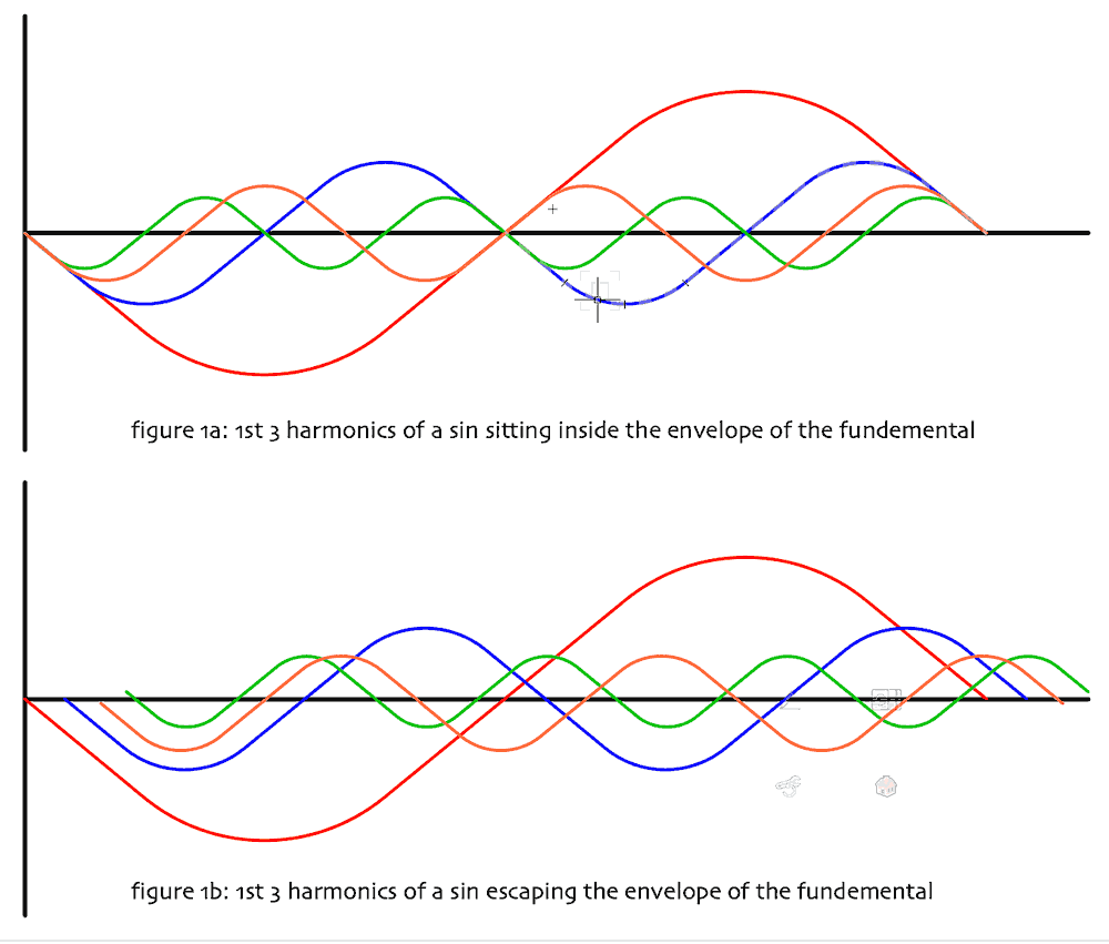

A trained ear can hear if harmonics have exited their envelope.
waveform-escaping-envelope-png.1020449

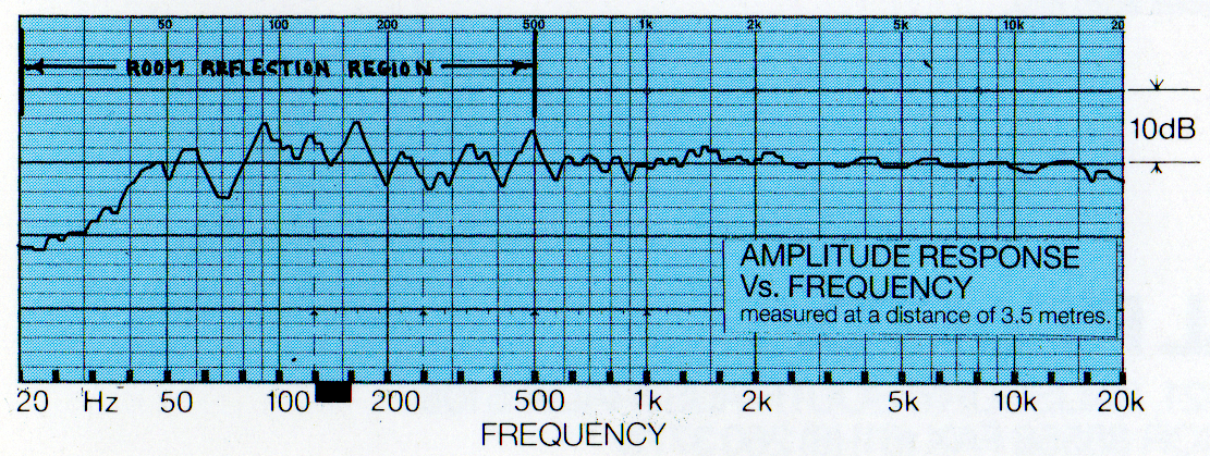

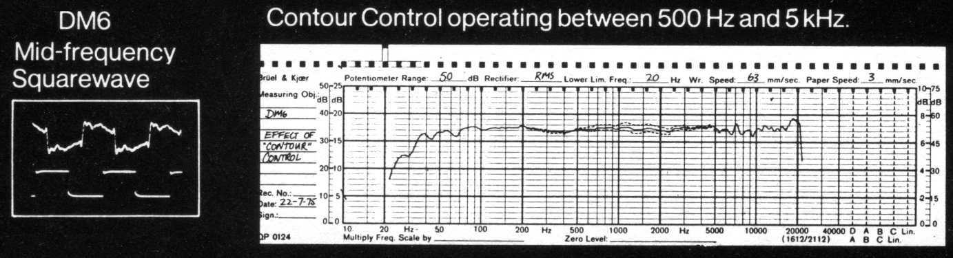

Consider the B&W DM6, which was a sealed three-way passive loudspeaker system produced in the 1970s. It had an excellent frequency response as well as time domain response. Those involved with the creation of this particular loudspeaker clearly had a few specific design features in mind, well prior to the discussions in the current thread. In the past, time-aligned loudspeakers were the subject of discussion in many magazine and journal articles.
When it comes to square waves, and frequency response, what the DM6 could produce is shown below.

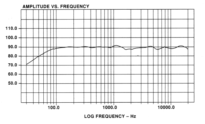

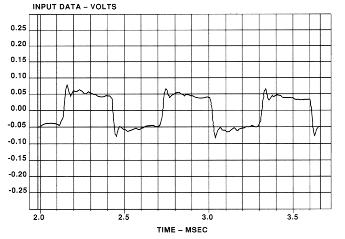

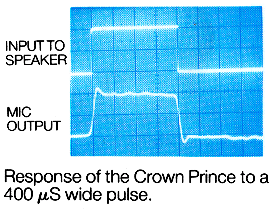

In comparison, a more modern design such as the Duntech Crown Prince loudspeaker could achieve excellent square wave reproduction, such as shown below. It also had a quite flat frequency response, unsurprisingly, which is a very important consideration when trying to attain high sound quality and good time-domain performance.
Then there is the Dunlavy SC-I monitor. Its square wave response and frequency response are shown below.

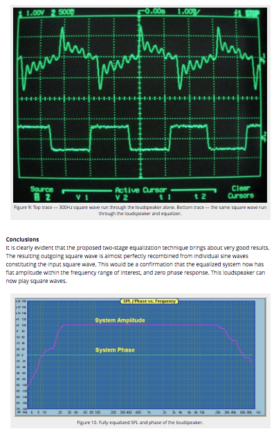

Now that relatively inexpensive computer processing power has reached the point where finite impulse response (FIR) filters can assist in reducing loudspeaker time domain issues, more incremental progress continues being made in that area, as shown in this 2018 article:
https://audioxpress.com/article/a-loudspeaker-that-can-play-square-waves

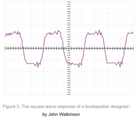

Clearly, much progress has been achieved in the time domain since John Watkinson designed this speaker:[
ATTACH type="full"]1271881[/ATTACH]
