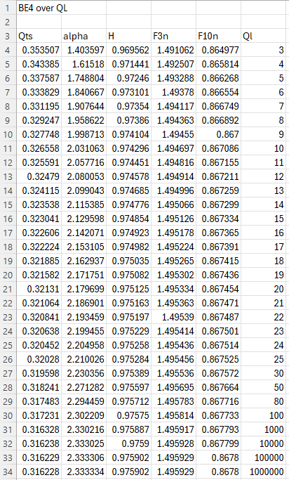

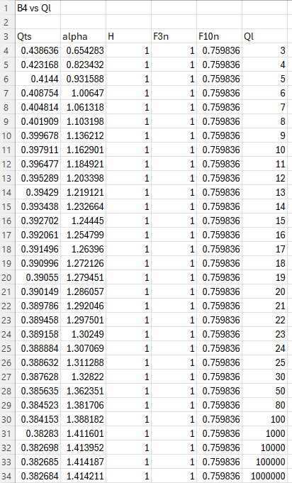

Bessel and Butterworth 4th order alignments
These alignments are talked about in the Loudspeaker design cookbook and described as "Discrete alignments" that basically wiork only for one Qts value for any given Ql or box loss factor. I computed the values of Qts, alpha=Vas/Vb, H=Fb/Fx, F3m=F3/Fs, F10n=F10/Fs for values of Ql from 3 to 1Million 😉 for both bessel and butterworth alignments.

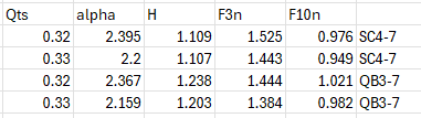

As a bonus, I compare the values given by QB3 and SC4 alignments for woofers with a Q of 0.32 - similar to a Bessel aligned woofer. FWIW, QB3 , SC4, and B4 alignments are all identical the B4 value of Qts.
The value of the Bessel alignment is that it has maximally flat delay and a lower F10 than either QB3 or SC4.

For Ql=7 as a comparison:
B4 is Qts=0.4, Vb=Vas/1.06, Fb=Fs, F3=Fs and F10=0.76*Fs
BE4 is Qts=0.33 Vb=Vas/1.9, Fb=0.97*Fs, F3=1.5*Fs and F10=0.87*Fs
SC4 is Qts=0.33 Vb=Vas/2.2, Fb=1.1*Fs, F3=1.4*Fs and F10=0.95*Fs
QB3 is Qts=0.33 Vb=Vas/2.2, Fb=1.2*Fs, F3=1.4*Fs and F10=0.98*Fs
Bessel has a bigger box, is tuned lower and rolls off slower than either SC4 or QB3 at the same Qts.
Bessel has maximally flat group delay.

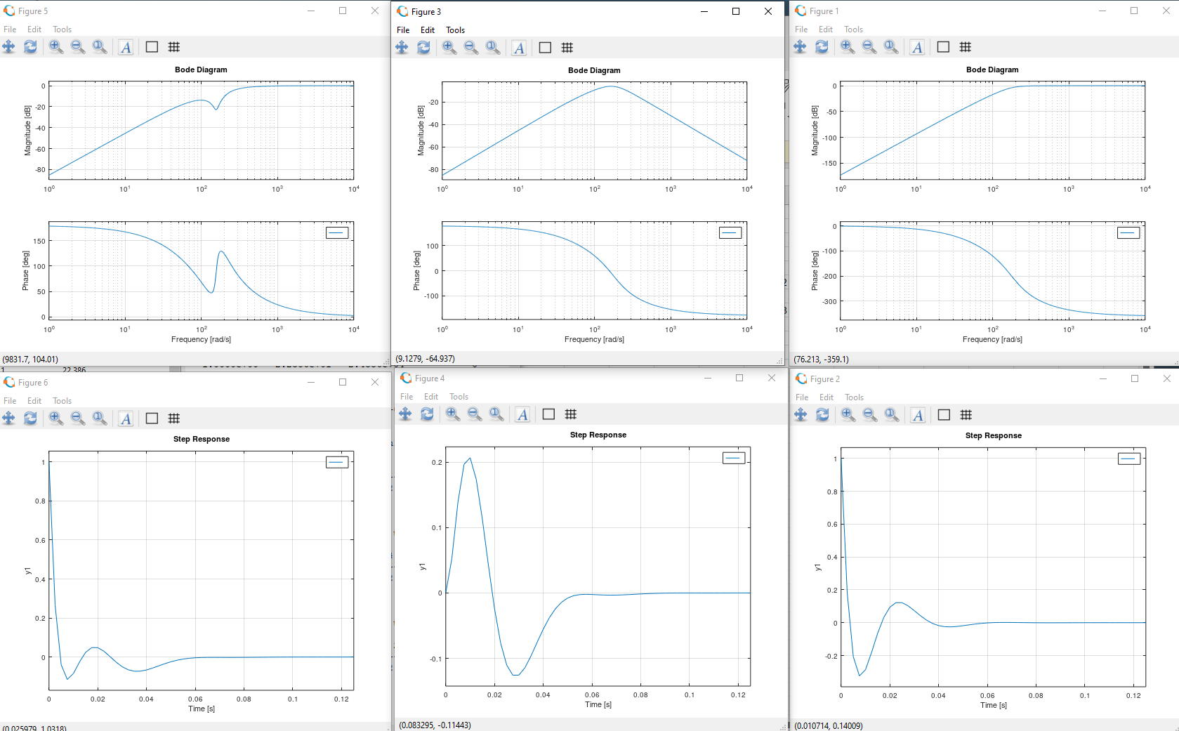

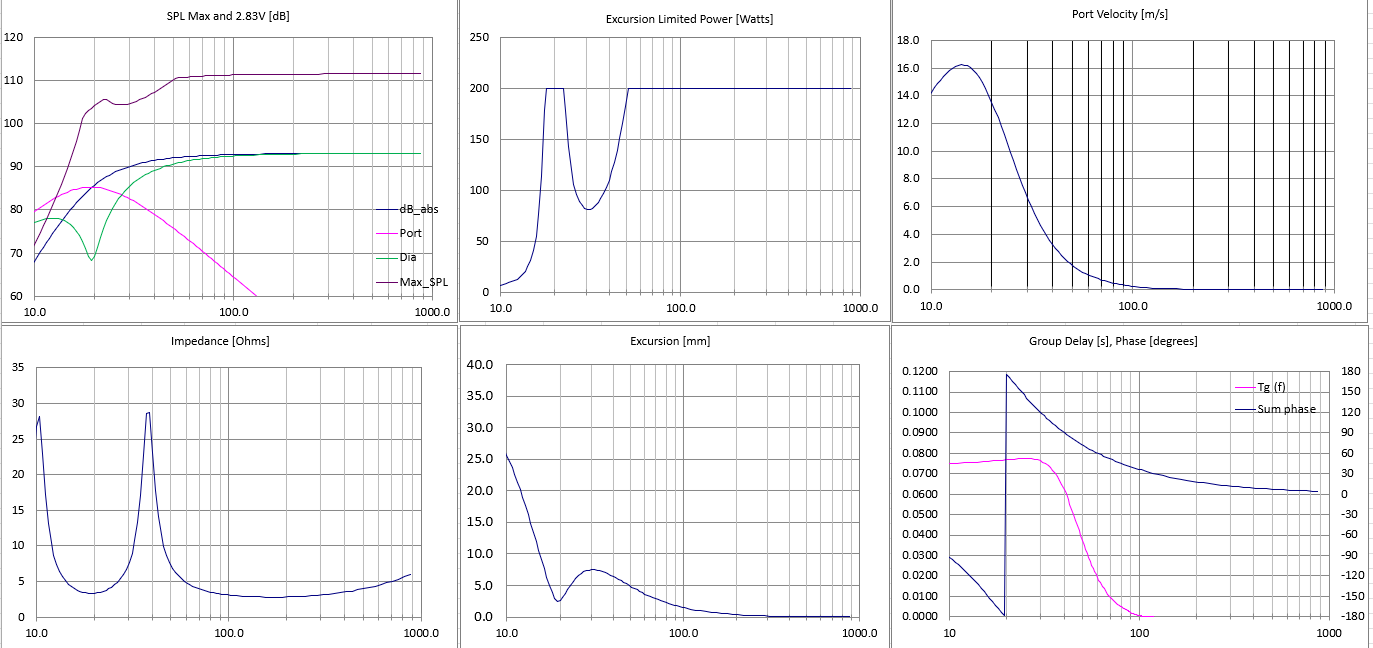

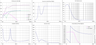

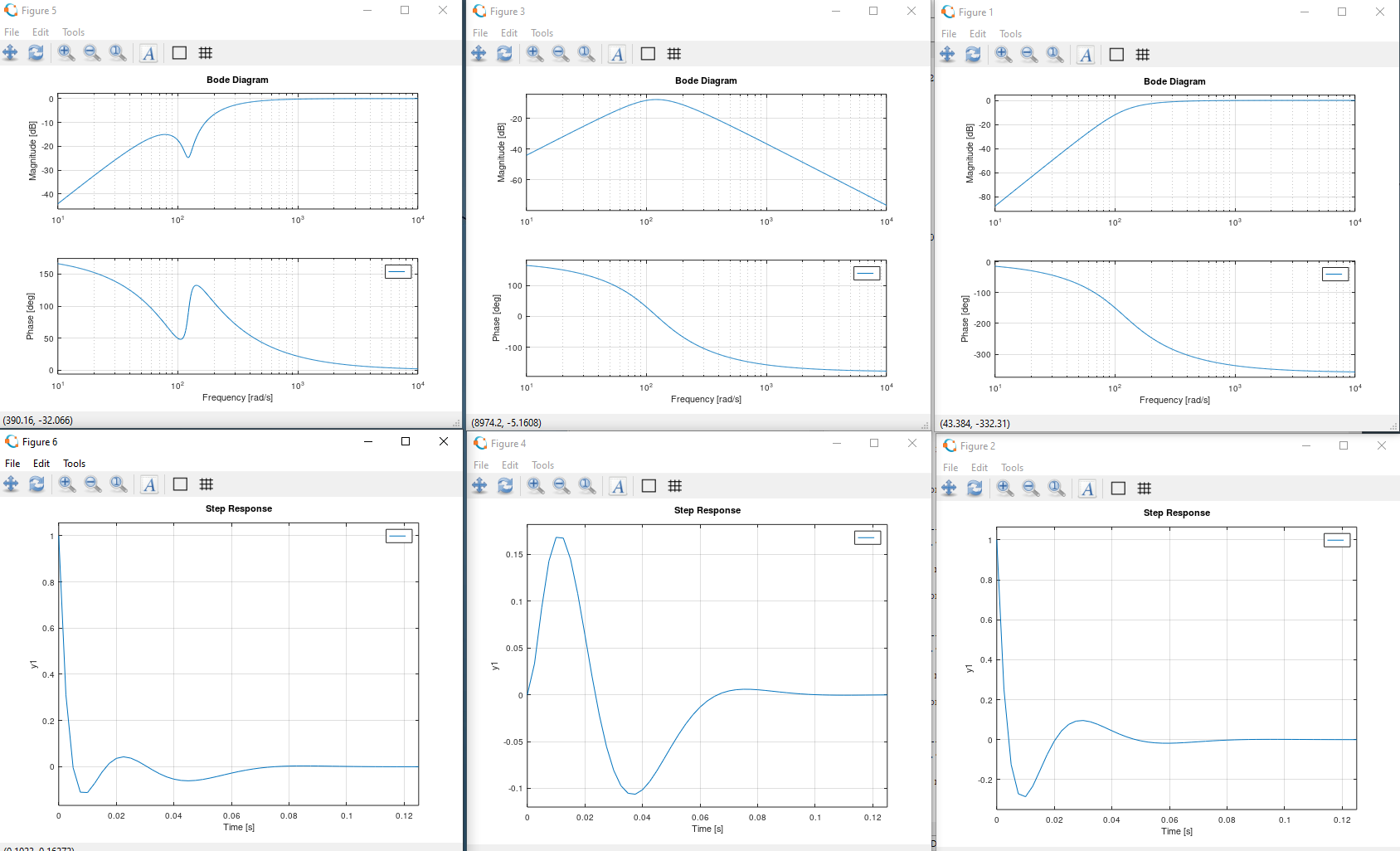

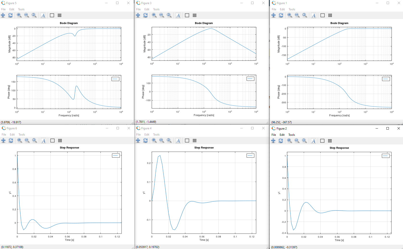

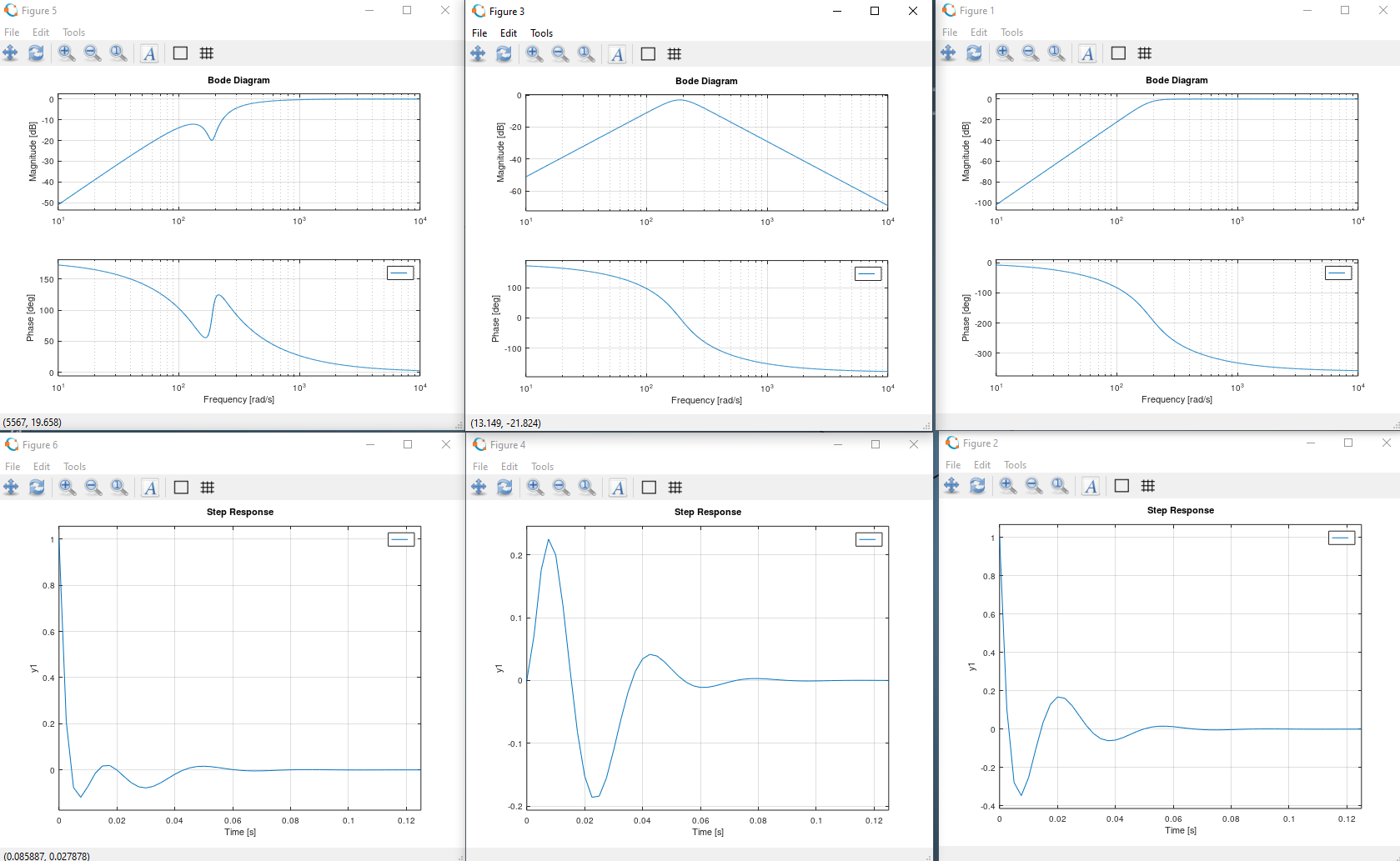

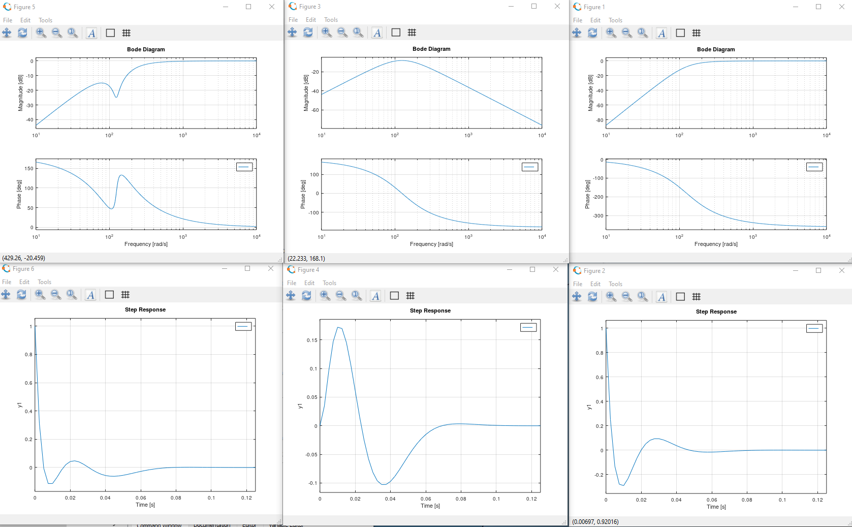

Here is some more simulation stuff on alignments: All of these have an F3 of 30Hz The B4 has a Qts of 0.4048, all of the other alignments used a Qts~0.33 to be comparable to the Bessel. Included are Butterworth4, Bessel4, QB3, SC4 and BB4 The component responses are from left to right, Diaphragm , port and summed (box) response. The top plot is the bode plot in radians per second 30cycles/sec*2*pi rad/cycle ~188 rad/s. The bottom plot is Step response. The Bessel and BB4 have smoother step response plots, and indeed are close in volume and tuning.

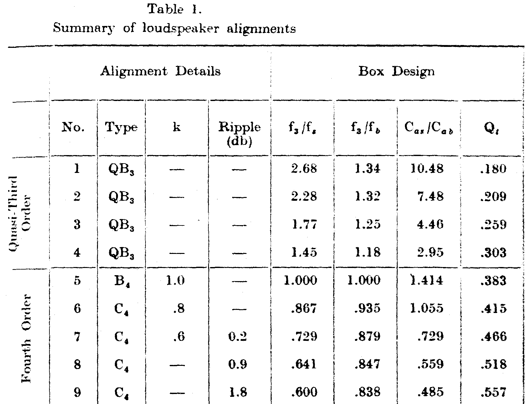

They were created by Thiele, Small & others at a time when there were no personal calculator or computer software available for flexible modelling. So they were in certain regards an advance over prior methods since the tabulated values provided in various papers & articles allowed builders to hit a consistent alignment -although Bullock for one always advocated oversizing enclosures by at least 10% & sometimes up to 25% to account for variations in real-world driver parameters -most commonly suspension compliance. Not a lot changes in that regard... 😉
The 'discrete alignments' like B4 were actually the first to be worked up, only afterward followed by the more flexible QB3 etc., since they're mathematally simpler requiring a fixed Qt value to be achieved (remember the object of the original papers was to present the theory & underlying maths rather than a freeform design method as such).

They are mathematical abstractions. Butterworth 4th order is Maximally Flat amplitude response, Bessel 4th order is maximally flat delay. Both can be arrived at by minimizing or maximising a particular response function. C4 is Chebychev 4th order, which has an equal ripple response characteristic and SC4 is an extension of that for low Q drivers. QB3 is a quasi 3rd order alignment which happens to have the lowest cutoff relative to box size of all of these alignments. BB4 (attributed to Hoge) is a very simple function alpha=1/4*(1/Qts-1/Ql) (Thanks Claus!) and Fb=Fs. Because the tuning tends to be lower than other alignments, it tends to have a better step response, but it rolls off early with low Q drivers.
All of these alignments still have considerable merit today as starting points in design, but there is no reason to slavishly stick to them as recommended in older texts. Basically there are two degrees of freedom in a vented box system, Box volume and tuning frequency. You can select Fb from maybe 1/2 to 2x the Fs and Box volume from perhaps 1/3 to 3X the Vas (just to pick some numbers) and the alignments I have shown are only a few points in that 2D space. There is a lot more freedom in design, but you may find that the areas with acceptable response tend to be near the alignments that people say are now "useless".
