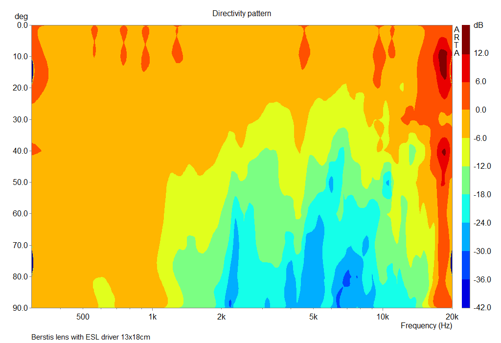

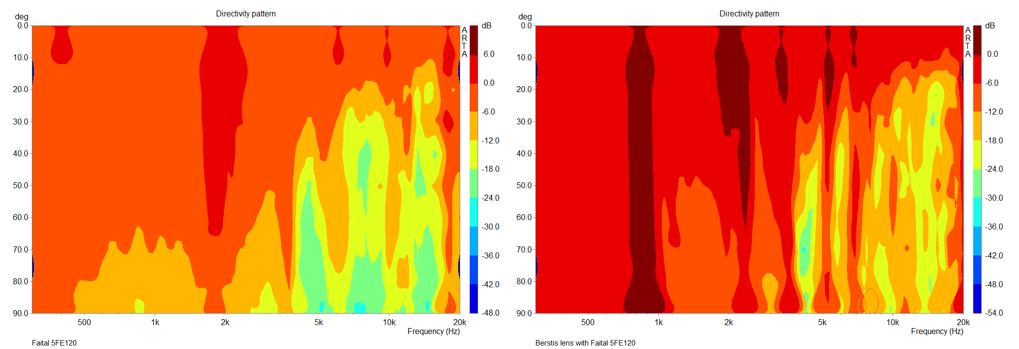

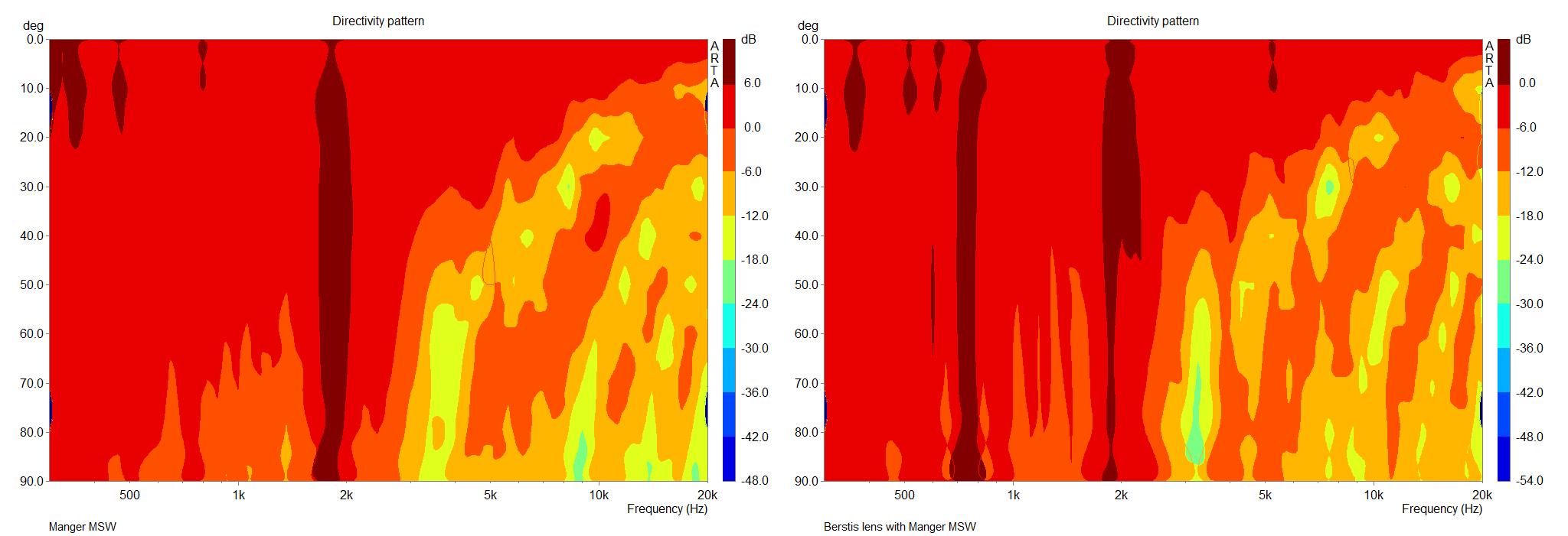

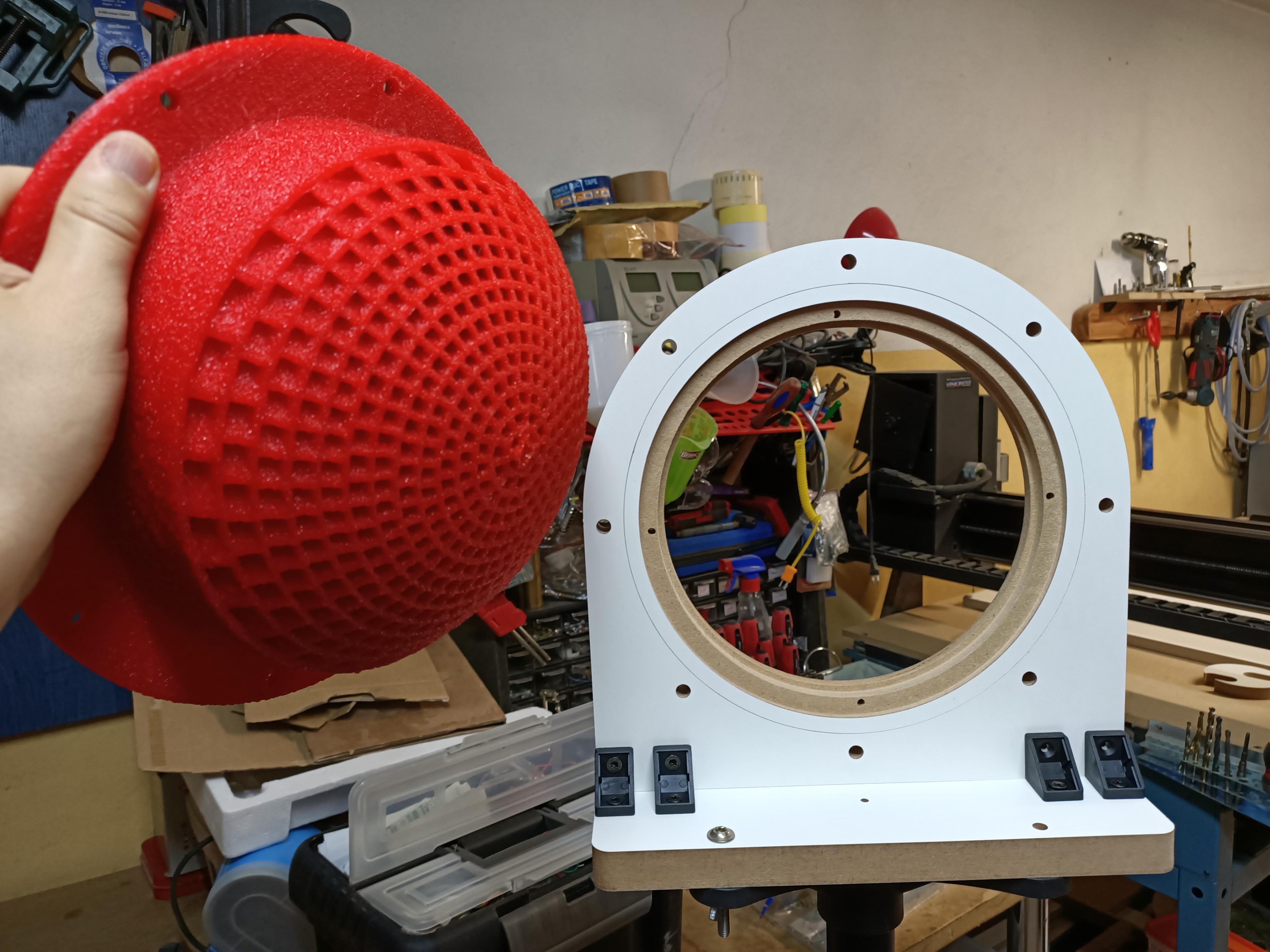

Berstis lens with various drivers:
- Manger MSW
- Beyma 10MCF400Nd as in Berstis' article
- Faital 5FE120
- ESL 13x18cm
- Berstis Lens
