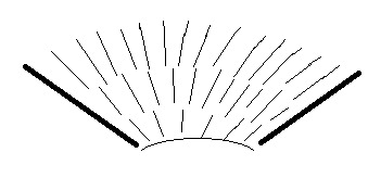

Could there be acoustic low-pass in the lens as well to reduce resonances?:)
In a horn, the volume of air between the diaphragm and the horn throat acts as a low pass filter. That's why the phase plug on a compression driver is so close to the diaphragm, to minimize that low pass filter.
Same thing happens here.
That's also why I use those slot shaped taps on my Unity horn projects, I do that to make the area constant, also to minimize the low pass effect.
TLDR: the answer to your question is "yes" :)
Now, the thing that's *really* interesting here, is that it can obviously be reversed: you could design a lens that takes a *spherical* wavefront - like a tweeter - and turns it into a *planar* wavefront - like a ribbon. You could also vary the pathlengths to get a diverging or converging wavefront.
Meyer Sound do something similar to what you propose here with their Ribbon Emulation Manifold:

I didn't find the published paper about it (if there is one), but from looking at the photo, it appears to be just like one outside row of my acoustic lens with a longer delay path and with a hole in the center. I think the idea is that the outside ring delays to sound wave enough so it can destructively interfere with the wave coming straight through the center hole. This would mean that it only works at certain frequencies and therefore not useful for absorbing sound inside a speaker cabinet, for example.
Of course this principle has been tried many times before, as alluded to in previous posts.
Always the problem has been with the resonant cavity such a large amount material in the "speaker grille", results in.
Perhaps that could be helped a lot by bringing the whole structure a lot closer to the diaphragm. Millimeters is my guess to be sure, just above x-max.
In fact you could almost turn the whole thing around and put the protruding part inside the concave cone of the diaphragm.
Also, even dispersion of most frequencies in the vertical, is usually not needed or even wanted.
if you only needed dispersion horizontally, it would take us right back to the old slanted plate lens.

Yes it's exactly the same principle. And it doesn't necessarily have anything to do with horns.
How about using this way of bending the sound to match the exit of our compression drivers to almost any horn entry angle imaginable.
Take the BMS 4550 for example, it has a 14 degree exit and from what I read it produces almost a plane wave at the exit.
Feels like the perfect candidate for experimentation if we can make the channels small enough to not introduce to much of a negative effect on the highest frequencies.
