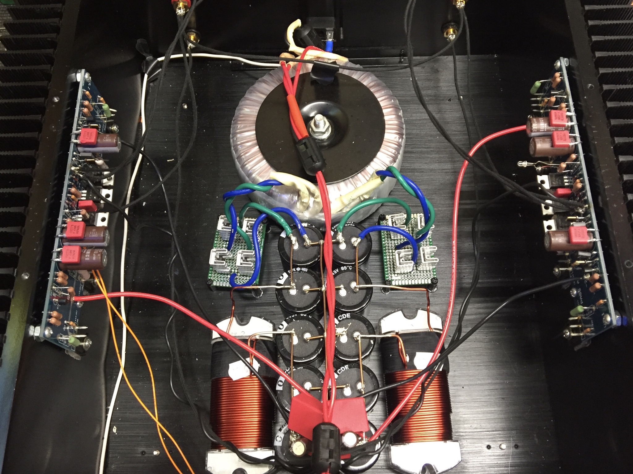

I've built a set of Aleph 3 amps, each with a CLC power supply. I've got 44000uf + 2.2mH (0.28ohm) + 66000uf on each rail. I'm considering upping the inductance to 3.9hH (.150ohm) - 6.8mH(.250ohm). I'll looking at erse 14ga inductors. Would I get any benefit from this?
Thank you for the feedback. I ended up replacing the inductors anyway and I’m glad I did. The plastic was starting to melt and the inductors were deforming. I went with a larger gauge (14awg), larger inductance (10mH) and lower resistance (.250ohms) inductor. Upon initial listening, the background noise is audibly less. I can no longer hear anything from my seat when they are on. I wish I would have measured the before and after ripple.
