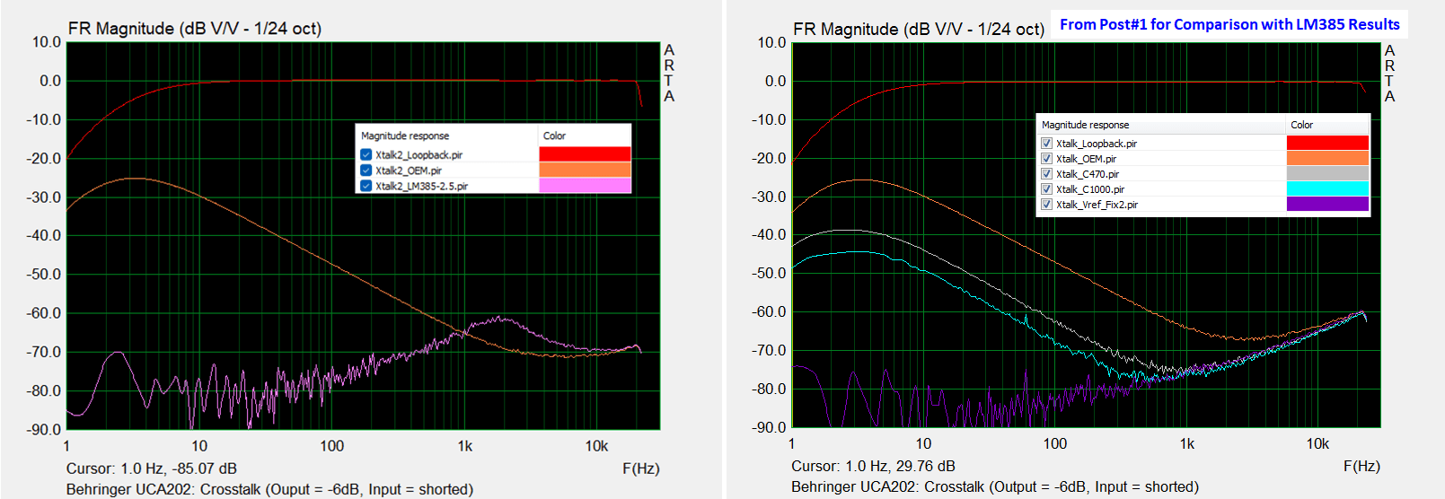

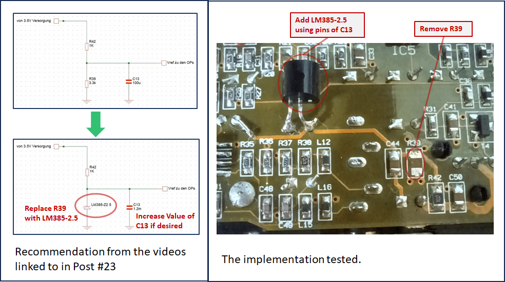

I did go ahead and give the LM385-2.5 modification a try just to see how its cross-talk performance would compare with using a completely separate reference voltage for the input opamp as was done in Post #1. Here is the circuit modification recommendations from the videos(screen captures) linked in Post #23. Basically, just replace R39 with the LM385-2.5 voltage reference(see attached datasheet) and increasing C13 value if needed.
The result is substantial improvement at low frequencies, but a slight hump of deterioration centered around 2kHz.
This would indicate an increase in output impedance of the voltage reference in this frequency range.
I tried increasing C13 to 1000uF, but it had no effect on the results.
So, not quite as good as the separate reference voltage, but certainly good enough for impedance measurements.
And as a bonus, you can retain the monitor switch functionality if that is important to you.
