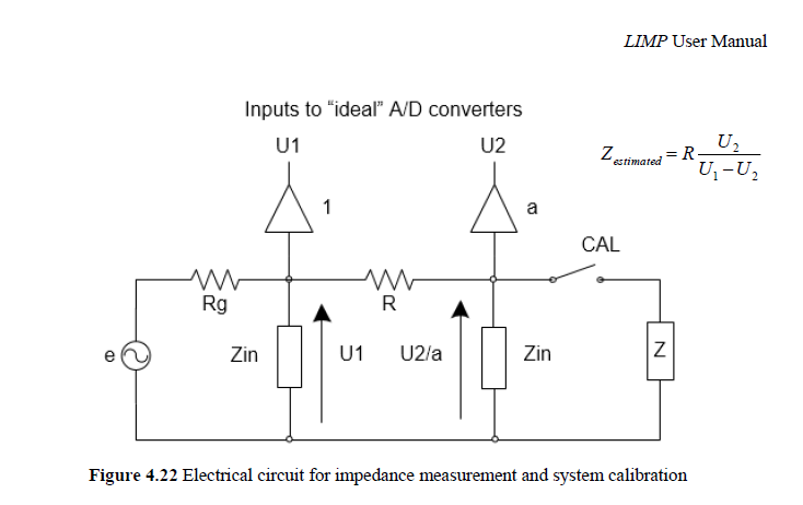

Your OUTPUT Z is not low. The amplifier output is jack is driven by 100 ohms and 10uf, so the #1 graph is not a surprise to me. 100 Ohms & 10uf = 150 Hz
Applying both fixes would reduce the LF crosstalk between the Left and Right outputs at low frequencies. This might be beneficial on paper, but probably not in the real world for listening to music where channel separation requirements at LF is not general an issue. If you are just using the UCA202 for a measurement system, I can’t think if any benefit since measurements systems output the same signal to both channels. No harm in it though. Another option I never investigated was to see if crosstalk remained low if the PCM2902 voltage reference was used for all the op amps like shown in the schematic of the TI demo board.Is there any benefit from applying both fixes?
Refer to the attached impedance measurement setup. The output impedance of the source (Rg) does not affect results for a 2-probe impedance measurement setup. The issue is that crosstalk is sending a portion of the signal source(e) directly to the inputs (U1), (U2) bypassing the source and reference resistances (Rg) and (R). Since input (U2) will always be lower in magnitude than (U1) it becomes proportionally more and more contaminated at low frequencies from crosstalk with increasing reference resistor value (R). This is what Attachment #1 was illustrating.Your OUTPUT Z is not low. The amplifier output is jack is driven by 100 ohms and 10uf, so the #1 graph is not a surprise to me. 100 Ohms & 10uf = 150 Hz
You can see in Attachment #5 of the original post(green curve), that once the crosstalk is removed the resistance is properly measured at low frequency even with high output impedance.

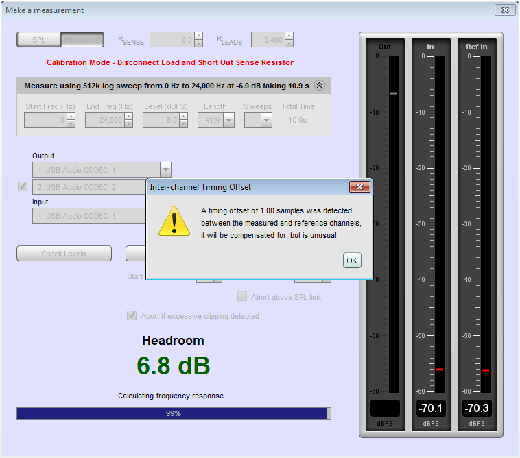

Regarding the phase shift at high frequencies: This results from the 1 sample timing difference between the inputs of the PCM2902. (see attached Errata sheet Section 2.2) As you saw in my measurements, Calibration in ARTA (or REW) takes care of the resulting phase shift. I just noticed recently that REW even identifies the 1 sample timing difference in a pop-up window during calibration.

Thanks! I was using ARTA -the free version- at that time and although I did calibrate as always I don't recall to have encountered that issue. I'll have a look again. Thanks a lot!
