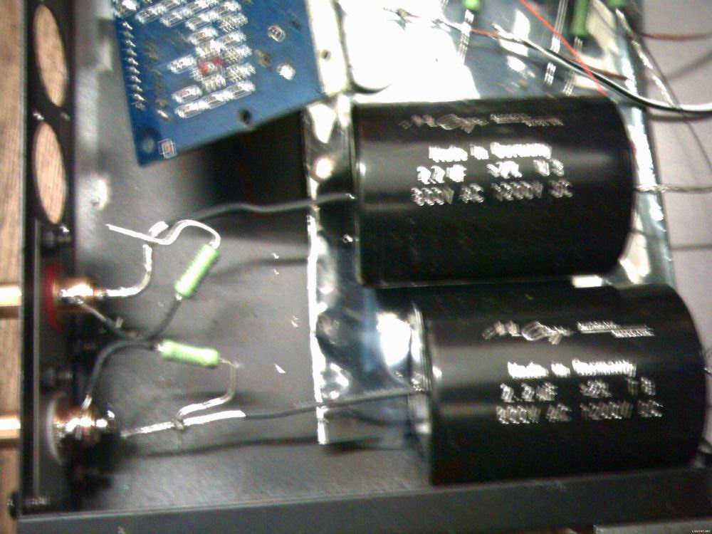

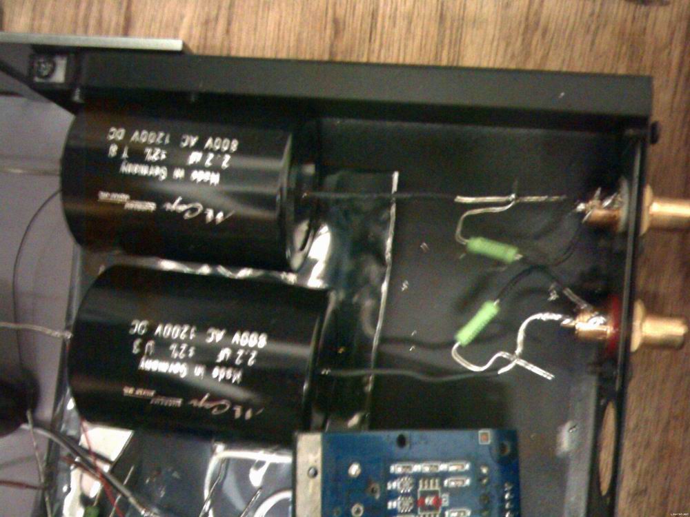

highest level of modification with tube.. improve based on Dr.Lampizator..
Check my high end setup!
lol. the picture of modding is not mine. currently my dac is still under progress to a to a highest level of modification as possible. instead of analogue stage, digital input will be tweaked with rare blackgate caps.
First main power is using Phillips Ultrafast diode for dc rectification. A new dedicated 60va transformer for digital and CLOCK . As well as the digital power, a higher capacitance of blackgate standard 16v/4700uf will be replace too. then replace dirty 7805 with lm2940 with blackgate FK 16v/470uf smoothing. some digital filter or other caps will be replaced with blackgate FK 16/47uf instead of ciplak 25v/10uf. hehe..... cool huh..
For the digital signal input, extra dedicated SwitchCraft RCA socket for coaxial. Bypassing the dirty multiplexer where significantly improve the quality of digital signal from Transport.
Digital section last stage improvement mod, replace the clcok with LCaudio LCLOCK XO3 because it has two output of the same frequency. Where my transport has the same too!!! this would compensate the greatest advantage to sound accuracy. Next, LCLOCK became the house clock in entire digital transmission. the clock with dedicated power supply CLCLC design, same Hexfred 19ns(trr) dc rectification with Nippon chemicon KMH 35v/8200uf caps. Moreover, the clock itself will be fully added blackgate decoupling capacitor.
For the analogue Output, 50va transformer for tube power. same, hexfred for dc rectification. tube power filtering with CLC design, Obbligato Film Oil cap for front and back stage then Nippon chemicon electrolitic KMH for middle stage. resistor for tube circuit will be using Kiwame although my fren told me it sucks.. anyway let see and listen then only decide wat to change again loh.. Legendary Russian OTK grade 6H6P for the tube. then output coupling capacitor with Mundorf Silver oil 2.2uf till special ETi RCA gold plated socket.
Picture of my mods will be posted when the dac is done.. and i will keep u update.. thanks for ur interest.

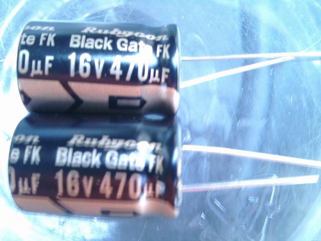

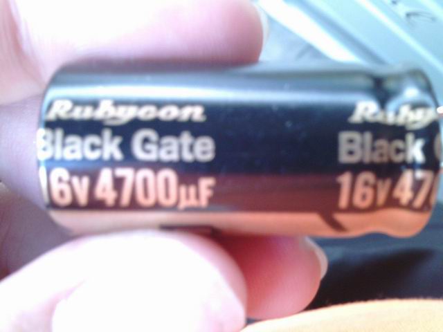

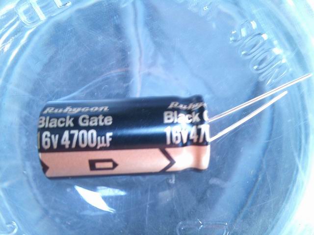

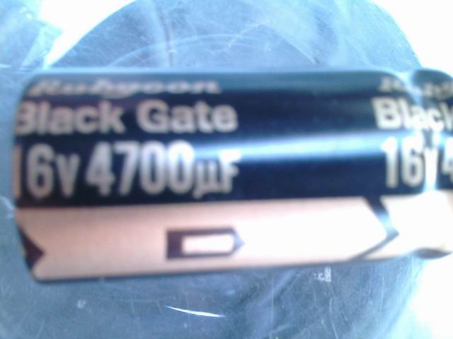

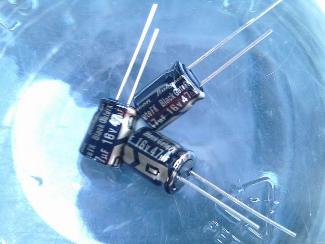

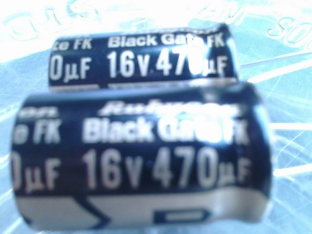

latest mod progress for tube output.
now.. blackgates just arrived on hand..
