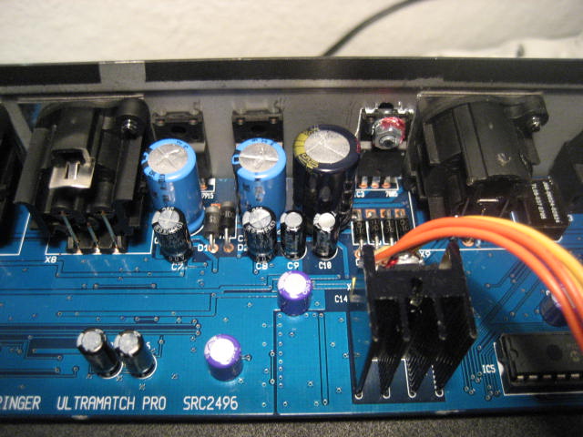

Analog PSU and Transformer hum
I did some basic mods (PSU caps, diodes, digital decoupling...) and found that the worst part of the SRC is the cheap transformer. It vibrates and hums noticeably with the upper case lid acting as a resonator. So I thought let's replace the thing but unfortunately I don't understand the circuit: The analog PSU (+-26V and after Reg +-15V) is fed via two diodes only (between the two blue Philips caps) and the transformer does not seem to have a center tap. There are only two secondaries one with 22V (analog?) and 12V (digital?). I just don't get it how they can create a symmetric 26V out of one 22V secondary with just two diodes.
The digital supply looks like I have expected, 12V secondary full wave bridge with four diodes.
So is there a schematic out there helping me to understand the PSU? A new transformer with new rectifier and reservoir caps is probably the best solution, there is enough space.
