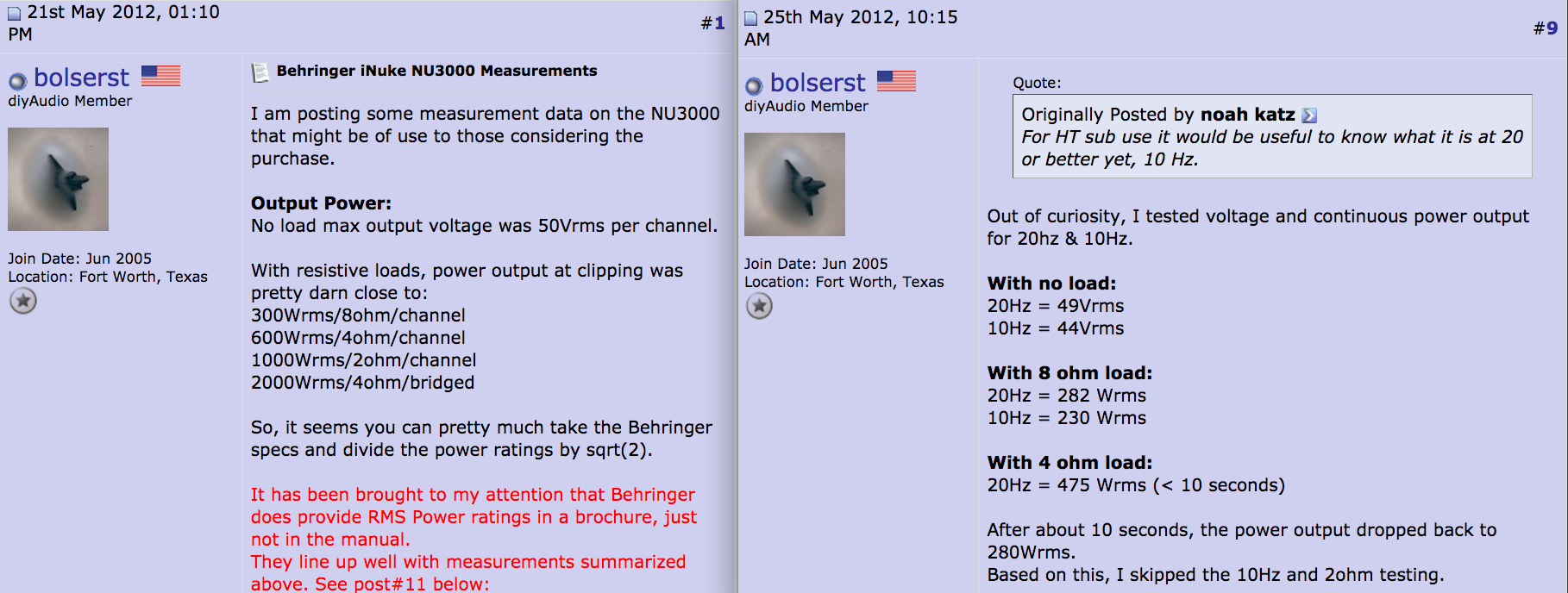

Hi Art,
I'm just drawing my conclusions based on the continuous power test done on the NX3000 at 20Hz, that I posted earlier in this thread.
The measurement shows that the amp could put out only 268W into 4R stereo at 20Hz. Might be closer to 300W for 1% THD. I think you can see how I drew my conclusions about the 2R performance.
I would put more confidence in an actual test of the NX3000 over running part of the NU4-6000, which likely has a beefier PS so that it can support twice the number of channels. I would be interested in seeing how the NU3000 does into 2R/4R when only one of its channels is used, since the PS only has to run one channel and power is likely higher.
I'm just drawing my conclusions based on the continuous power test done on the NX3000 at 20Hz that I posted earlier in this thread.
Trying to reconcile differences in conclusions, ran across bolserst's NU3000 tests:
Behringer iNuke NU3000 Measurements
Although his NU3000 tests indicate power of near 2000Watts 4 ohm bridged mono, a single side driven at 20Hz into 4 ohms power dropped to 280W after about 10 seconds, very similar output to the NX3000 result you posted earlier in this thread.
Having done no "full power" tests below 30Hz on the NU4-6000, had not run into what appears to be current limiting brought on by <30Hz frequency content in the NU3000/NX3000 tests.
In light of the above, I'll revise my estimate to "a bridged NU-3000 (or NX3000) may be capable of in the range of 1800 watts into 4 ohms above 30 Hz for several seconds".
Having burnt voice coils in just "several seconds" of testing, just wanted to put that out there ;^).
Art
Art
Wow, that's very interesting. That is a pretty steep difference in continuous power output between 20Hz and e.g. 40Hz! Thanks for posting the link to the measurements by bolserst. I hadn't seen it. Also, sorry to hear about your experience with a voice coil and the magic smoke! Ouch.
There are EDM tracks with sustained low frequency (<100Hz) with the similar crest factor (3dB) as sine waves, some even less.
Whether that is "actual music" is another discussion, but there is plenty of it out there, ready to smoke voice coils if long term RMS limiters are not set low enough.
