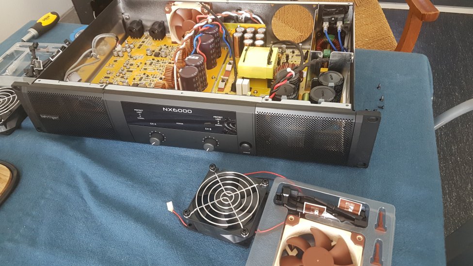

2 years experience with the amp employed as work horse for my 4 x 21":
I installed Noctua NF-A8 FLX fans in my NX6000.
(Use black and red cable, disregard the yellow one).
No fan noise, (medium speed setting) but you need to inspect for dust collection due to airflow thru the amp.
No amp hiss experienced either.
https://www.amazon.com/Noctua-NF-A8-FLX-Premium-Quiet/dp/B00NEMG9K6
