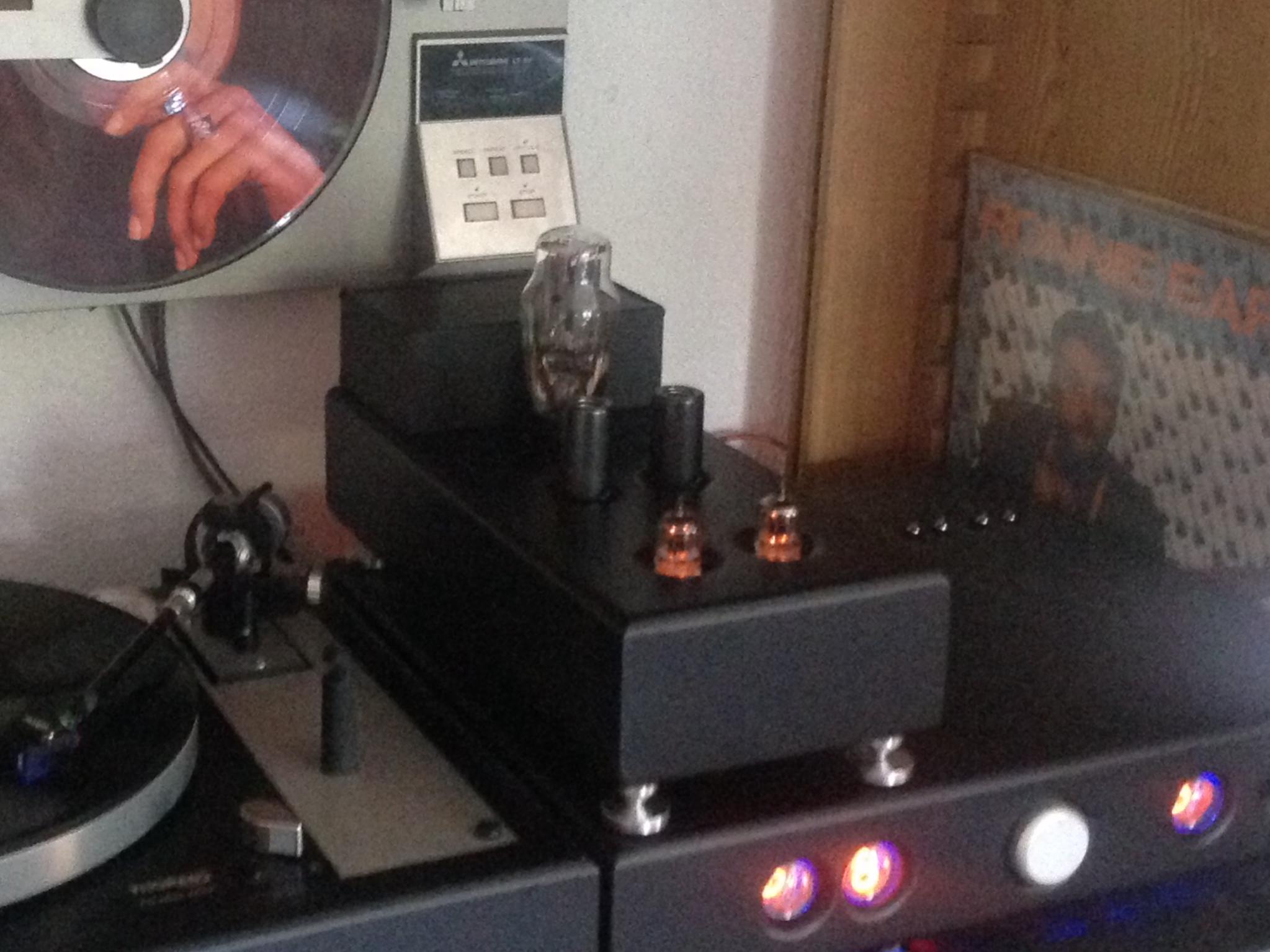

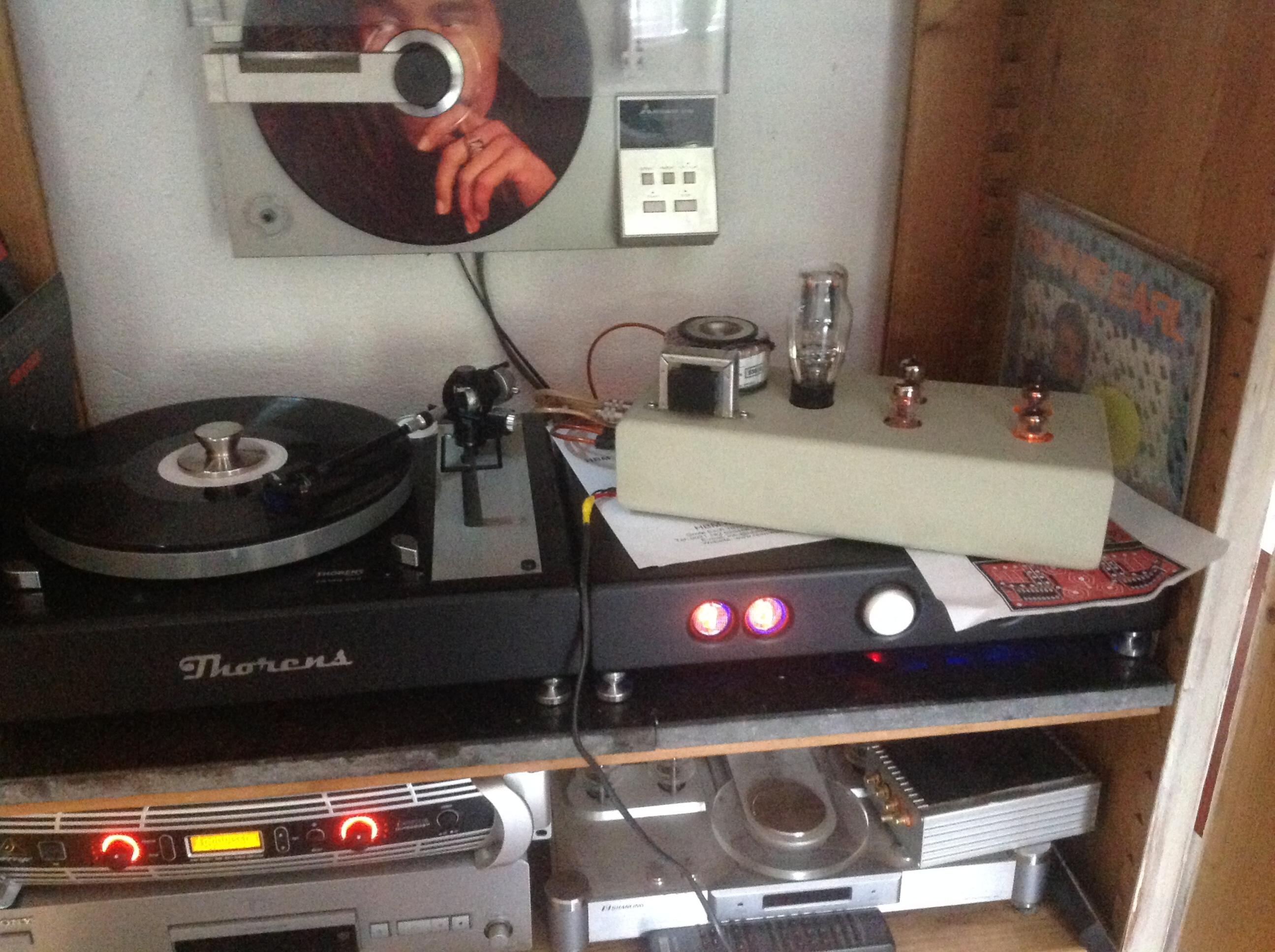

It is a phono preamp called phonodude.I'm curious about the SET I see there ..... is it a 2A3?
See link below:
Phonodude koifarm edition
As main amp i use SE FU13 tubeamp

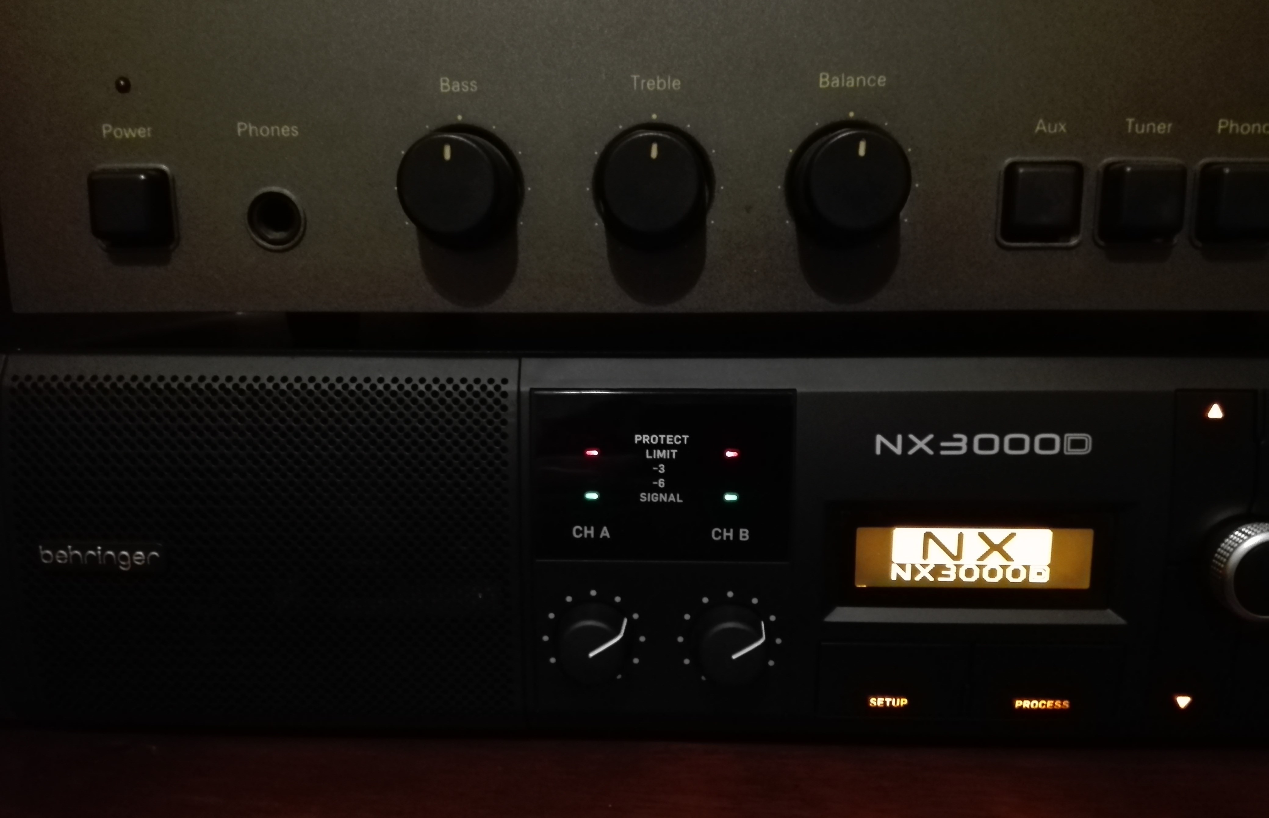

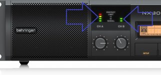

Well here I am, I bought the NX3000D and I'm already sorry, and not just because of the loud fan noise .......
From the first time I turned it on I noticed strange behavior in the signal indicator LEDs.
Some never turn on! Check out the photos of Bheringer and my amp.
In my case, it only turns on the green light at the bottom and the red light at the top.
The intermediate lights do not act at any time, (- 6 Db green and - 3Db yellow) I have tried varying the input signal with different voltage sources, but it does not make any difference.
No matter where the knobs are located, only the lower green light will turn on, and without intermediate steps, the upper red limit light ...
I wrote to Bheringer for technical support and they replied that "this is normal". That simple ....🙄
So why are they on the amp ? 😀
I have written again to ask for an explanation
more detailed and technical as possible. But while I wait for their response, I would like to know the opinions of the users of the NX series here.
What am I not understanding ? 😱

they are protect level leds not signal.
Chanfe the protect level in setup.
