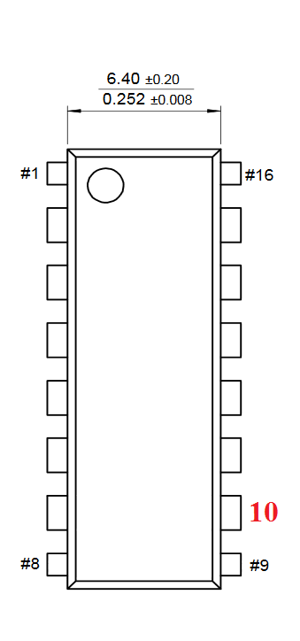

When shutoff the smps is shutoff and you need to power off and on the amp.
There is a IC KA3525A smps controller on board witch get a shutoff signal on pin 10 from a NE555. What i did is cut pin 10 from the KA3525A loose from the PCB. Now is the smps always on. After this the amp played the whole evening without shutoff.
All usual suspect Diodes and Transistors on my unit measured seemingly fine so I tried the "cut Pin 10"-Method. In fact I desoldere the pin from the backside and just bent it upwards so the deactivation is reversible.
What can I say: I seems to work.
Thanks for the hint, even if it probably connot be regards as a proper repair

I know this is not the best solution. But behringer does not supply schematics for service and they already stated that the shutoff detection circuit has problems caused by bad diodes. I did this mod just between soundcheck and show. After the show i dumped the amp in the garbage.
Its a bit sad an amplifier commonly develops bad diodes.
So its either cheap and nasty diodes or a design flaw.

I had a dead inuke6000dsp - 2 red rings. I tried this fix and one of the channels is fixed. The other channel still has the red ring and no sound, but the fixed channel is happily pumping out sound now. Thx very much for this !!!
Any advise for getting the other channel fixed ?
Just wanted to thank Koifarm for this tip.
I have the inuke NU6000DSP in my home heather since 2016 with no problems, then suddenly got the red ring shutoff problem in October 2021. I could find neither a replacement NU nor the newer NX anywhere for sale except at ridiculous markups.
I cut the #10 pin and it works again. I think only the first channel works as somebody else mentioned, but that's the only one I need, and now I have time to find a replacement amp when availability and prices get back to normal.
