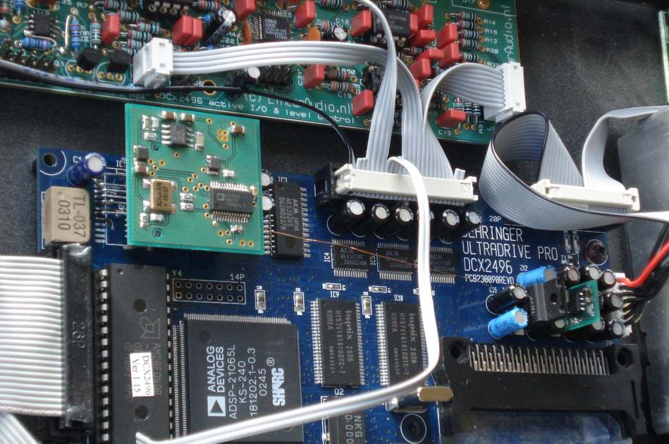

Finally found some time to mount the DSP board with Frank's digital input board and the low-noise replacement regulator. The output board is my own active output / level control board, but in RCA version.
My first impression is that this is another step up in sound quality. Not a difference of day and night, but definitely there. The highs are even more clear and, how shall I say, as if cut out with a sharp knife (sorry, I don't know how else to say this). It's sharp and in focus yet not shrill or tiring. Not much difference in the lows I can hear (which was pretty good to begin with!). But there are also imprevements in the mid range. More quiet, more easy, less stress. I have tried several replacement clocks in this unit but this mod is the best I have tried and will stay in! And absolutely no noise from the speakers, even close up.
This was the 2nd DCX I have, which had some intermittent problems with the CS8420 (loss of highs). I'm happy now that these problems are all gone, that alone was worth it.
Summary: a great mod for a very reasonable price, well done Frank!
Pic: the replacement board on the DSP board, the low-noise reg can just be seen at the right behind the existing other reg.
Jan Didden

Hi Jan,
I'm glad to hear that's not only me who is able to hear some improvement and that it's not all placebo :clown:
I was afraid that after Vladimirs threads expectations are too high. It’s not a miracle mod, but based on my personal experience it’s the most valuable after the output mod.
I hate audiophile talking and it’s very hard for me to find the right wording because it’s not my mother tongue. My impression is that frequencies become more accurate. It’s like some sonical mud has gone and you can hear in between. Might be Jan is right that this is true primarily for the highs and mids but I can also hear clear difference when someone e.g. is hitting a base drum. That’s because a base drum is not only a 20Hz signal but a mixture of various frequencies. So my feeling is that even these kind of lows become more realistic. Due to better accuracy also stereo imaging seems to get better. You don’t hear two speakers playing different things but e.g. one voice in the mid between. When listening to music unconscious I sometimes lift my head because I heard a detail which my brain obviously hasn’t heard before. But as already said it’s not a miracle mod.

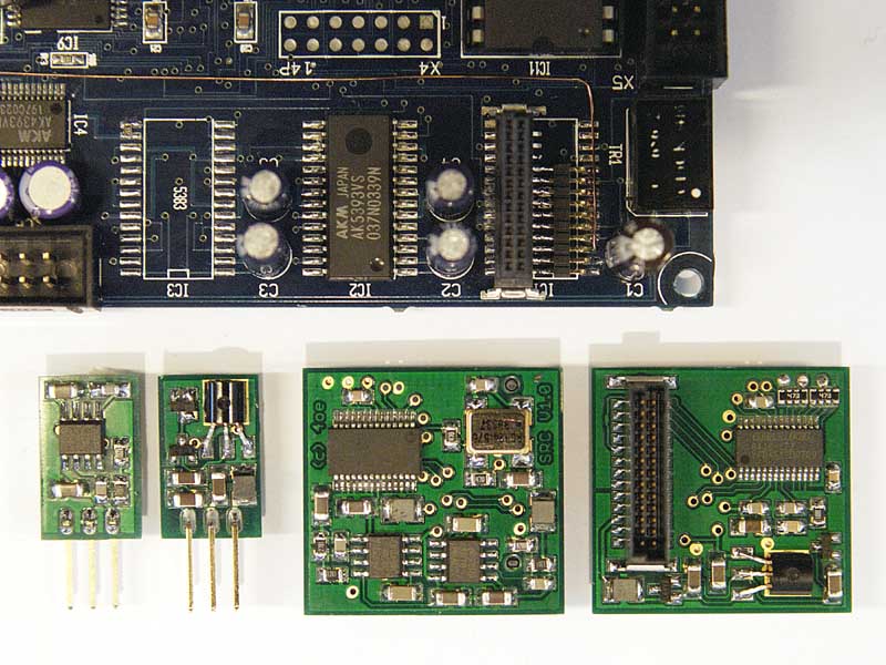

Hi all,
Due to further request I decided to make a final V1.0 version and to produce some more PCBs for the SRC/clock and 5Vreg mods.
I implemented some minor improvements and shrunk the PCB to about ¾ of the previous size.
To simplify installation the single wires for the SMD connector are replaced by only one pin header.
The SRC/clock mod includes the following mods plus improved power supplies (2++ in 1 mod).
Main features are: 1. Fixed problems of CS8420 (dull sound), 2. Improved 2nd generation SRC and 3. Low jitter (0.5ps) synchronous master clock (for DACs, DSP, SRC and PLL).
http://freerider.dyndns.org/anlage/Behringer-Input-Stage-E.htm
http://www.dcx2496.fr/upsamp.php
http://www.tentlabs.com/Components/XO/index.html
http://www.dcx2496.fr/selectro3.php
The 5Vreg mod is a high PSRR (>>100dB@10Hz-100kHz) and low noise (18µV) voltage regulator for the DAC and ADC devices which replaces the on-board 7805 regulators (IC7:ADCs and IC8😀ACs).
The picture shows DCX-DSP board (blue) with SMD connector (and pin header) assembled instead of CS8420. You also see two SRC/clock PCBs and two 5Vreg PCBs (both sides each).
Frank
