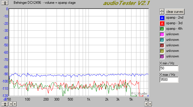

Hi Ergo.
does that 680r filter with flattish distortion vs frequency slope compare to the rising distortion plot shown earlier when using the 33r filter?
AndrewT,
I chose the 680 ohm as the data sheet specifies the lowest acceptable AC load to be 600 ohm. I have not tried 33 ohm but I do suspect that that is what caused the rising distortion figure on that graph.

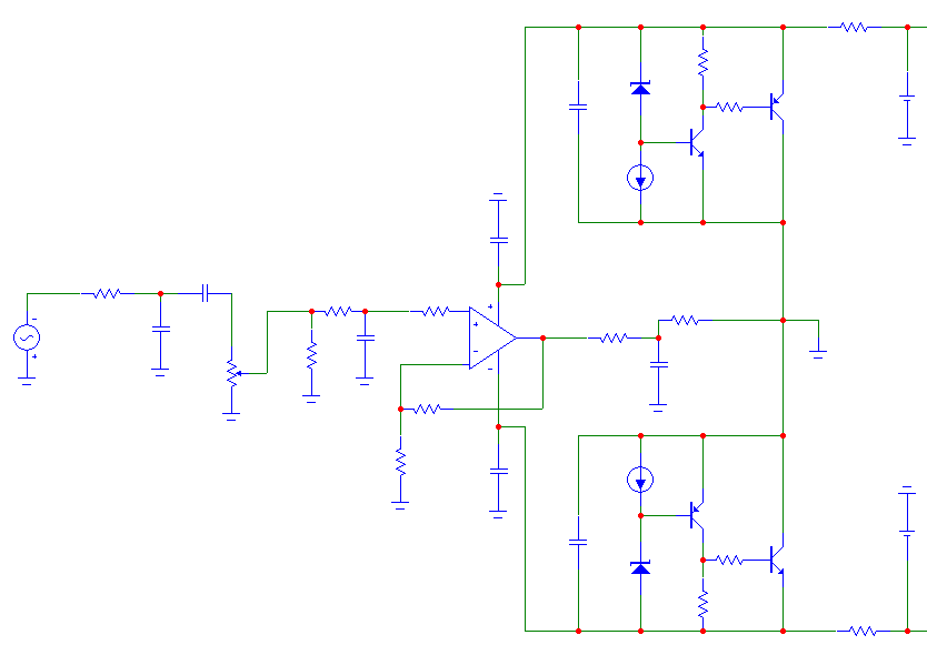

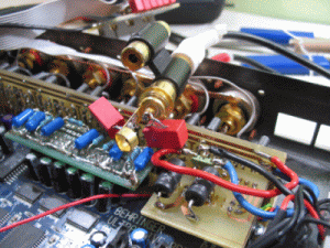

mbcouple,
I have included the principal schematic I use for opamp outputs. As you can see I have avoided using the opamp as filter. I use it only as a gain device and all the filtering is done before and after the opamp with RC filters.
I have now listened to the opamp version for two weeks (I listened the passive RC for half a year) and I do like it better than the passive version.
On technical side I have now fully working volume control right at DCX output, I have more gain (passive version did not have enough in my case), I have better load driving capability.
As for sound - the most I was bothered by the highs with passive mod. All metallic hi hats and other instruments were too sharp and tiering if listening session was long. This has improved a lot. I can now even turn the level up 1dB on my Millennium tweeter without getting the same disturbing feeling.
Overall I really believe I have achieved to keep all the good that came with the passive mod.

Ergo,
Does the second resistor in the "T" on the op-amp output represent your load resistance?
Davey.
Davey.
Davey,
Yes. I have 100 ohm in series with output and cap to ground and the other resistor is a 10k load.
I will evaluate and listen to the DCX for a few more weeks and if all works stable and I'm still happy with the sound I will post the schematic with values and all.
Ergo
Ergo
