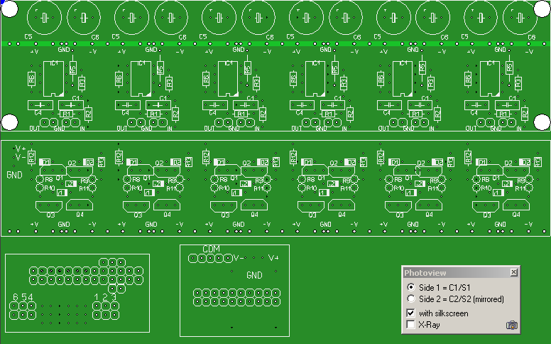

My Dcx2496 mods compared and compiled from The Yahoogroup
I have tried many different circuits to improve the sound of the 2496 Behringers. They all use the excellent AKM AK4393 dac chip which is unique in having a true balanced VOLTAGE output with enough power to drive through a passive stepped attenuator direct to the power amp. This direct out, capacitor coupled with film and foil caps, first order analog low pass filter, gives an incredible see through sound with the blackest of background. after trying many different output schemes I have settled on this one for it's sound quality and simplicity. All my evaluations were done on my DCX2496 which has a ribbon cable that allows access to the output of the dacs. During the course of my evaluations I have tried the following:
1. Bypassing the 47uf electrolytic interstage coupling cap with a .1uf Dayton film and foil cap. This simple mod made a nice improvement.
2. Behringer runs a crazy servo shifting balanced output stage. Because I'm running my amps single ended right now, I took the signal out before these stages for another small improvement.
3. I implimented a custom analog output board with LT1360 opamps running as a differential amp and lots of bypassed filter caps. This was a huge improvement and nearly equaled the direct out scheme for sound but is obviously more expensive and complicated.
4. I tried multi-tapped Sowter transformers. These were easy to install, gave me volume control inside the unit and had an beautiful, liquid sound but were a bit euphonic and didn't match the fine resolution of the direct output. And they were obviously much more expensive.
I have some .01uf Dayton foil caps so I can try so I can try easing the load through the filter with 360 ohms but interestingly, the sound is better with the first order filter running through 36 ohms than with no filter.

Op-Amp output
You should also look at M-Audio SuperDAC output stage, (same DAC chip).
Sounds great, and is very similar to the DAC-appnote.
(schematics are found on http://groups.yahoo.com/group/M-Audio_SuperDAC_2496/
Arne K
