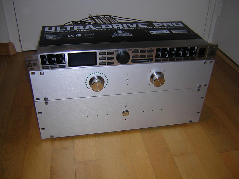

hi guys,
just finished my amplification!
6 channel remote controlled volume control behind the DCX, using 150 reed relays.
6 mono channels of UCD180AD / supply ST / 160VA transformer
sound is a great!
regards, Peter
