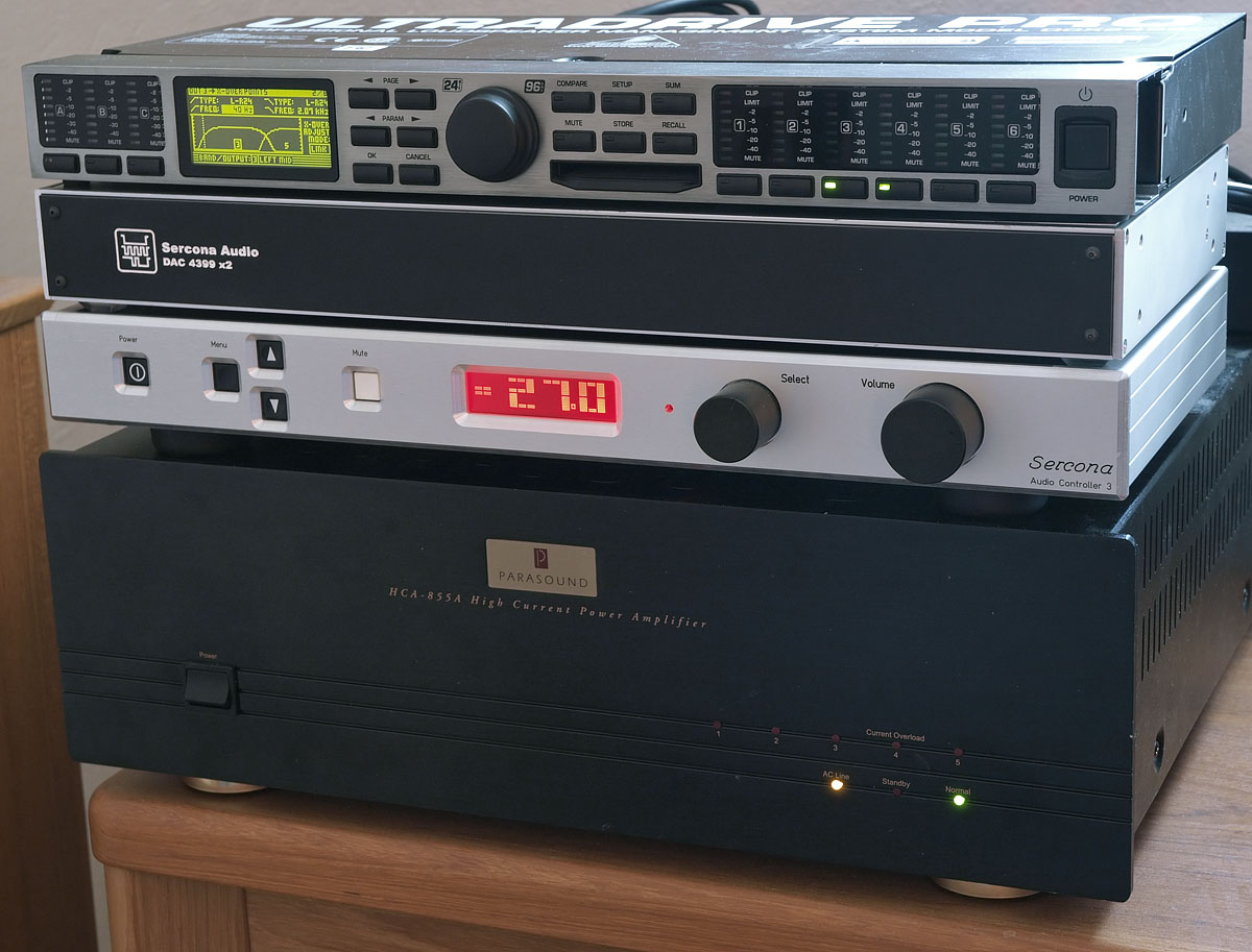

here's a photo of my current dcx setup. I'm still using the wolfson spdif-out DIY board and I'm going into 2 AK4399 ebay dacs. those feed into the parasound multichannel amp, then onto 'zaph audio' L18 spkrs in fully active XO mode. the silver box with the lcd display is my cs3318 vol control 1U chassis and it is the middle-man between the AK dacs and the parasound amp.
next phase is to proto one AK spdif tx chip, get some experience with it and, hopefully, make a board that contains 3 of them.
Nice setup man! 😀
