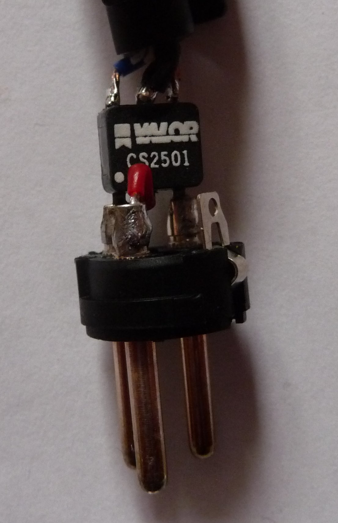

I had a grounding issue (hum, rather than dropouts) with long SPDIF/AES cable from SRC2496 to DCX.
Solved with tiny pulse transformer pulled from an old network card.
It even fits in the XLR plug 🙂
Hope this is useful to someone,
AP

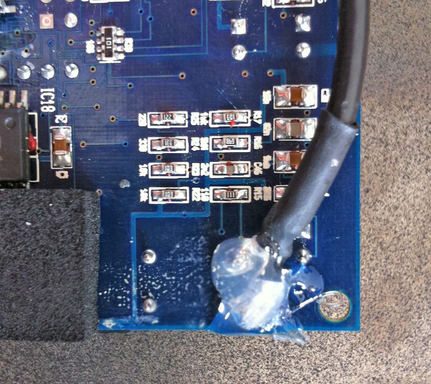

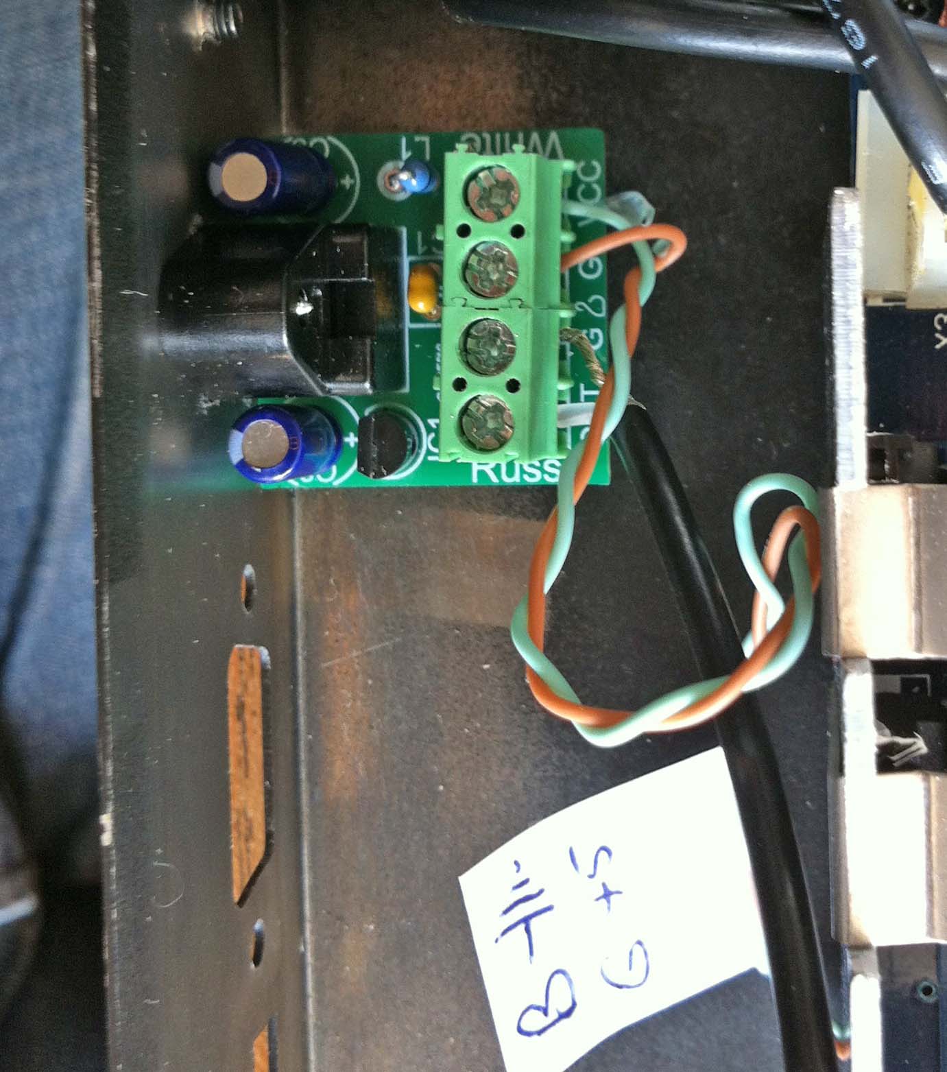

Twisted Pear Toslink input installed
The twisted pear solutions works very well and is easy to build / instal.
Stole the +5V / GND directly from the output pins of the power supply.
I have not changed the resistor value at the input transformer. What advantage would this bring?

The Murata and maybe the cs2501 appear to be 6pin devices.
Are the middle pins for a centre tap?
Do all pulse transformers come in 6pin format?
Hi Andrew,
Sy's link shows 4/6 pin, but not CT.
IIRC I never found a cs2501 datasheet, only for similar parts (some CT).
It seemed logical that NICs would use them (imagine office building ground loopiness otherwise); and if OK for 10mb/s ethernet, SPDIF should be a cinch. So I went rummaging, and found something that measured equal R from centre to side pins, open circuit from one edge to the other, and looked rather like the 4-pin one in my tube Dac ("pulse transformer" on Sheldon Stokes' BOM).
In it went. I was delighted when it worked!
Best,
AP
PS, My first and only use of 'looks like' for component selection, honest 😉
