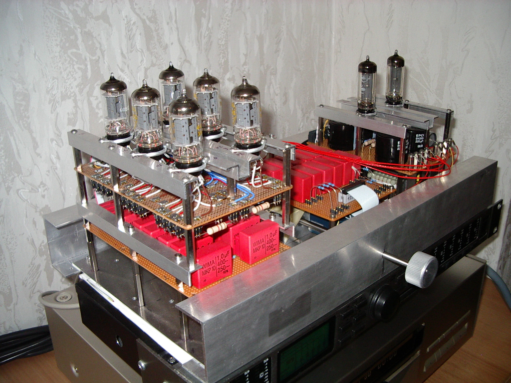

Hi Steve,
it is an full ballanced outputstage with volumecontrol for the DCX. It has 12 separat "preamplines" for all 6 outputchannels.
The original Input/Output board from the DCX isn´t in use anymore. The input is via S/P-DIF - through DAC - after DAC volumecontrol - and at the end tubevalves.

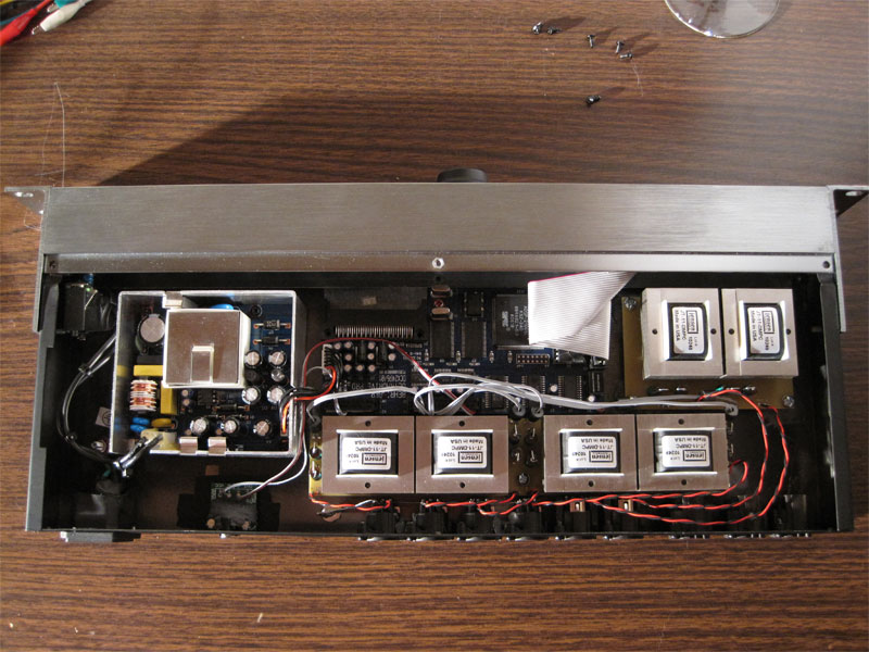

How/where to solder wires for balanced signal from DACs?
Greetings! Great thread, but WHEW is it long! I have a DCX2496 and 3 pairs of transformers, with each pair optimized for one band (bass, mid, HF). They are designed to take the balanced output straight from the DACs, output SE, and completely bypass the stock output section.
I've built some tube gear but I couldn't be any greener about sticking a soldering iron onto a board with SMDs. Would someone be so kind as to point me to the easiest point on the board to pull out the +/- LR signals straight from the DACs? I found a great photos on Lampizator's site that shows exactly this for the SRC2496, but have failed to find the same for the DCX. I read the great article by Jan Diddens, “Greening the …” (http://www.audioxpress.com/magsdirx/ax/addenda/media/didden2657.pdf) and admire how he used a new connector to tap into that header, but I ONLY want to pull out the balanced analog signal. What is the best (easiest) way to do it?
From the schematic it looks like the DAC pins are 20-23, and these match up to 13-16 (DAC 1), 17-20 (DAC 2), and 21-24 (DAC 3) on the connector. What I think would be really slick is some connector to plug between male and female connectors that is designed to permit an access point – but I’m probably dreaming.
Cut into the ribbon
I just use the individual wires of the ribbon cable which is the largest one. It's very easy to peal them apart after starting a small slit with a razor knife. Leave the pairs stuck together and twist them on the way over to the transformers. Starting from the red wire,(which is the opposite way of counting compared to the schematic) channel 6- is the third. Channel 1+ is the 14th.
Agree, your best bet is tapping into the ribbon cable. Another way of doing it, if you will house transformers in a different housing, is to cut XLR connectors from the board and than run wires from the ribbon to it. That way you send the signal through the XLR to the next stage.
Wow, you guys are great with the help! I looked again and figured y'all would say to use the 2K resistor point for each leg, on the output board. But using the ribbon cable seems better over the long haul.
So you are cutting the ribbon cable wires from the connector? Do you just cut the 12 you need and leave the rest plugged in?
Using the ribbon seems a LOT easier, though not reversible. Sometimes it's good to commit to mods... and not look back.
Yes that is exactly what you do, cut wires that you need and leave the rest intact. Leftover wires are needed since they carry input signals and control signal to the DB25 connector. If you make mistake, that ribbon cable with connectors is easy to purchase, ether assembled or in parts.
I think this is what you were interested in?
I use toslink input instead of straight SPDIF, but other than that we sound the same.
Amazingly low distortion with this setup, and fully balanced.
And I take it out of case to this, what I just redid in the new housing:
